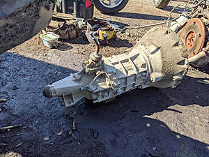

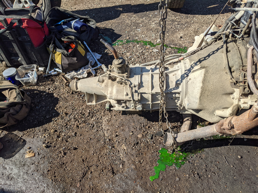

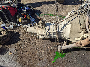

And now because everyone likes pics....
IMO this was a very gently used truck. Why it was junked...who knows, it had some body rust but for midwest it wasn't terrible. At 147k and ultra clean inside it was a mystery. Sport reg cab short bed, 3.9 MT, AC, slider, aero front and sport bumper with fogs, but no other options, full bench in cloth that was in amazing condition. I bought the hood, bumper and passenger door, the fenders both had holes. Owner had also sprung for color coordinated fiberglass tonneau cover, chrome wheels too.
