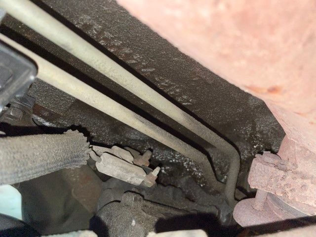

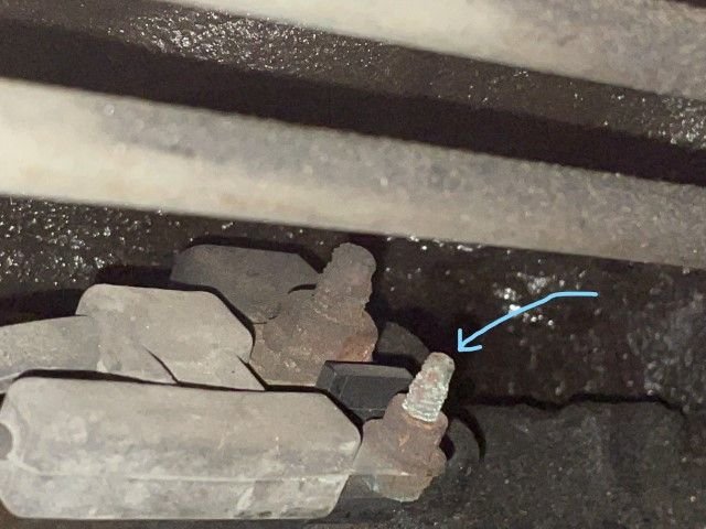

Well, that didn't go as expected.
First attempt to start truck (would not start)
Max/Min = OL/0.00v
Second attempt to start truck (it started)
Max/Min - OL/0.03v
Can only guess I was not touching that starter connection though it sure looked like I was. To tell you the truth, it's buried. I cannot reach it with my arm. I can barely see it. Needed a very long nosed pliers to grab the alligator clip to clamp it around the screw sticking up. Photos below. Arrow points to the stud I clipped on.
Old Mar 24, 2023 | 07:46 PM
Posts: 87,399
Likes: 4,214
Yep, that would be the one, and your numbers are kinda confusing indeed. But, looking at that stud, I can see how they came about. I would be REAL tempted to hit those with some chems, take 'em off, and clean 'em up real good. (disconnect the battery first. )
