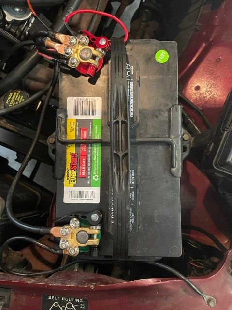

Say HY, question. Why did Dodge add that wire from the battery ground terminal to that ground point on the core support (wire runs across the bottom of the photo)?
Old Apr 4, 2023 | 06:23 PM
  #36
Posts: 87,479
Maybe provides a better ground path for some of the stuff on the front of the truck? They had some extra wire left? I am sure it serves a purpose, but, no real clue what that purpose actually is.

As for those battery terminals, I really like those clamp-style connections with the 4 bolts (and I didn't think I would). Makes for a real neat and organized battery terminal. I posted this picture a number of times but you can see what I'm talking about. However, if there is a flaw with them it's that the bolts come loose. I think I'm going to add a lockwasher to those bolts.
