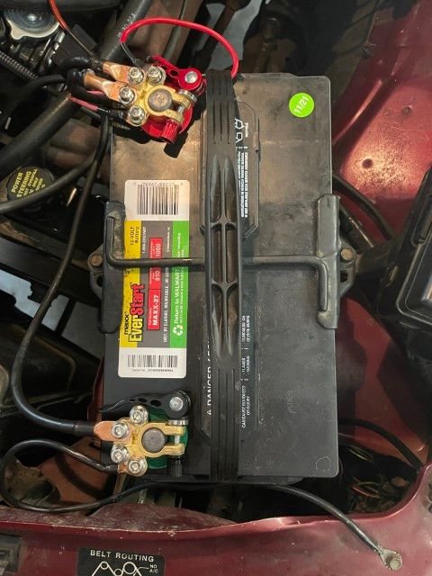

Check battery connections.

Done. Brand new terminals and some new wires.

I checked the starter relay. It clicks perfectly fine and there is 0 ohm resistance. I replaced it with a new one anyway. I checked the battery and it comes up "GOOD"..it's only 1.5 years old. The connection at the battery is cleaner than an operating room table. I get no OBD1 codes. I think I checked something else but I can't remember what. I am a little suspicious of the ignition switch that was put in 1.5 years ago. It has never felt right (the rotation amount while the engine turns over is really small compared to OEM). It's a Borg Warner ign switch so I'm assuming it's OK. So in my mind, the only thing left is the starter.
