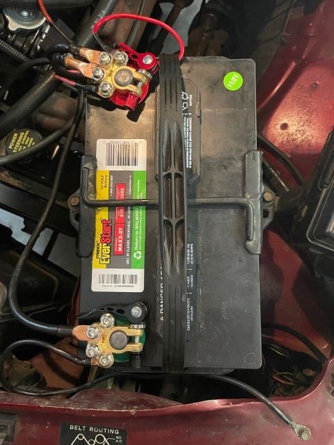

Originally Posted by bronze
TEST 3 & 4: PASS
I believe I know what my problem was. After cleaning off the starter terminals and putting everything back together I checked my battery connections one more time before shutting the hood. I noticed the main ground cable at the battery was slightly loose. It wasn't floppy loose but I could turn the lug about the bolt with some resistance. I say this because I also noticed my voltage gauge has steadied up. Prior, I was getting a bit of the shakies on the needle. Not all the time. Maybe a third of the time. Well, that's gone now. So that loose ground might have solved that problem too.
On one hand I'm kind of disgusted with myself for not seeing that ground cable. Caused me to take the time and effort to pull the starter. On the other hand, I'm not sorry I did that. I had a leaky valve cover that I repaired a year ago. Prior tho, it coated my starter with oil and sludgy crapola. The thing was a real mess. So I was able to clean it up good while I had it out. Also, while I was under the truck farting around with the starter I noticed a coolant leak from a loose hose clamp on one of the tranny coolant lines. So I cinched that up. Knew I had a leak but never found it until I was laying under the truck resting. Also, those starter connections were crusty so I'm glad I got them cleaned up too.
As for those battery terminals, I really like those clamp-style connections with the 4 bolts (and I didn't think I would). Makes for a real neat and organized battery terminal. I posted this picture a number of times but you can see what I'm talking about. However, if there is a flaw with them it's that the bolts come loose. I think I'm going to add a lockwasher to those bolts.
Some lok-tite blue wouldn't be a bad idea either.
