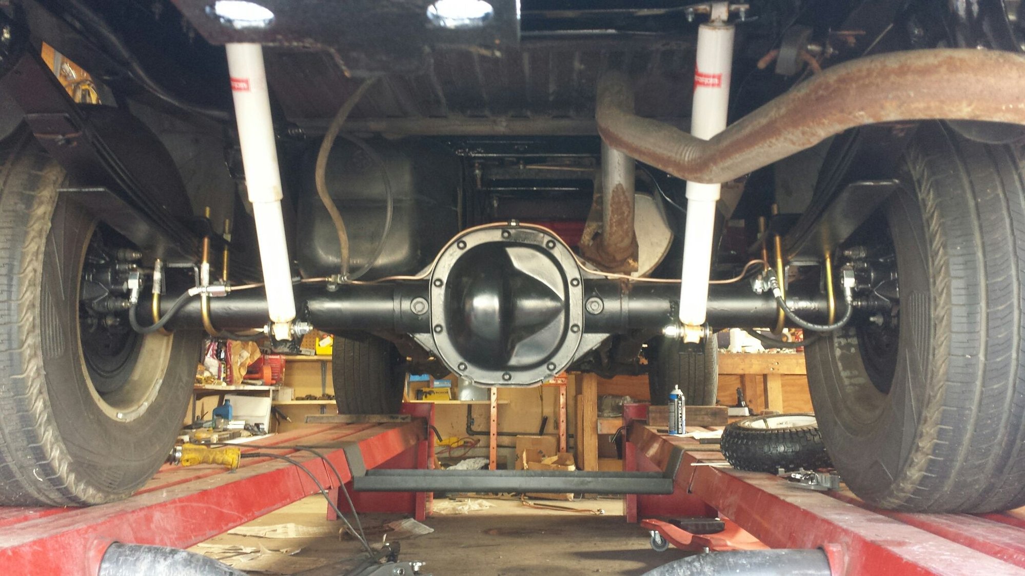

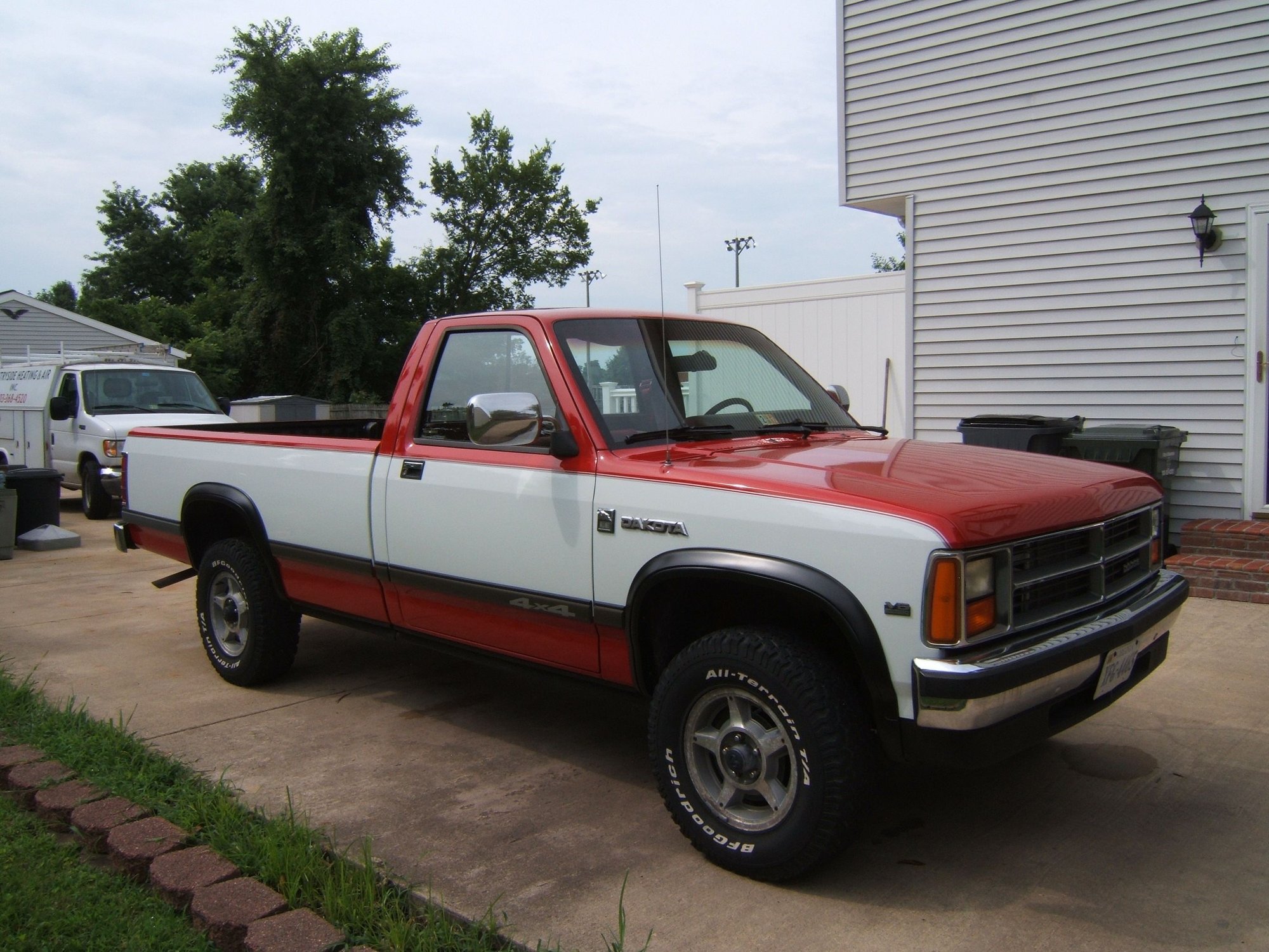

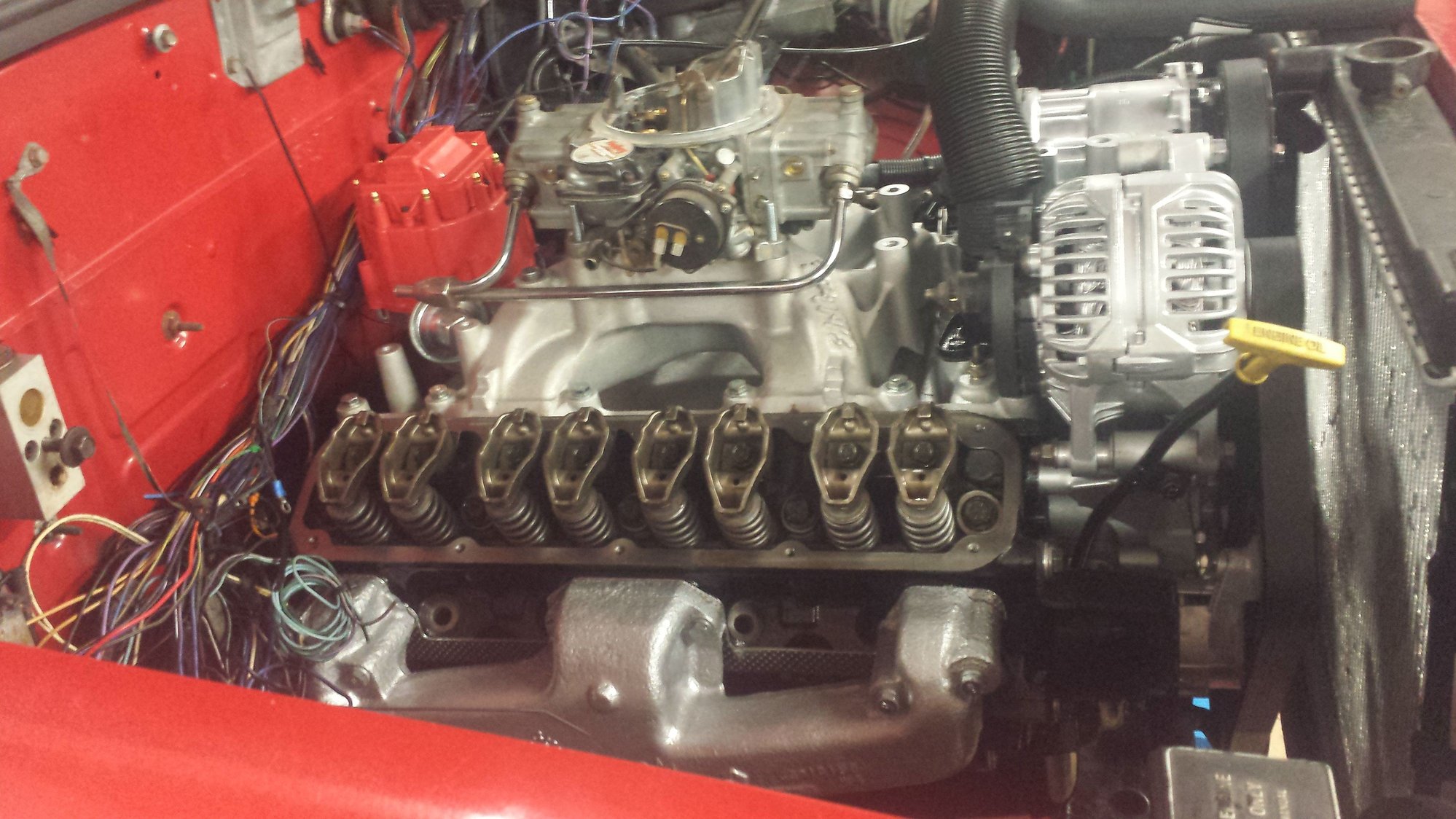

I took a 5.9 out of a 2000 ram, re-ringed the motor, etc. but its stock other then an edelbrock intake, 670 holley carb and a HEI distributor. I put a ford 8.8 rear end in it with 3.54 gears to match the front. Its no race truck, but it pulls a lot harder then the 125hp 3.9 did!!
Below are a few pictures through out the years.
That is a nice lookin' truck.
And yeah, I would imagine going from a 3.9 to a 5.9 was a MAJOR improvement.
