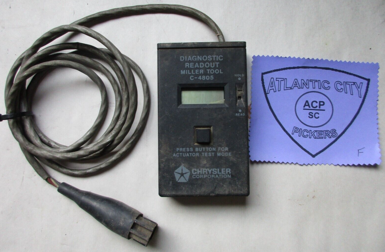

I suppose there is one why to find out: hook 12 volts up to the solenoid wires. If it clicks It is hook up correctly. Reverse polarity and if it clicks that way also, then polarity doesn't matter. As I recall the solenoid is closed in the resting position, and opens when voltage is applied. I also have the Diagnostic Readout, Miller Tool C-4805. I can use it to activate the solenoid. It's all coming back to me.
