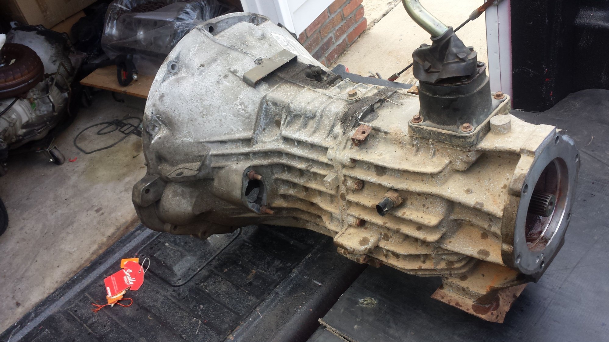

Old Jun 16, 2023 | 06:47 PM
93 ragtop's Avatar
93 ragtop
Joined: Jan 2014
Posts: 1,852
Likes: 109
From: Va
Originally Posted by Lotus_65
I found a 97 ram with a 5.2 and the 2wd NV3500 for a thousand.
Seller is convinced I can just swap the tail housing and it'll make up to my transfer case. I'll have to make mounts and bits for it of course...
True story?
No. the NV3500 does not have a tailshaft that can be removed. Also, the ram has a different shifter location. It moves the shifter further under the dash.
Below are pictures from ebay
2 wd NV3500
https://www.ebay.com/itm/13458444701...-53481-19255-0
and here is one for 4wd. This is the one I used in my truck.
