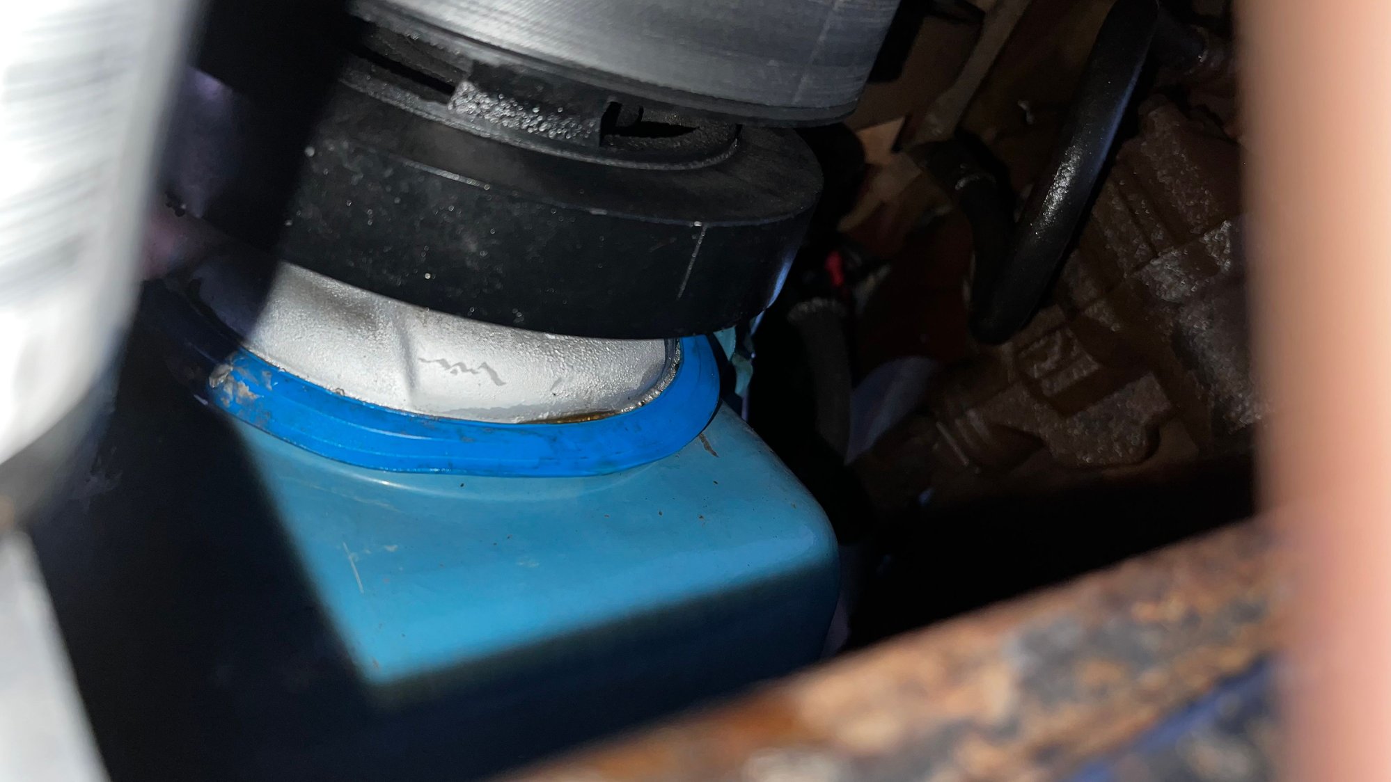

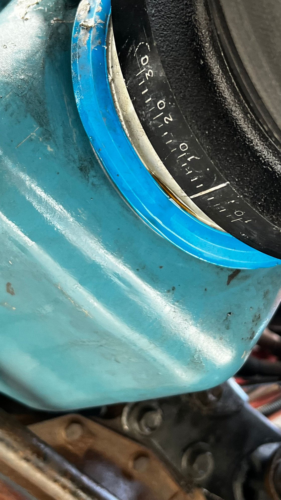

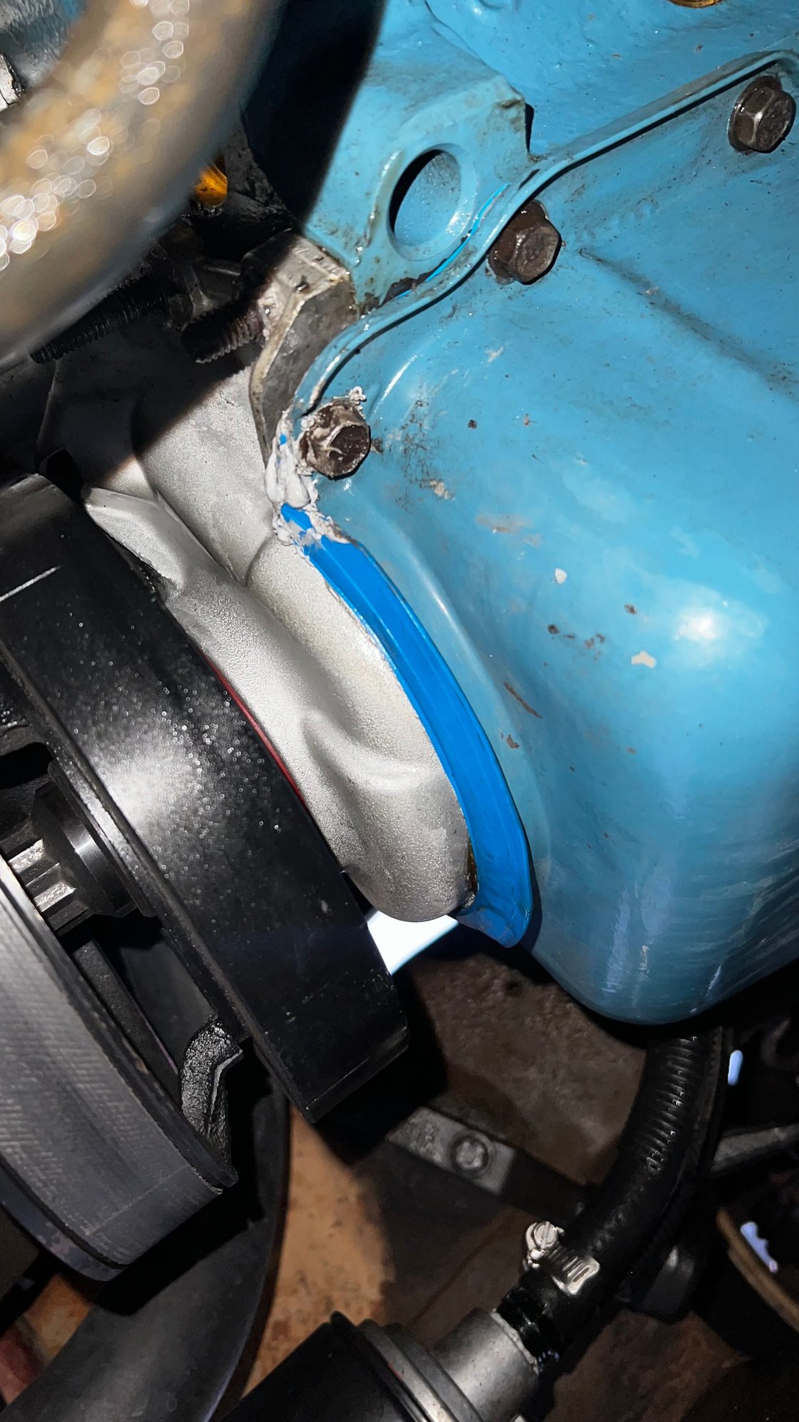

So just got back from driving around a couple of miles. PCV valve was replaced and it’s no longer squealing, but oils still leaking. I think these pictures make it pretty clear it’s leaking between the timing cover and the pan. It was actively dripping while I was taking these pictures as well.

I believe that gasket is re-usable.... drop the pan, a bit of RTV in the problem area, bolt it back up, let it sit for 30 minutes, then fill with oil.
Should I just rtv the bottom of the timing cover? Like a bead bolt to bolt from one side to the other
I don't think you need to touch the timing cover itself. Could put some RTV on both sides of the gasket there.... Sure wouldn't hurt.
Yeah I noticed my mechanic put rtv somewhere but I can’t really tell where. I think I may wait until he gets back to me before I poke at it, maybe he’ll do it for me lol

Posts: 87,479
Well, if he installed it, and it leaks.... That's on him.
