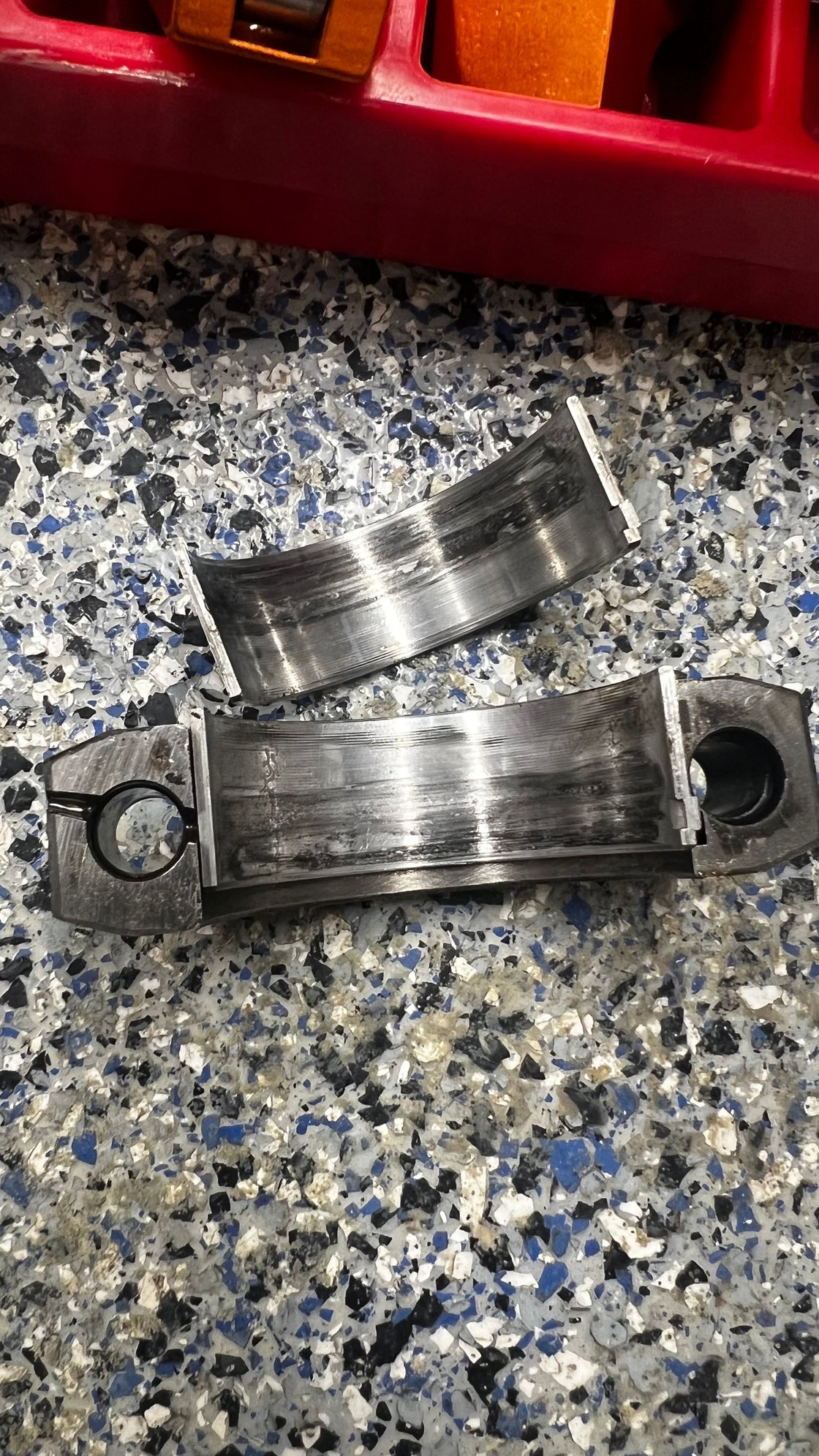

For those still following this thread lol, I am in the process of reassembling the engine. Rod number 6 was the one that spun, luckily it did not wipe out the crank it only took out the bearing.
I got the block cleaned, deglazed, and the crank polished. Machine shop measured all 8 rods and found that rod 6 was .0015” smaller than the other 7 (it was also a reman rod). Got that fixed, I’m happy with the new clearances, and I’m getting ready to put this engine back into the truck now.

Here’s the carnage if anyone is curious.
Did it actually spin? The tabs look good. I had one spin and it had no tabs at all.
I don’t think it actually spun, it seized up. The guys at the machine shop measured everything and all of the rods were in spec other than rod 6 (the culprit), it was .0015” undersized I believe he said.
The bearing though shrunk? It wouldn’t clip in at all to the rod or the cap, it would just fall off.
