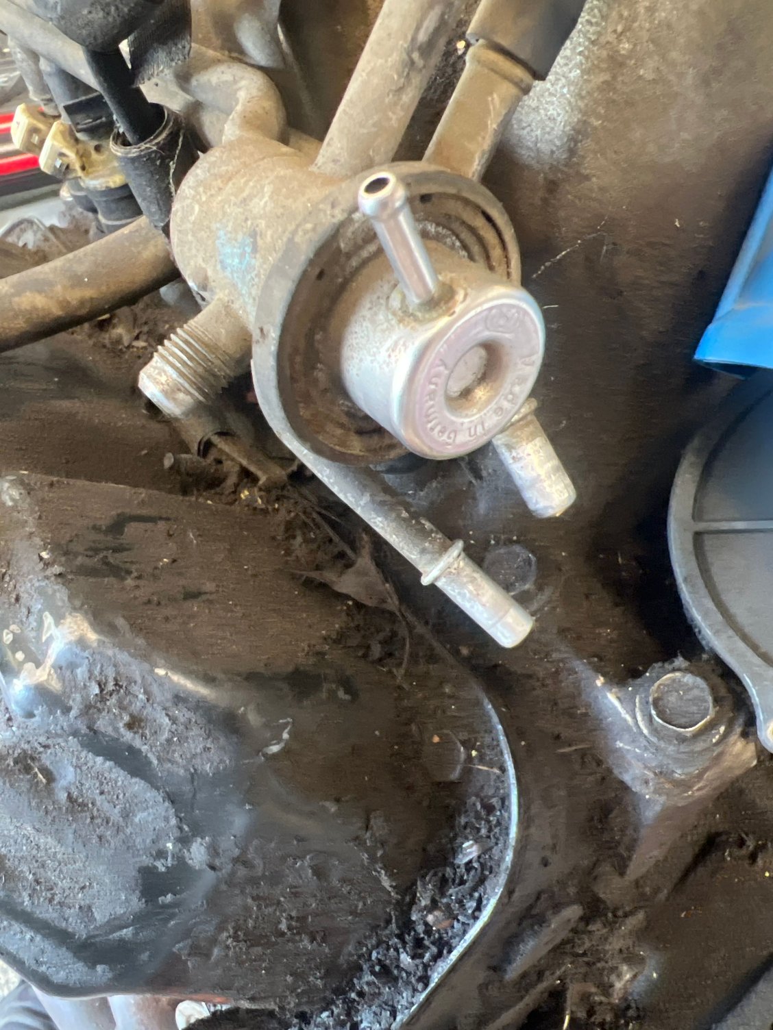

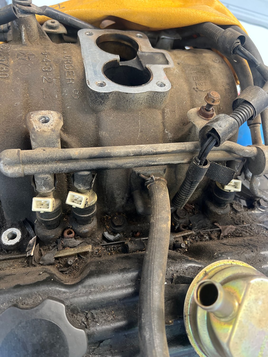

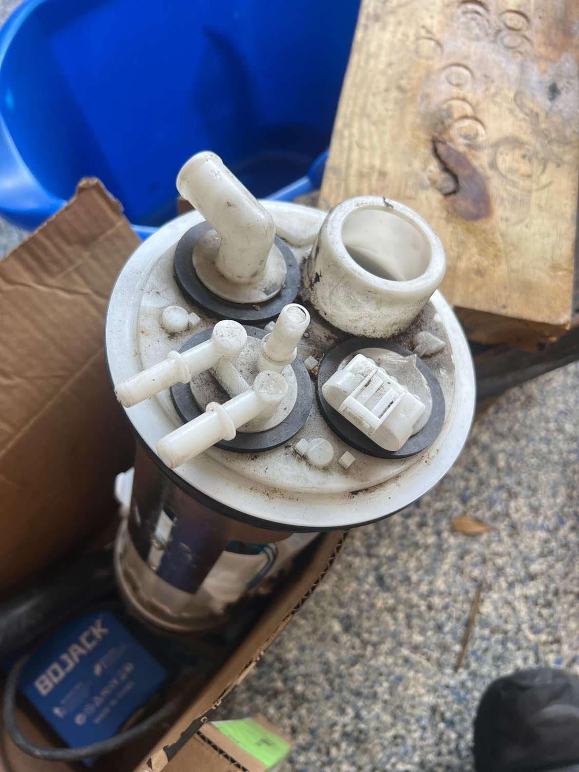

Ill put in some photos here as well, but if I need the module with a return, but I have a module with a return from the 92, why would it have a return, be externally regulated, but be MPI?
92 pump originally on the truck
External regulator with return line
MPFI fuel rail
Old Jul 28, 2024 | 03:54 PM
  #206
Posts: 87,479
Wow. I have never seen one of those..... The pump likely pushes 40 psi or so.... Would need a pretty serious regulator to dial that down to carb levels.
