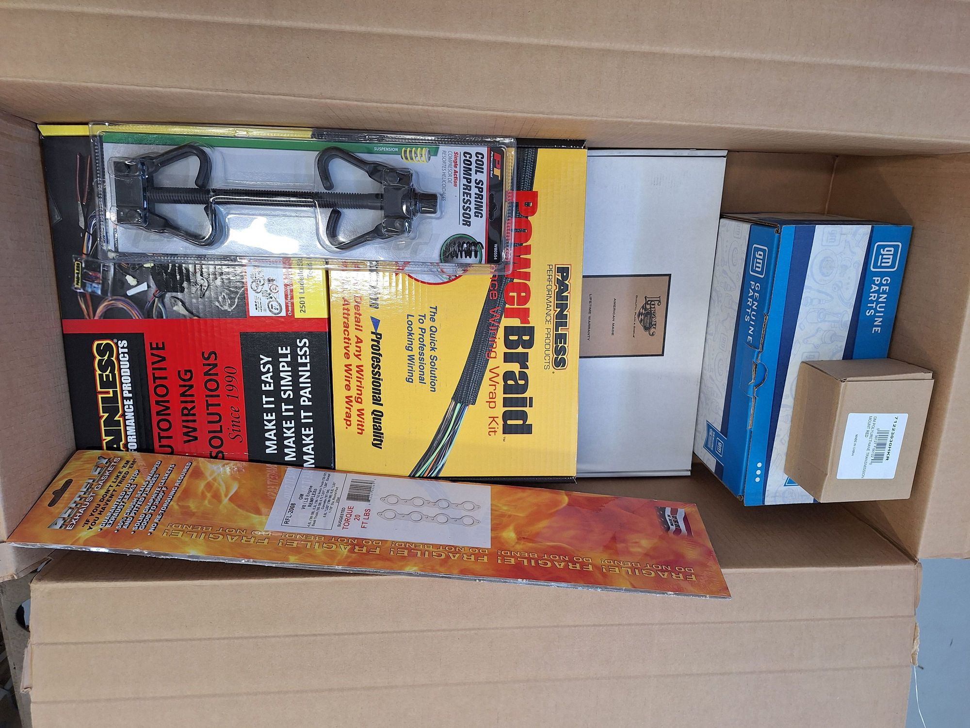

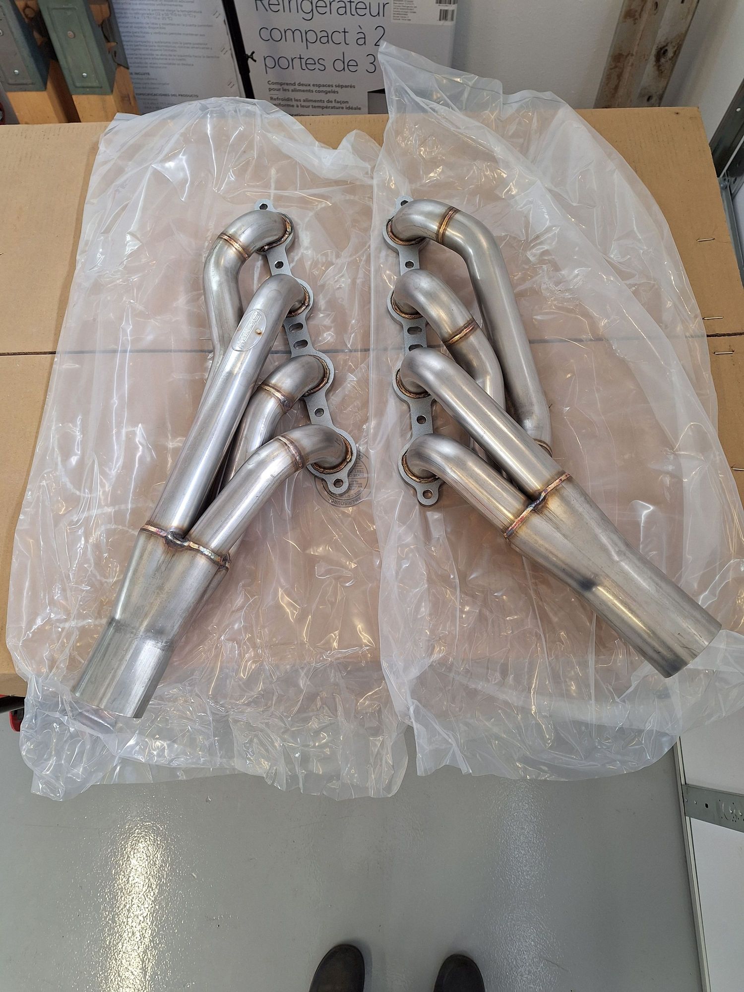

The goodies are rolling in, almost daily for the last week. I got my new oil pan to clear the Dakota cross member, the new dip stick and tube, the starter, Speed Engineering headers, Remflex exhaust gaskets, transmission dip stick, Painless Performance chassis wiring harness, wiring sleeving, internal coil spring compressor. I have a set of '90 Dakota front rotors on the way (5 lug), along with the BellTech 2" lowering front springs and shocks. In order to get back to where I was with this project, I still need to purchase a Ford 8.8" lsd rear end ('98 Explorer), the entire fuel system, the transmission yoke, and the rear parallel four link suspension and panhard bar.
The headers are mid tube, 1-7/8" primaries, 3" collectors. Stainless steel. They fit really well, after cutting a lug off the side of the bell housing. I am hoping to have the front clip, fenders, and cab off the chassis inside of the next week. I can use my airlines now, they just slowly bleed off pressure untill I get all the leaks repaired. Once the cab is off, and the drivetrain is removed, I will schedule the mobile sand blaster to come over and blast the entire chassis clean.

I love the remflex gaskets. Torque 'em once, and that's it. They never leak. The last set of gaskets outlasted the headers.

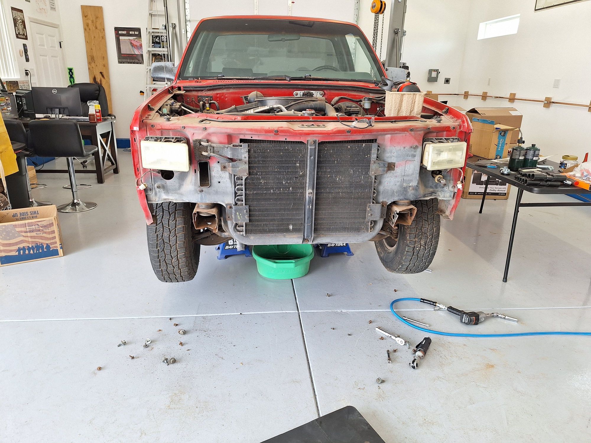

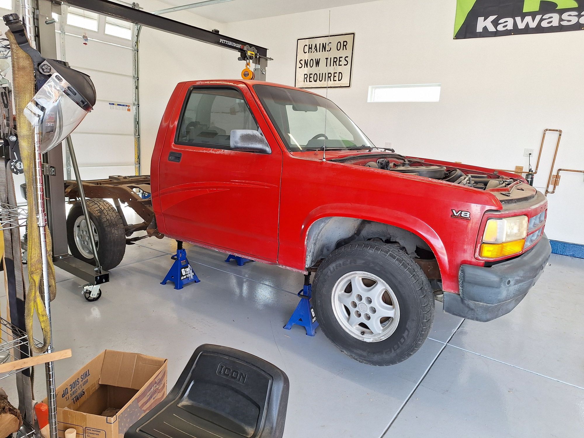

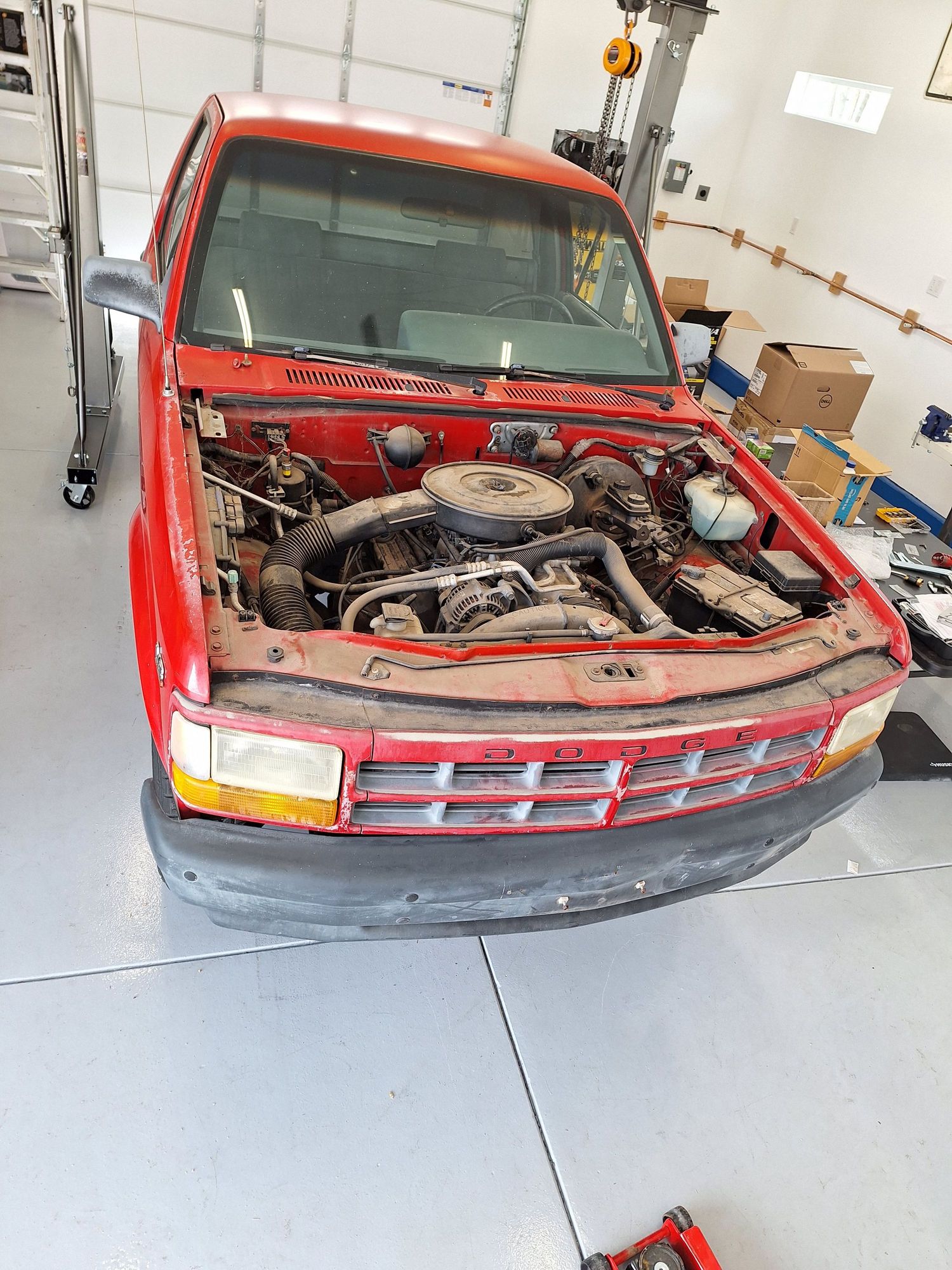

Working my way towards the firewall.

  #378
Posts: 87,475
You have that nice gantry crane, why not take the whole front clip in one piece??
Old Apr 6, 2025 | 08:58 PM
  #379
TheSneeze's Avatar
TheSneeze
Joined: Oct 2022
Posts: 668
Likes: 113

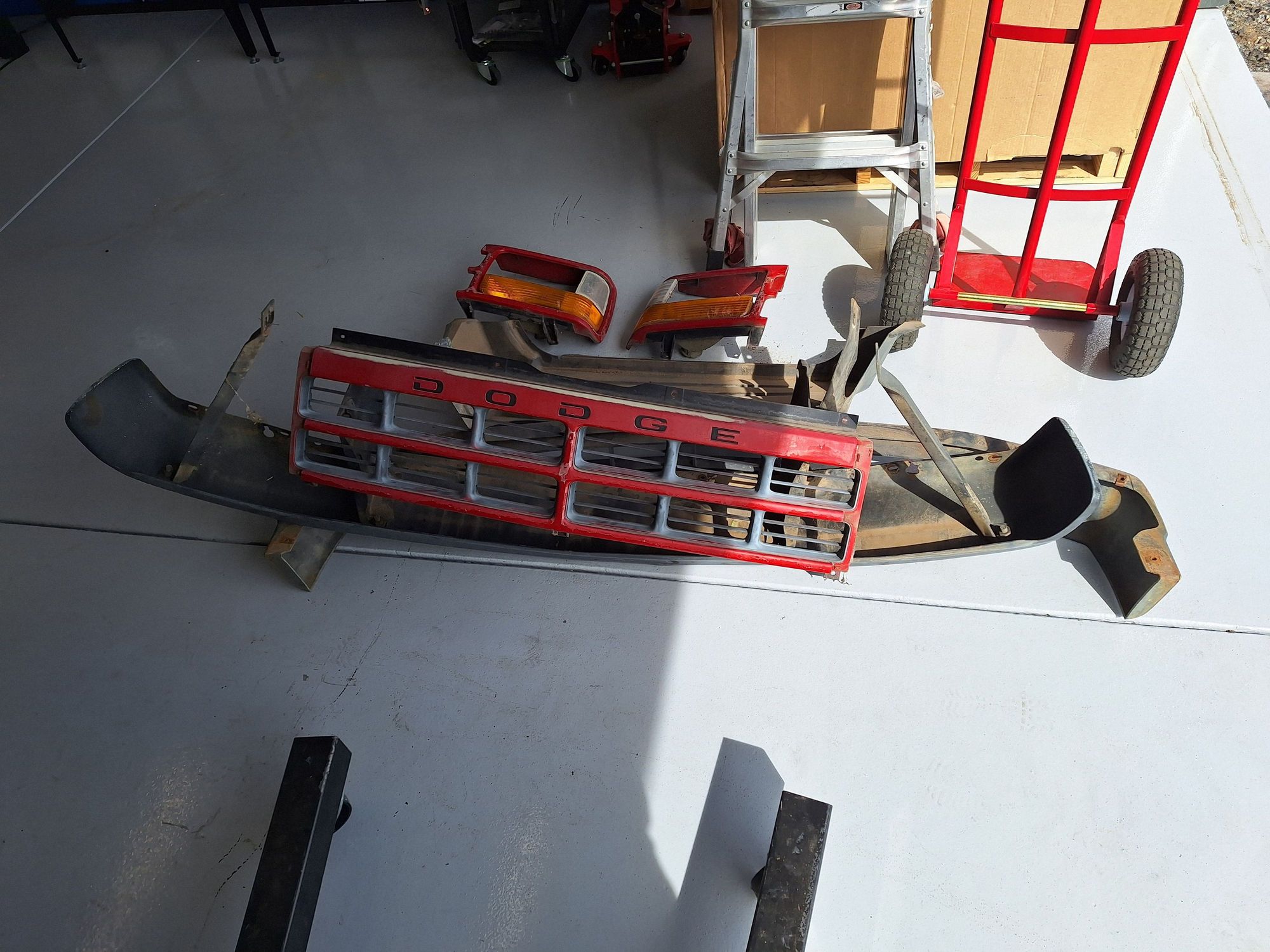

I have done this once already. In order to get the entire body on my trailer, including the engine and trans, the fenders and core support need to go in the bed. There is usually a method to my madness. But not always!
Yeah, I suppose in pieces, it takes up significantly less space.
The parts appear to be in pretty good shape though, might be able to just run an ad somewhere, and someone will show up on your doorstep to make it go away. Plus, put some money in your pocket.
