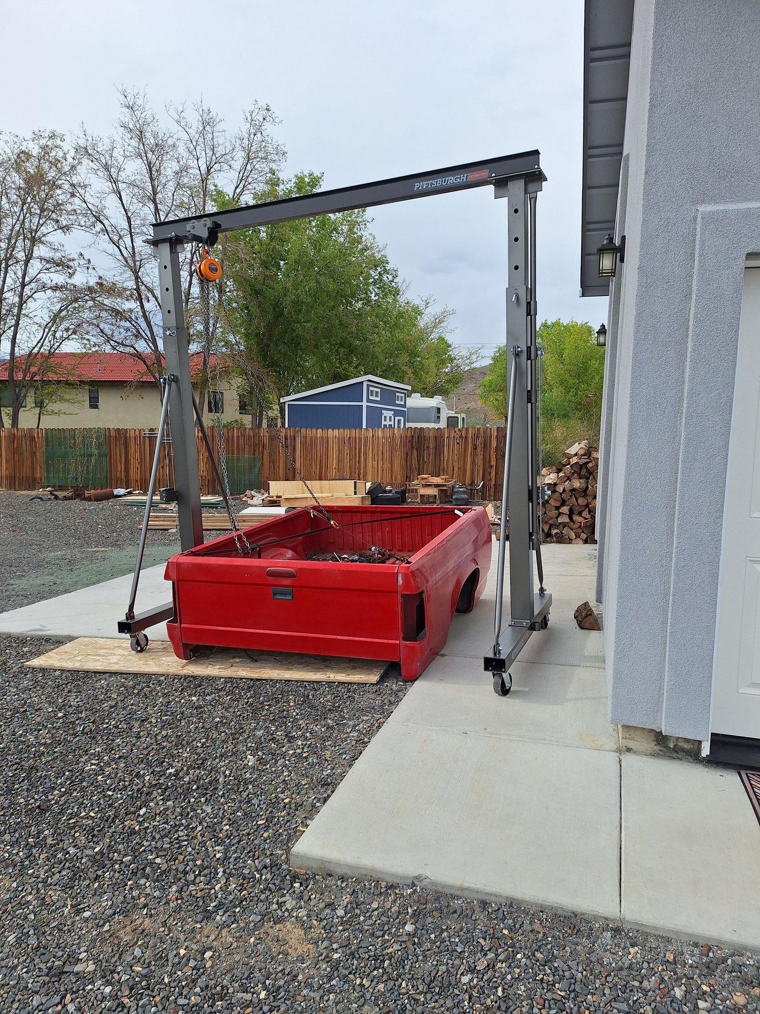

Today I sold the bed off the Dakota. The guy is coming tomorrow afternoon to pick it up. Yesterday I sold the engine and trans. I still have the cab, one fender, both inner fenders, the radiator, and some other small parts.
The bed is ready to crane onto his trailer tomorrow.

The cab still looks to be in rather good shape..... But, that would also imply that's fairly normal where you are?? Around here, you could sell that in a heartbeat.

I bought the truck in Manteca, CA. It is rust free, and in very good shape. The floor on the bed is in amazing shape for it's age. Virtually no denting in the bed floor at all. The front wall took a cargo hit and got tweaked, but repairable. On the ad I placed for the engine and 5 speed manual trans, I got 564 clicks. I had 7 guys trying for it. Me thinks I could have gotten more, but never having seen either operate, I sleep with a clear conscious. I was fully up front that I bought it non-running. I guess the 5 speed non 4wd transmissions are sought after. I am just happy most of it is out of my shop!

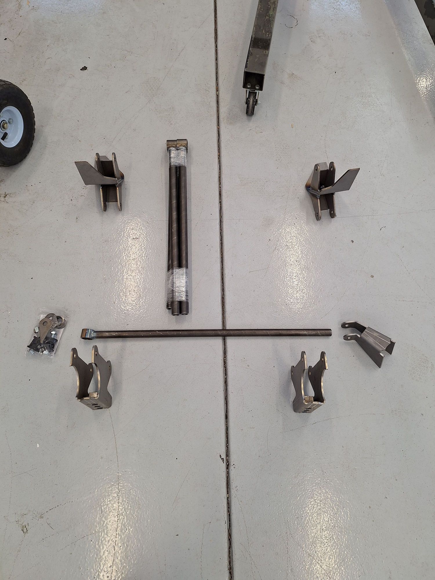

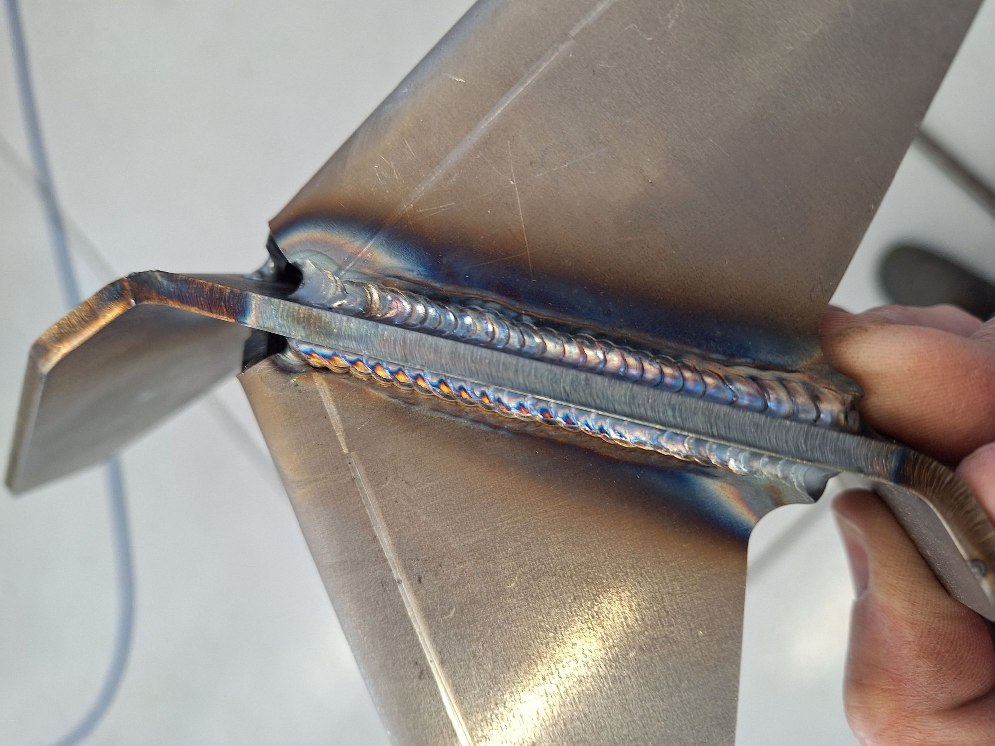

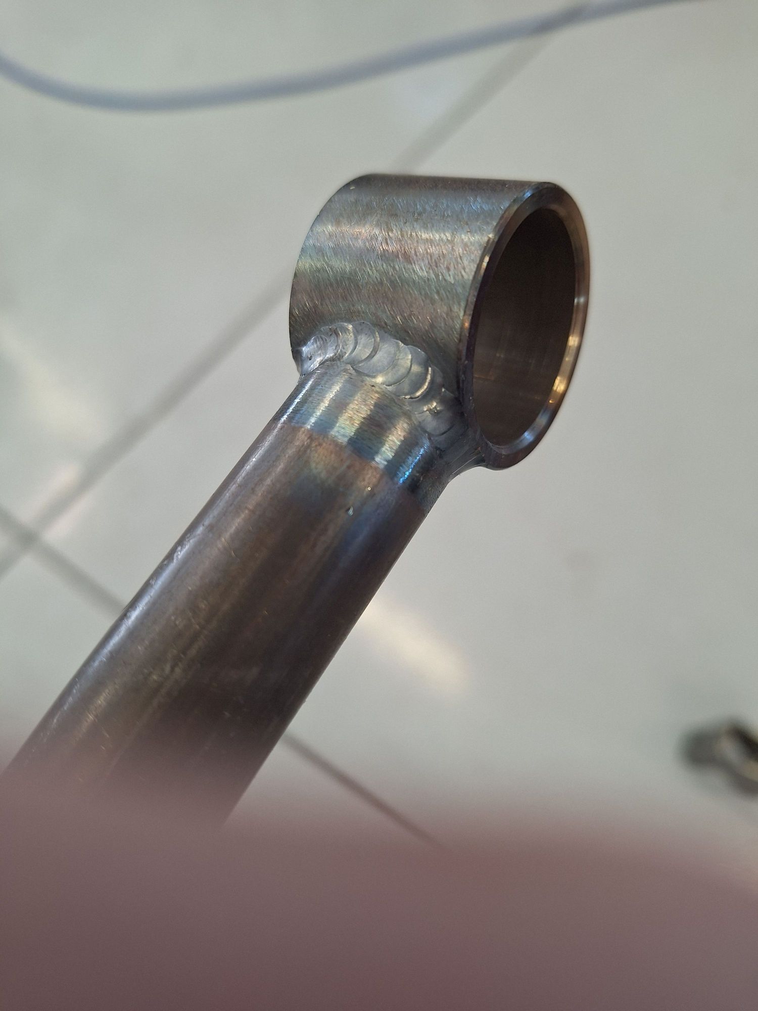

I just received the parallel four link rear suspension kit, and panhard bar kit. Everything is TIG welded, and really well! After running a metal fab shop for 22 years, and certifying 4 out 5 welders for aerospace welding, I can tell the supplier of the kits know their welding.

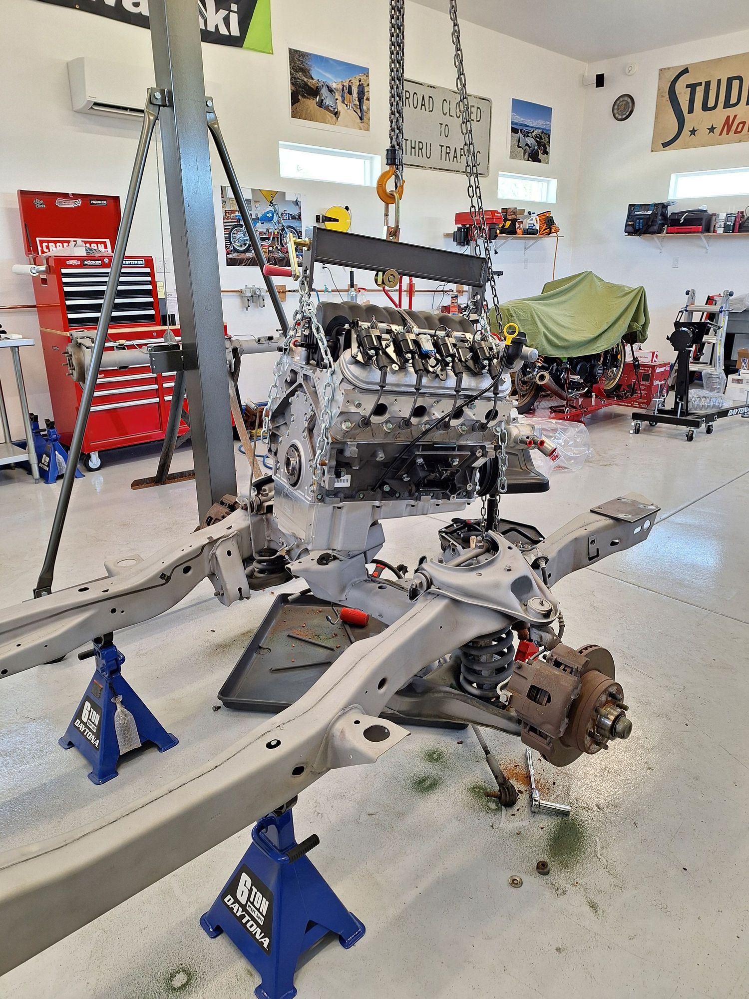

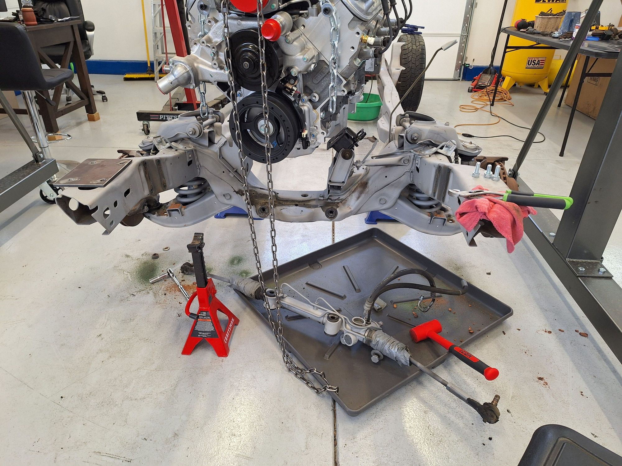

I got back from my trip back east, and I am done riding on airliners for a while. I removed the rack and pinion steering, and the sway bar, to get the rubber and seals replaced. I also need to wire wheel the frame clean underneath it. I am starting the tear down of the front suspension. The frame, ahead of where the boxing plates get welded, suspension arms, and r & p will all get painted with the chassis saver paint. The suspension is getting all new bushings, cv's, seals, springs, and shocks. I also started to make the motor mount adapter plates. After the first fitting, I will need to remake the driver's side plate. The material should be here tomorrow. Once the motor mounts are completed, I will mate the transmission and get the assembled drivetrain mounted to the cross member and get the pinion angle set. It's good to be home, and back in my happy place!

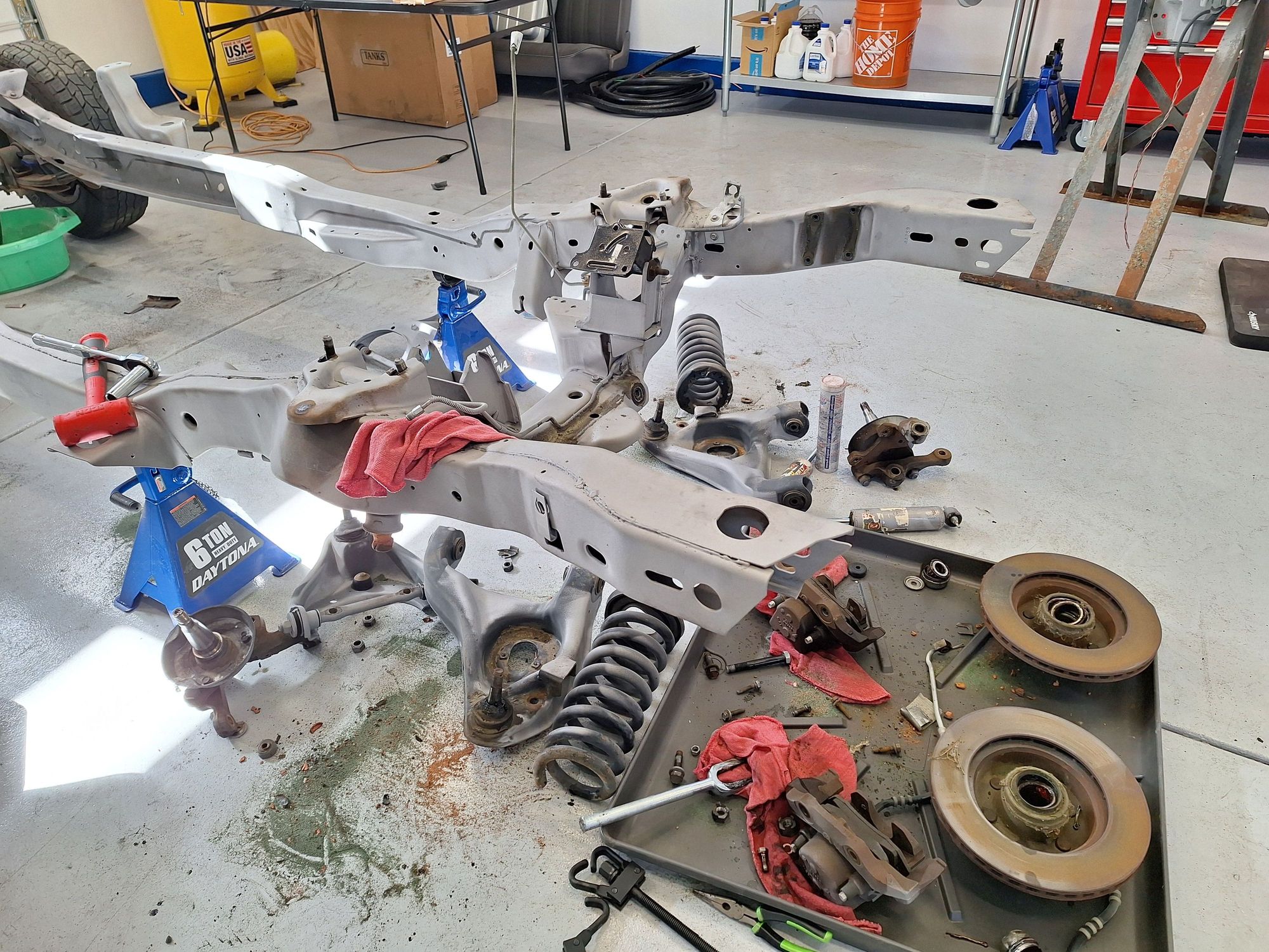

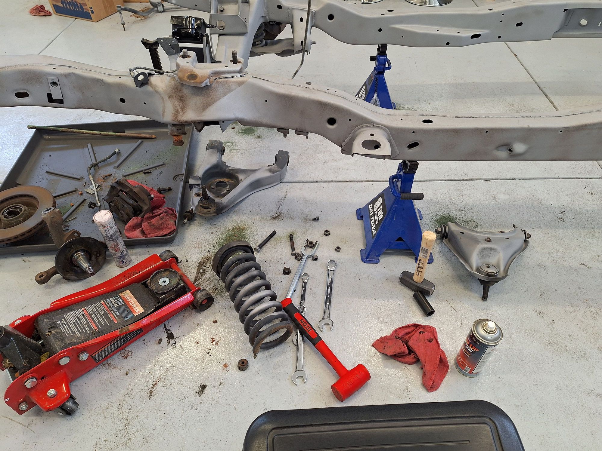

There is a first time for everything. Today was my first time disassembling a coil spring front suspension. With the right tools, it's not too bad. I did have to run out for a new pickle fork. Then I had to modify it to work as the ears were too long. The internal spring compressor worked like a charm. Avoided all the drama that comes with those pent up pieces of pending death. The opposite side went much quicker. Slowly getting closer to painting the front half of the chassis.
