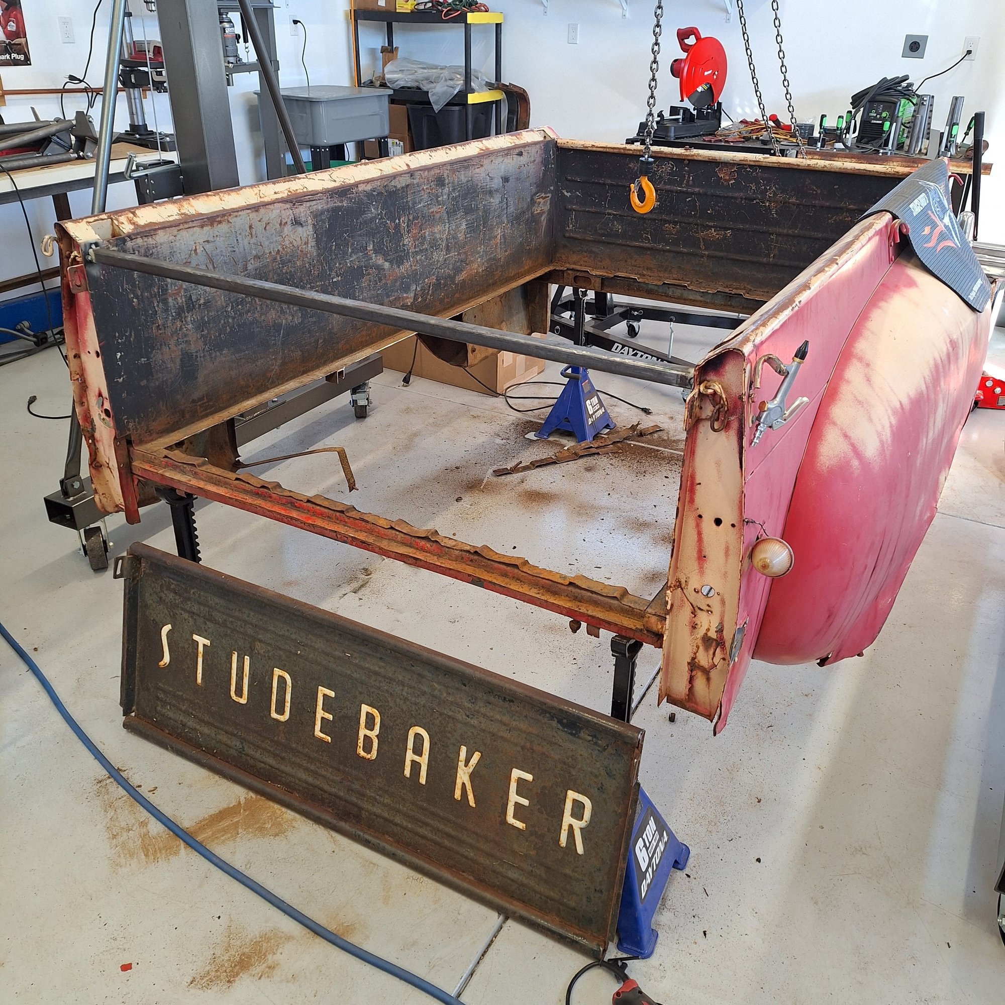

I cut and welded a temporary tube to brace the rear of the fenders. I also tried my hand at using a sheet metal hammer. I was able to straighten and weld prep the bent corners of the new (to me) tail gate.

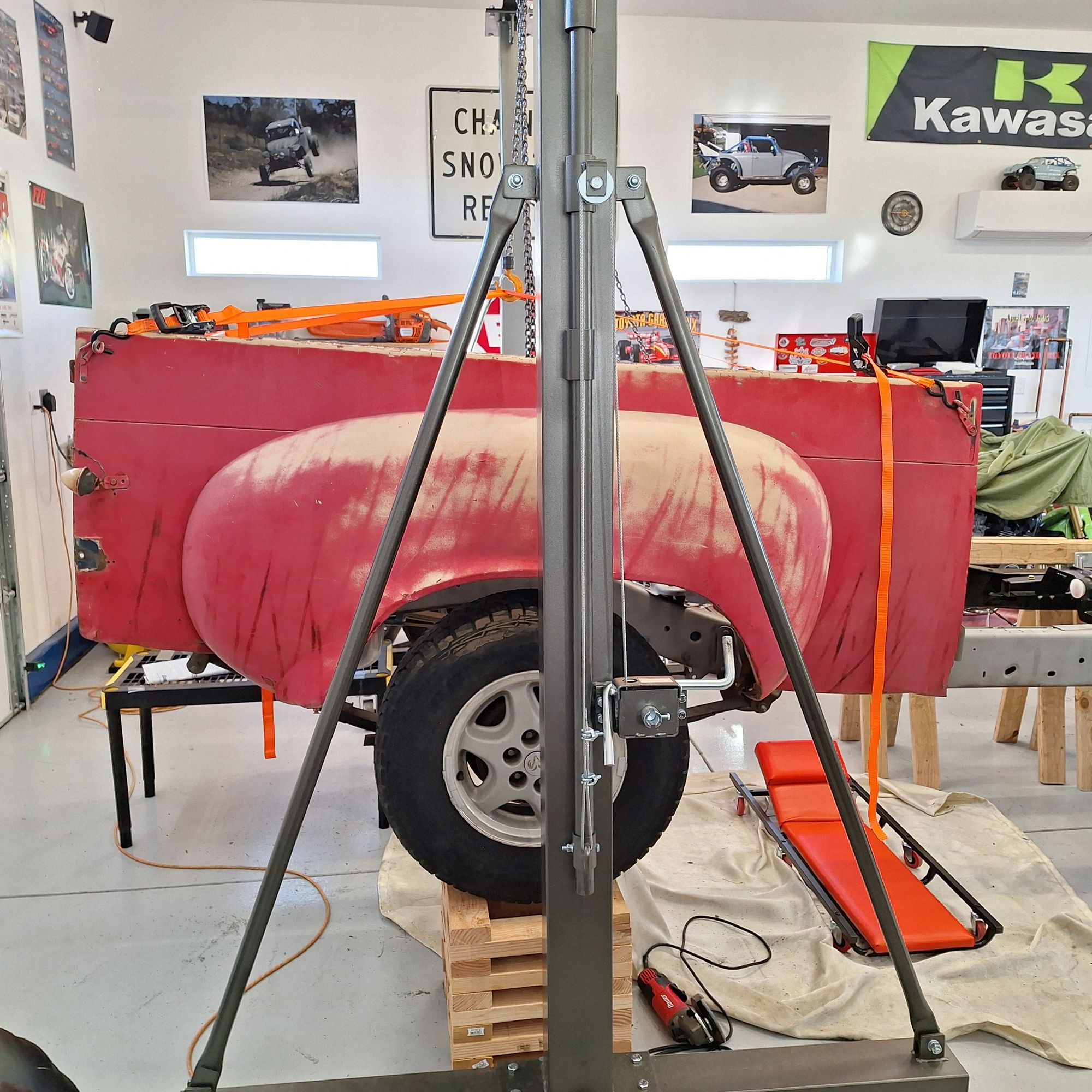

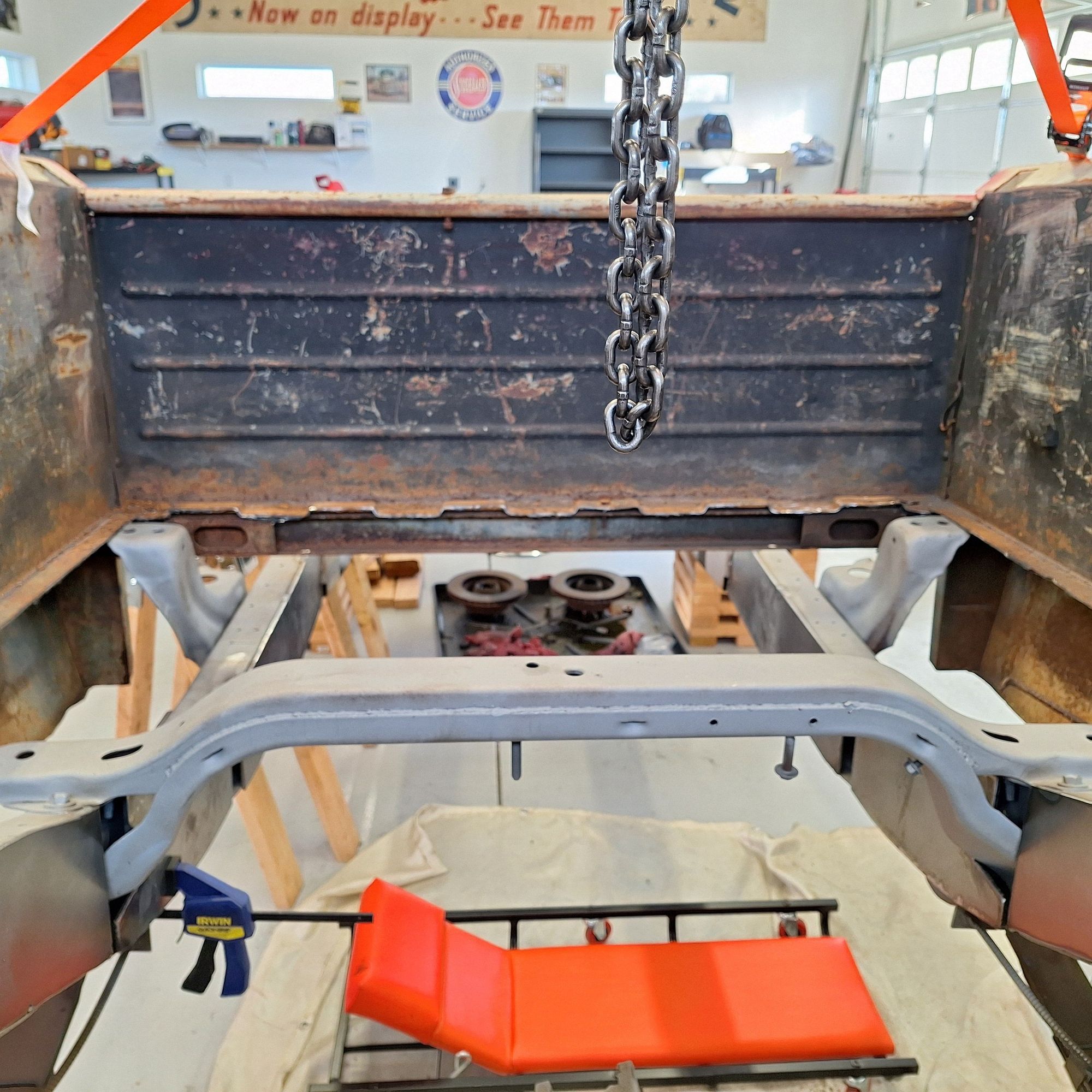

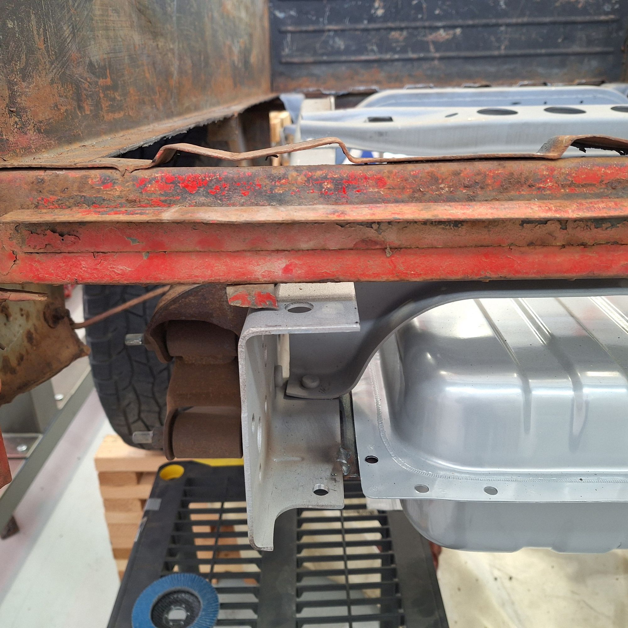

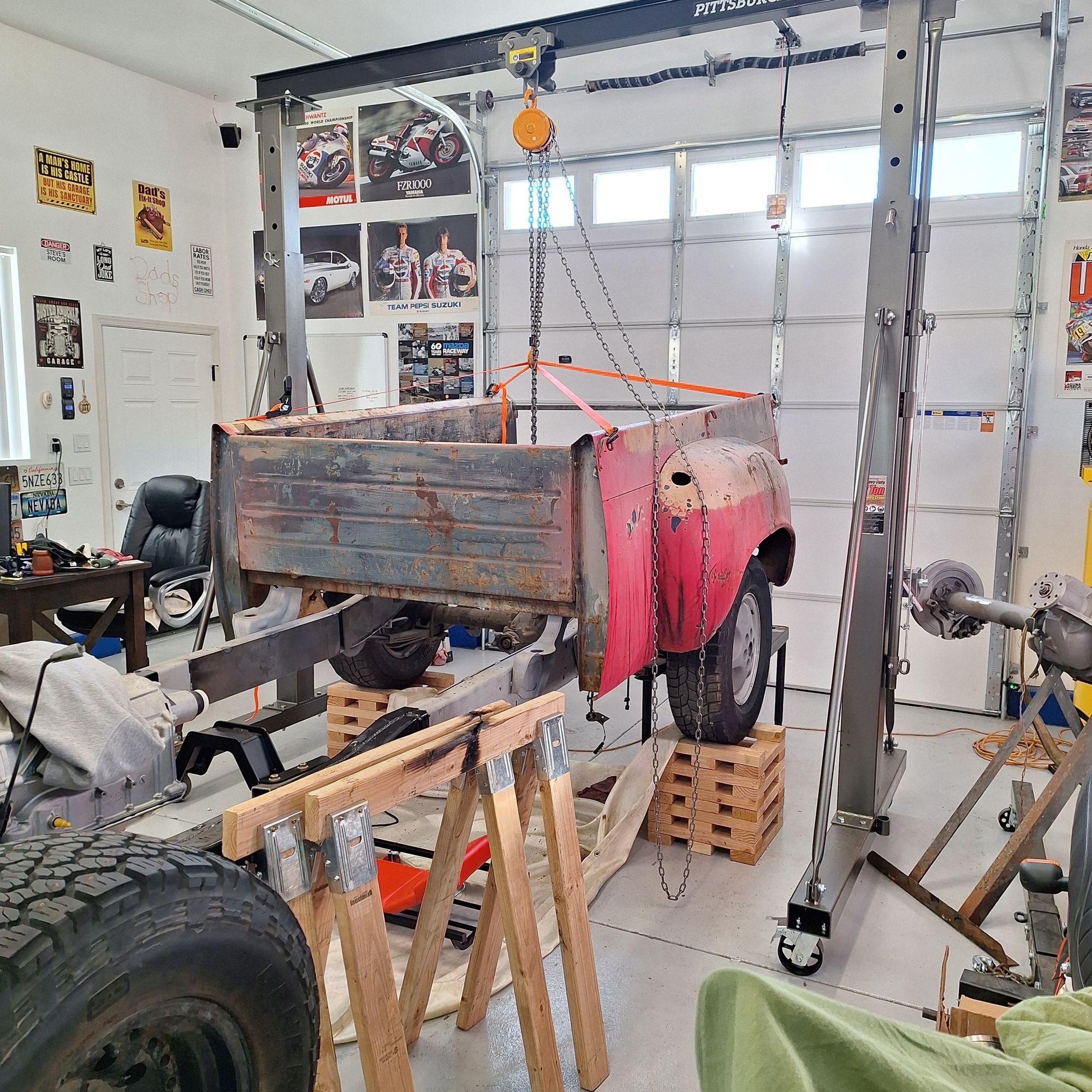

Just a test fit of the bed on the Dakota chassis. I am taking a lot of measurements, and looking what needs to be removed/added to make the bed mounts.

The top rear corners of the chassis will end up being notched, lowering the back of the bed 2 - 3". The large front Dakota brackets supporting the front of the bed will need to come off. Partially or completely is yet to be seen. This fitting was to determine what is in the way to get the bed a lot lower.

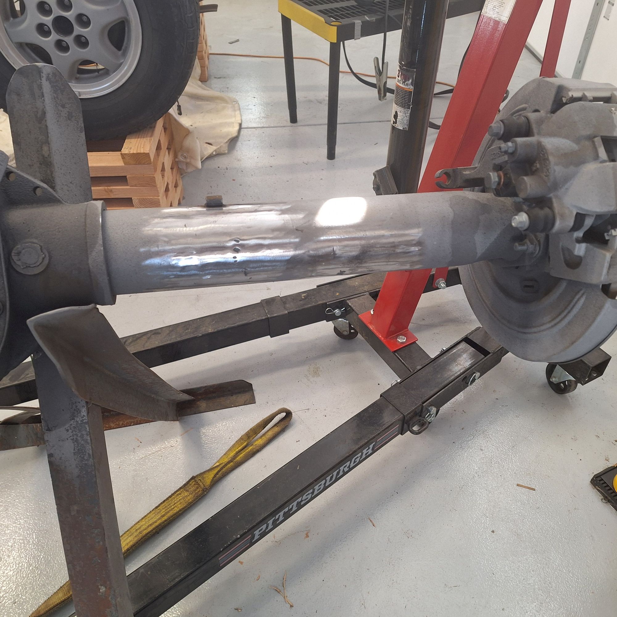

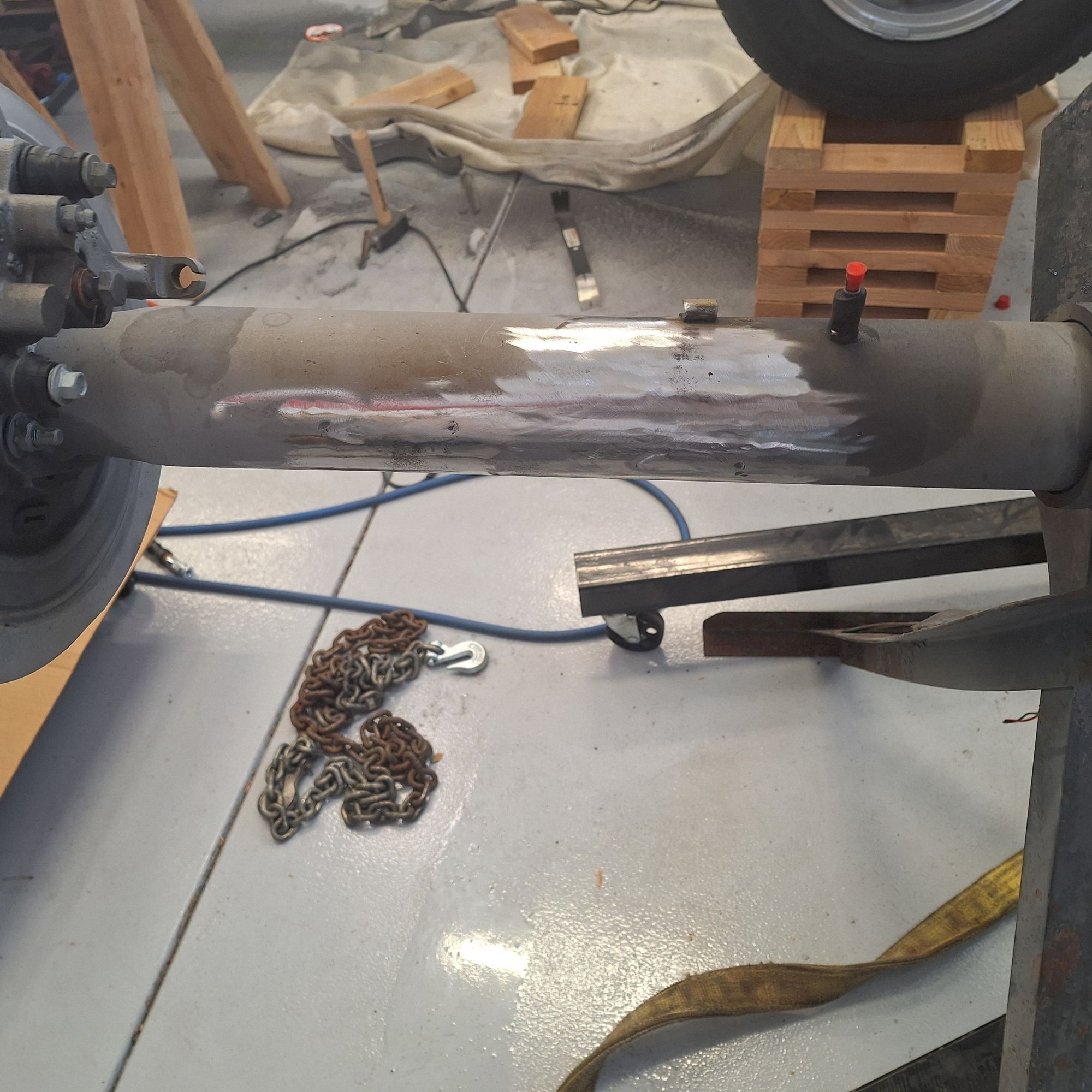

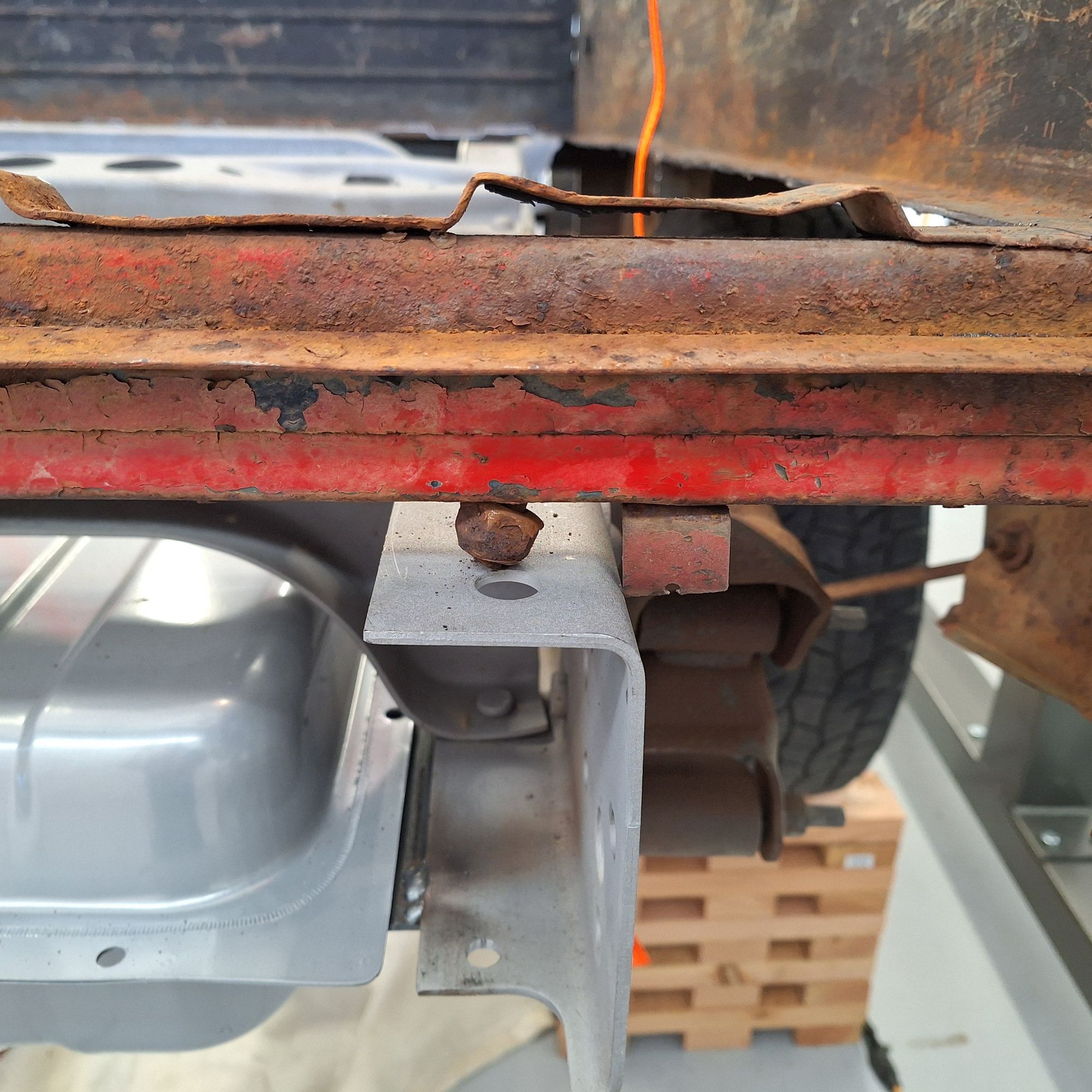

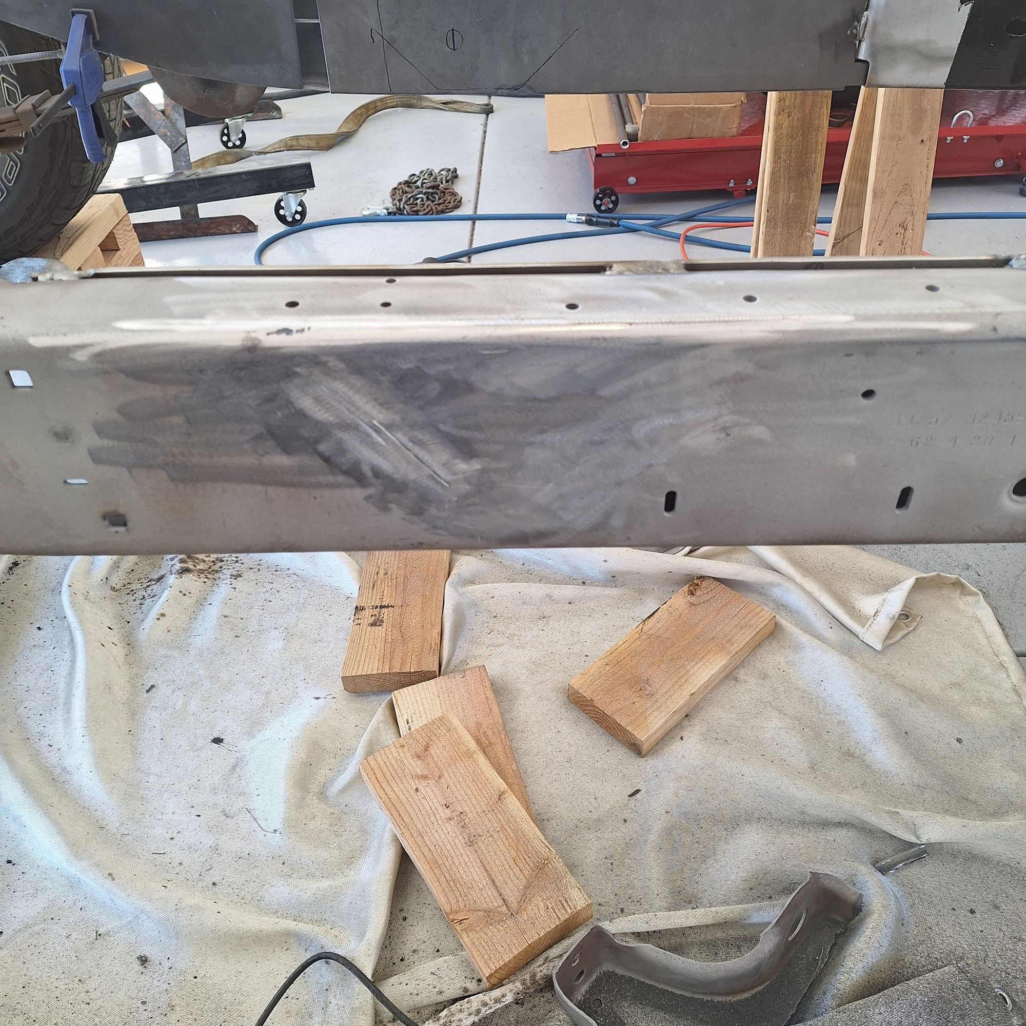

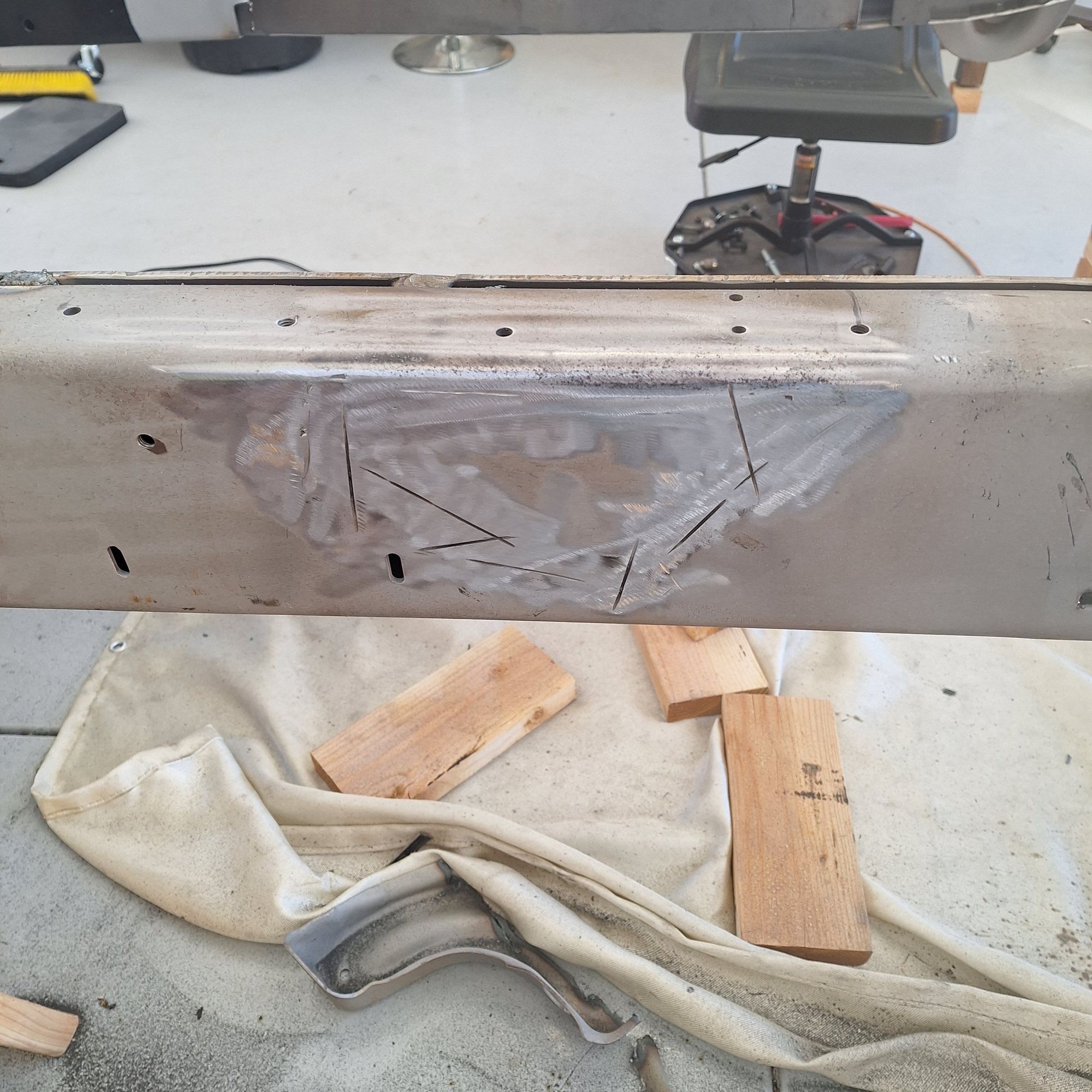

I have been all over my plasma torch, cut off wheel, and flap wheels. These are not very accurate tools, and can be quite difficult to control. To get the OEM front bed mount brackets offf, I cut as much as I could using the plasma torch. Then the cut off wheels to cut the remaining bracket pieces, trying to be careful and not cut into the frame wall. Next the flap wheel(s) to grind off the excess and welds and to smooth it all down.The first one I was a little too aggressive and got quite a few nicks in the frame wall. I will weld over those, and grind them smooth. The second side I was more careful, so less will require rewelding. Since I had my grinder out, I went at the rear axle the same way. Several spots require welding on that as well. Plasma torches can really get after the metal.
