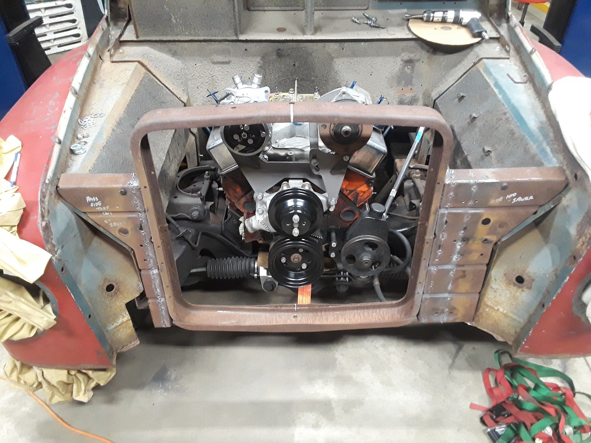

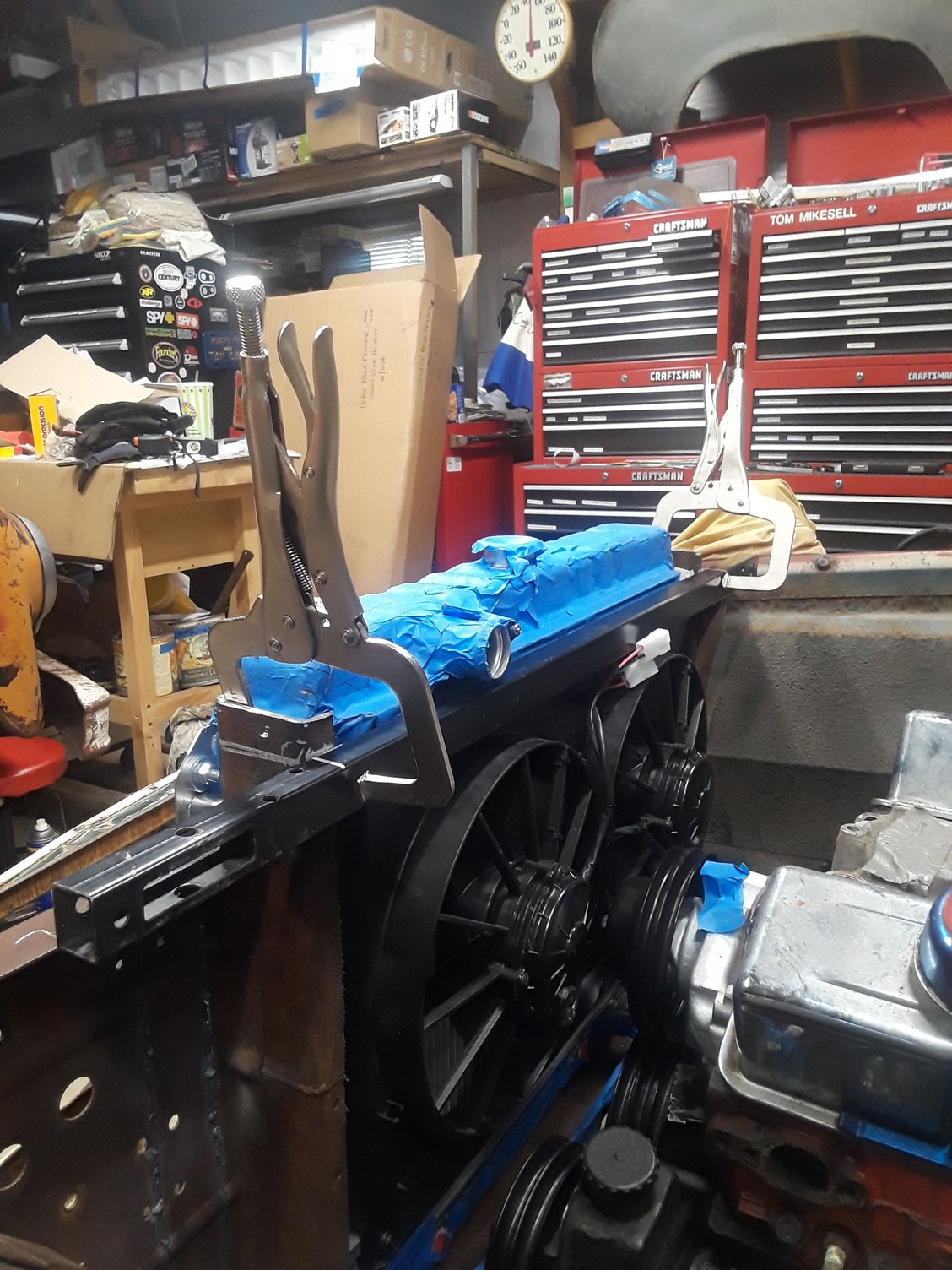

First time post for me, but I'm so focused on your project that I wanted to chime in. I too followed the methods of Racer X on the motor & trans mounts. When I put the Stude core support in I found that Studebaker centered the core support on their engine, but Dakota places the engine 2+ inches toward the passenger side. Not terrible since I'm planning on using the Explorer rear & it has a similar non-center on the rear diff & I had room to use the factory Dakota gas tank. Since I also wanted the radiator to be centered with the front of the engine, I cut the the difference out of the passenger side of the core support & added it to the driver side With the core support doing so much I thought this would be the best route. The adjustment in the core support caused the top of the support to interfere with the hood, so I cut the top of the support & rotated it to the back side oft the support to not interfere. I did this while mocking in my radiator. I'll try to post some pics. I also decided to cut the front of the frame rails so the front fenders would go down over them with my 2 inch dropped spindles in use. If you're still awake reading all this, congrats!
Pic showing shift in core support.

After shift caused interference with hood. Took this pic before rotating the cut off top to the back under the water inlet at top. I need to go back & dress-up the rotated top of the core support.

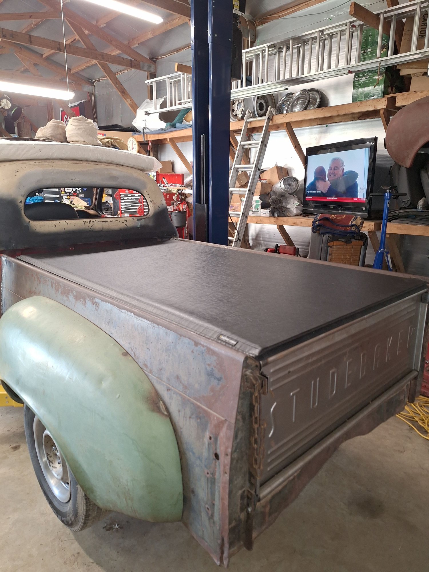

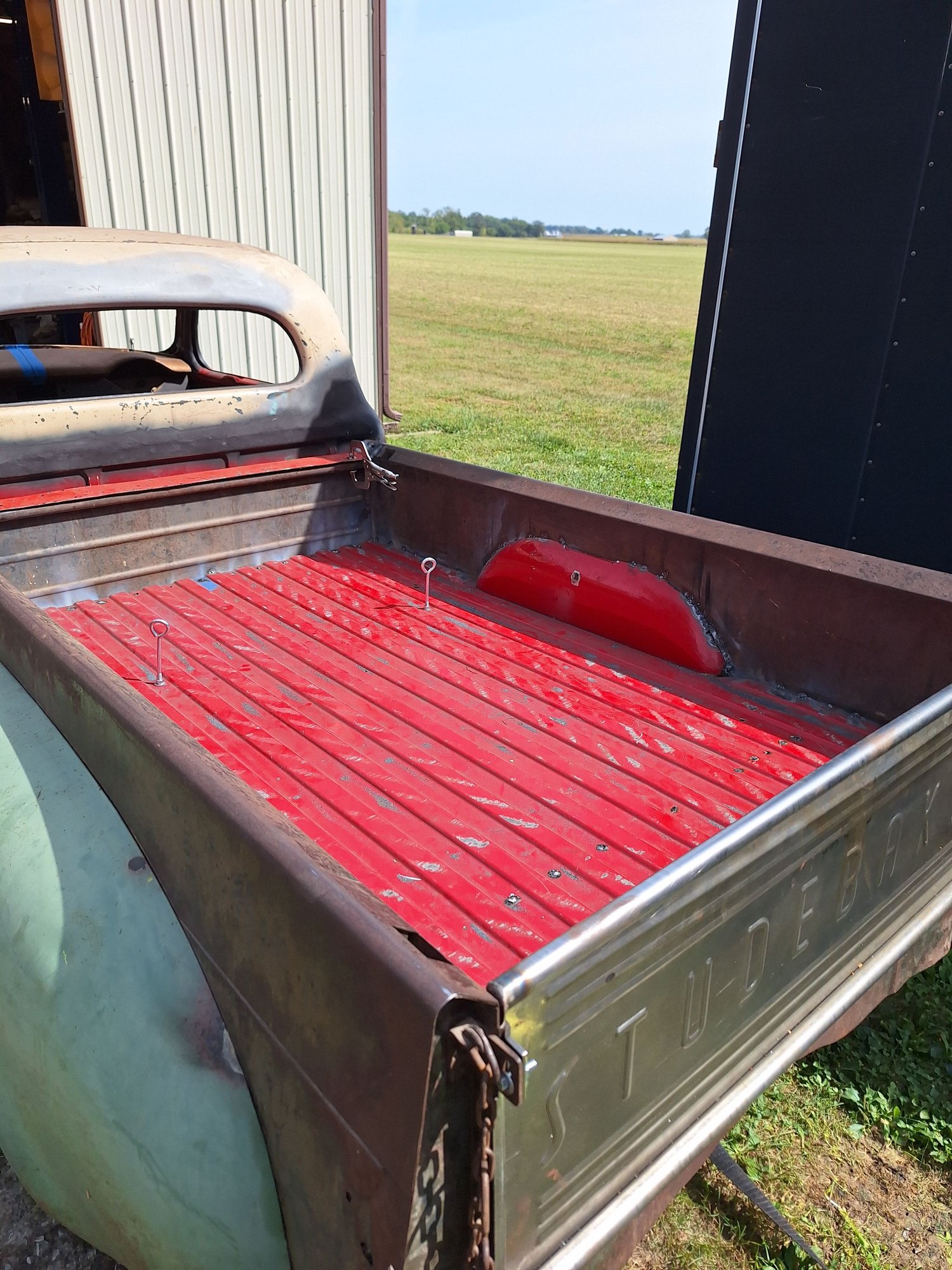

The rubber for the cab is is something I don't have yet, but couple of years back I watched how quickly the prices were going up, so I bought a lot of the parts to finish the truck. I've had my share of 'scope creep' on this project. As I was working through the fab on the bed I bought a bed cover in case I needed to modify the bed to get a cover for a newer truck (stepside, etc.), & found Realtruck would make one, so I didn't need to modify the bed. The only Stude body parts I had were the cab & some badly rotted front fenders, so I tracked down & bought a decent bed, hood, & grill. The cab is stretched 10" & chopped 2", so I spent a lot of time getting the body part placement on the frame. I put the Dakota bed floor in the stude bed, & am putting a 55 Bel Air dash in.
Roughing in custom bed cover.
Roughed Dak bed  floor.
