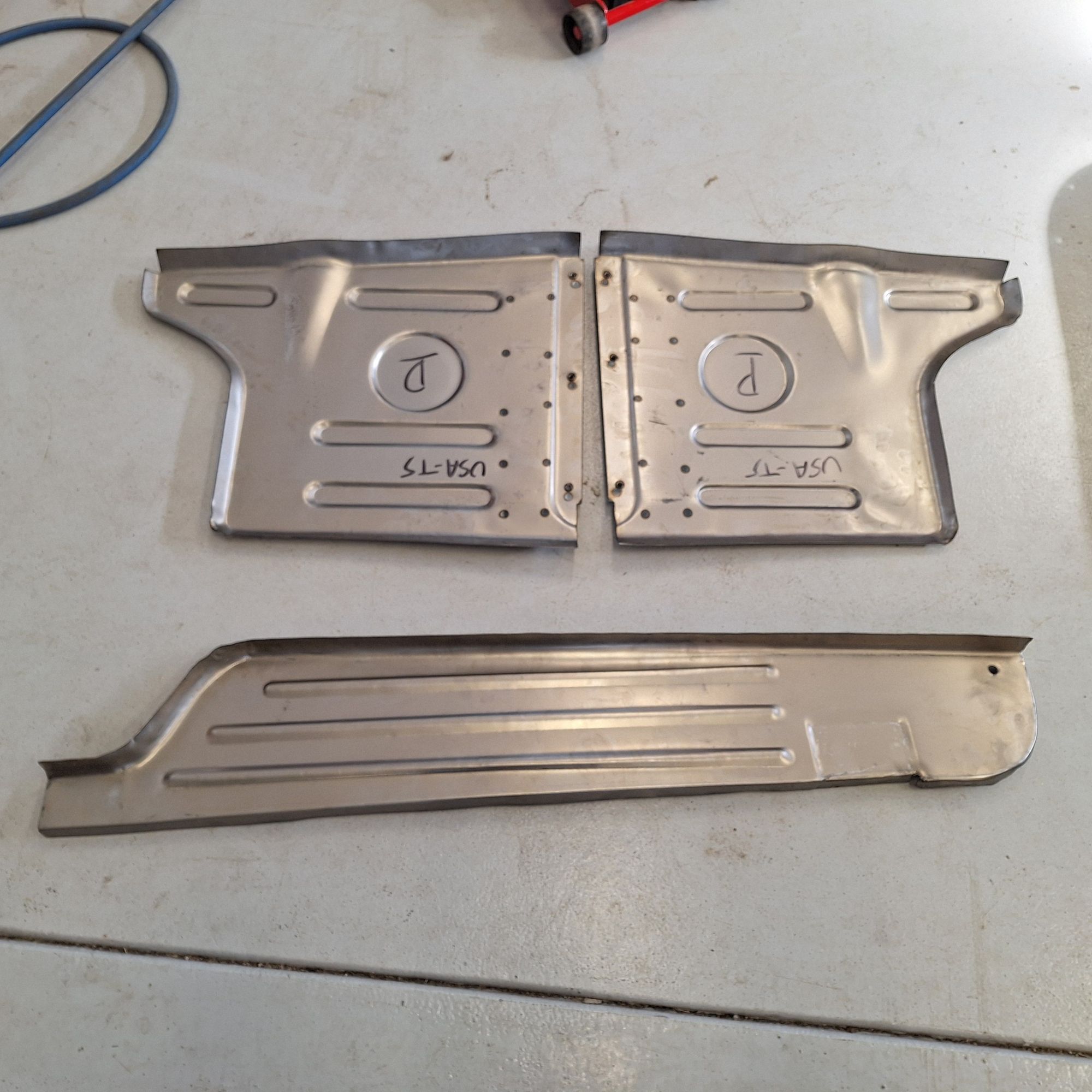

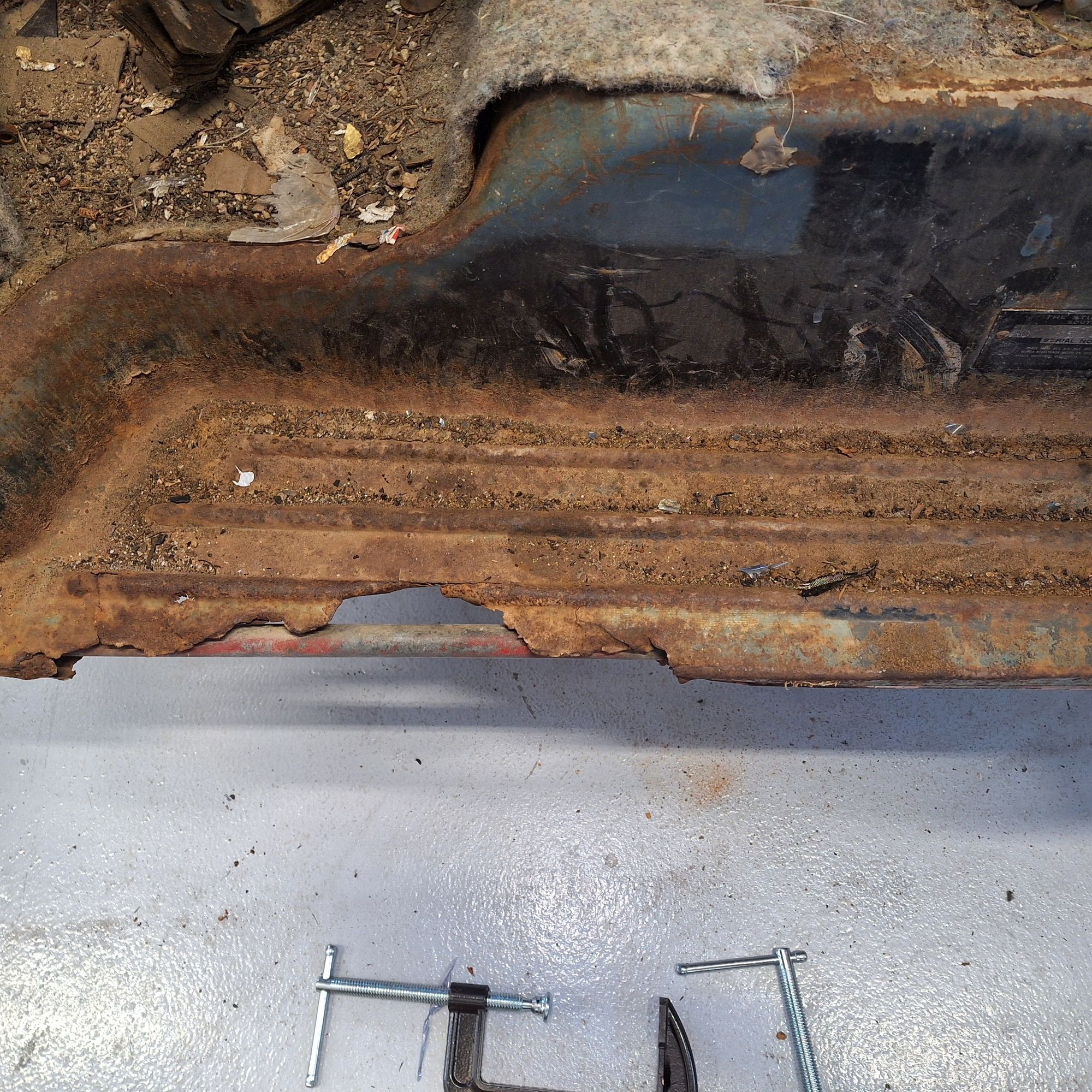

As I try to clean out the cab to see how much metal replacement I need to do, I realize some areas would be a big challenge to recreate with the limited sheet metal tools I have. A case in point is the driver's side step up (footwell). As you can see, it is rotted out pretty good. Then I found Classic Enterprises. They are still making replacement panels for many Studebaker models. Granted, they are not cheap, but they are a huge time saver! So I ordered two half floors, and the driver's step up. The cost was $444 delivered. They arrived today, and I have to say I am impressed!

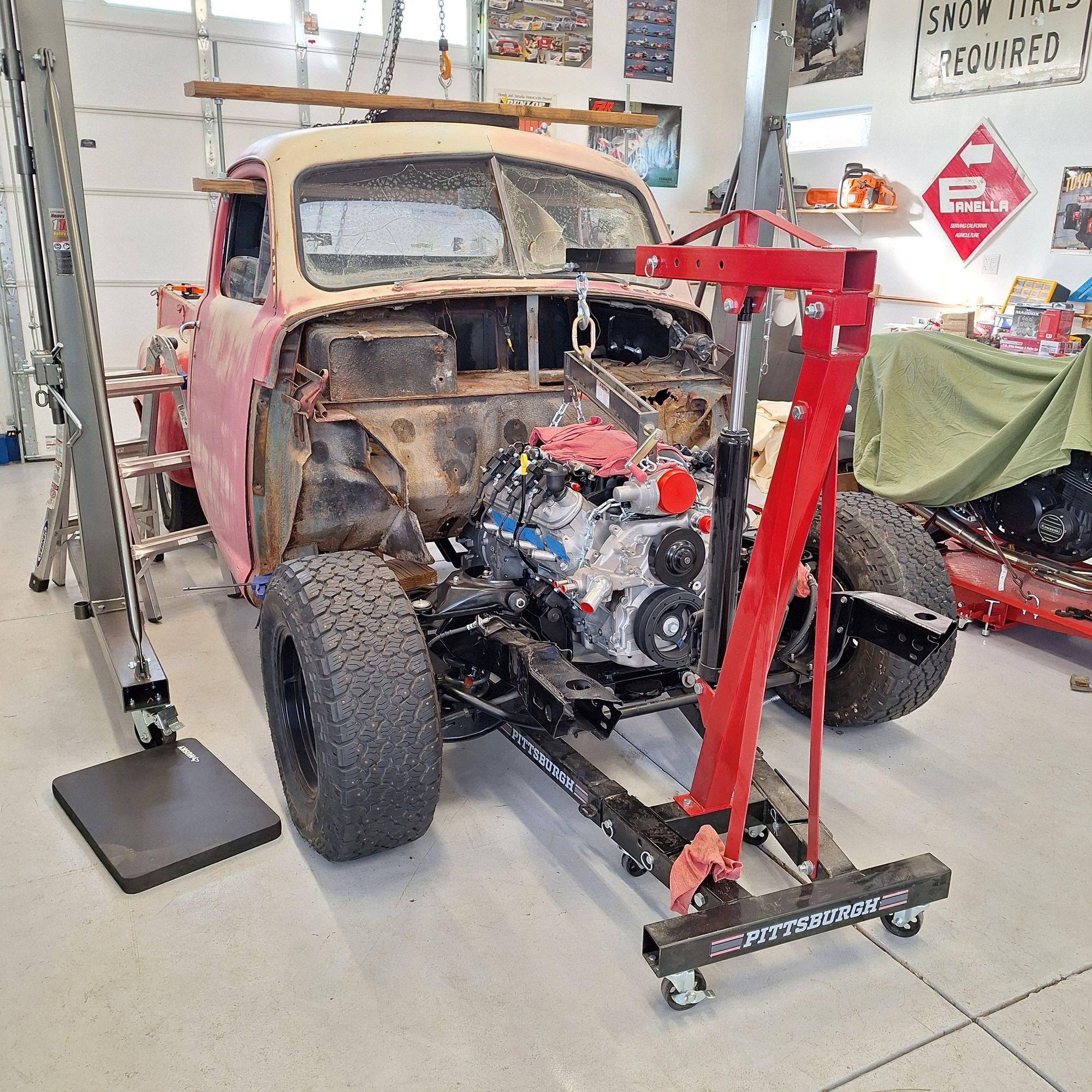

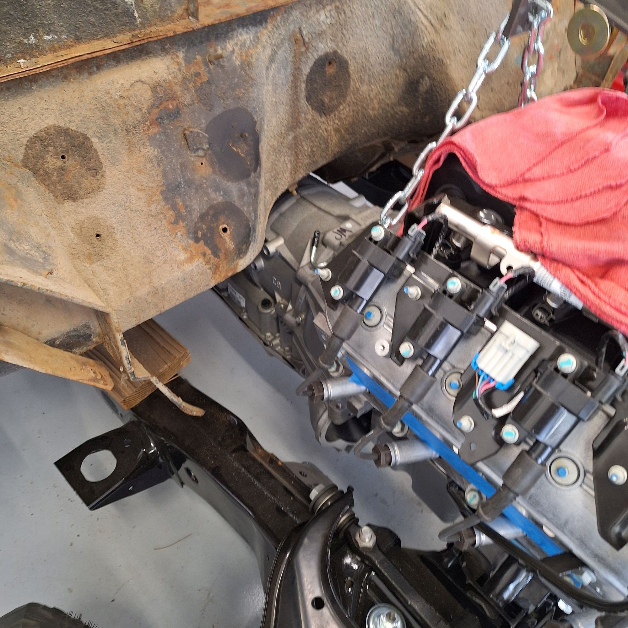

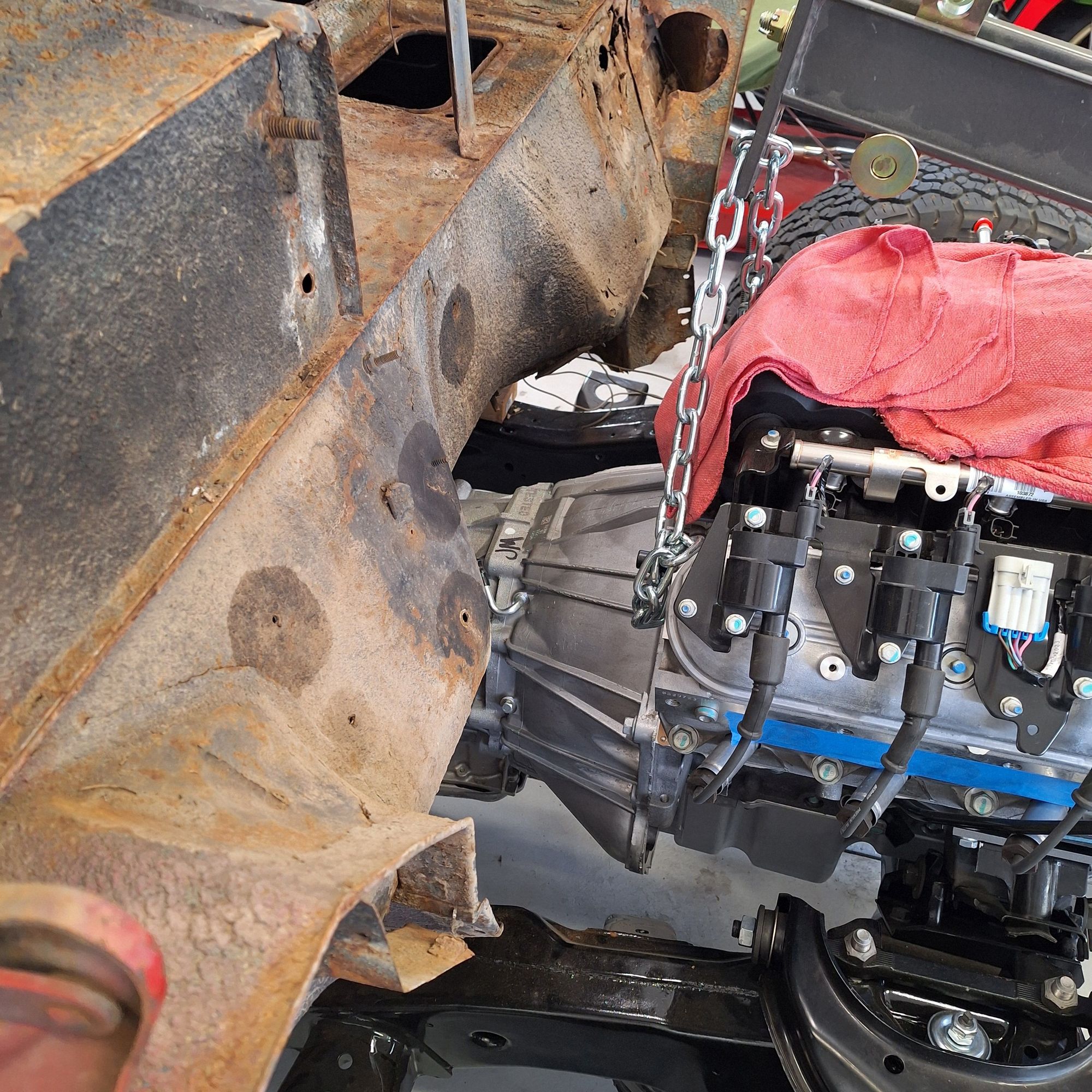

This being my first body swap project, I have aa tendency to plan for the worst. A few times now I have been pleasantly surprised. Today I put the engine and trans back on the chassis, and lowered the cab down to check for interference. This 6L80E trans is one big sucker. So I was planning on needing to do major surgery on the trans tunnel. Was I surprised when I saw how much room I ended up with! I have a slight interference on the passenger side, well down the tunnel. The firewall clearance is huge! Yes, the engine is on the motor mounts properly, and the trans is where it should be on the cross member. So maybe a bit of pounding with a hand sledge and it will be good to go!

The cab and drivetrain dropped the front frame horns 2-1/4", and I still need the entire front clip. I am already liking the stance!

Wow.... Lotsa room. Make it easy to work on too. Is the engine mounted further forward that the one in the stude frame??

I don't have a Stude frame to reference. I can't move the drivetrain farther back or the cross member won't fit. The cab is just sitting there, so in reality I could get it to come forward maybe an inch. I'm just happy that I don't need to do all that sheet metal work!

Looks good! I bought a tailgate from them & it's excellent.
