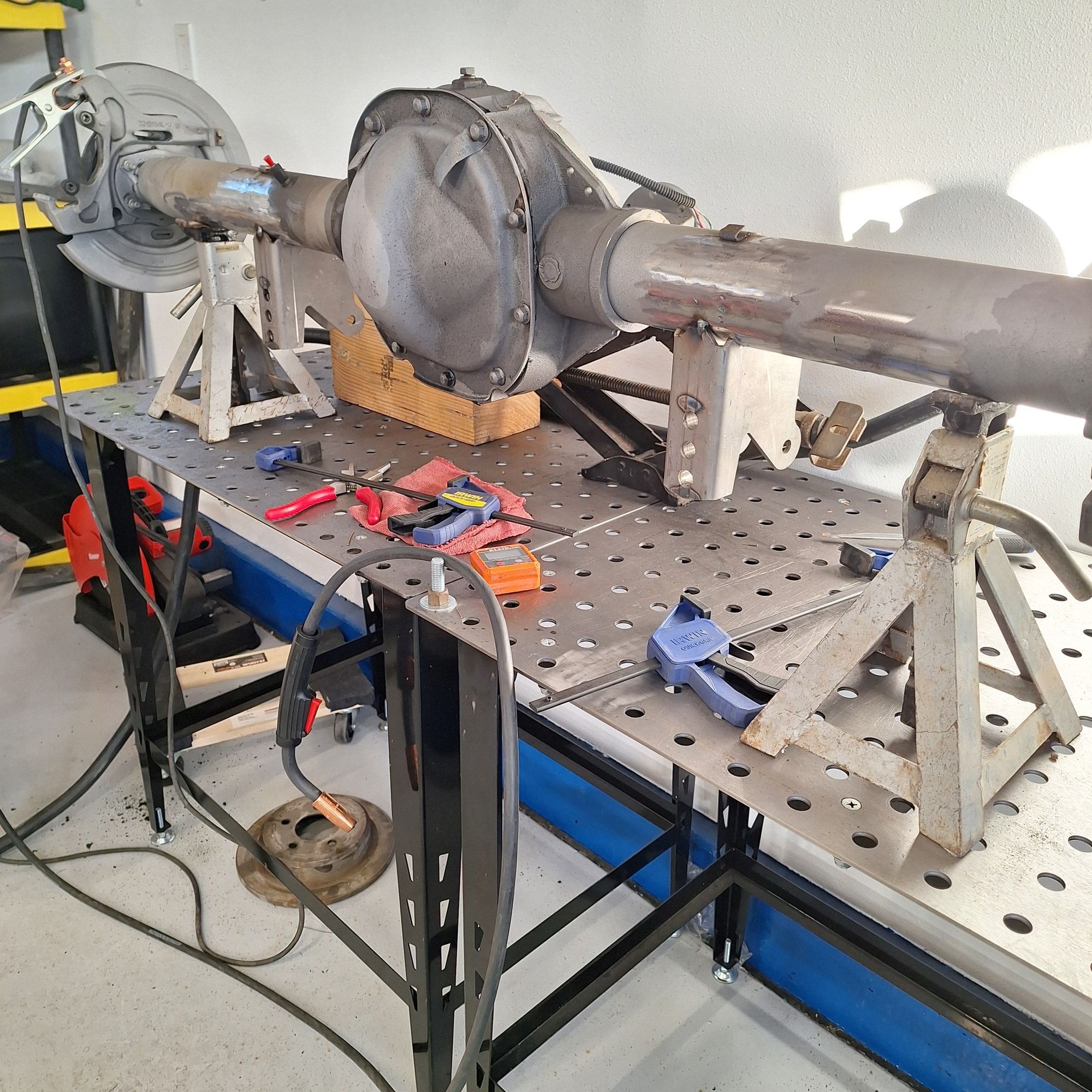

After a couple hours of measuring, checking, moving this, measuring again, I have finally gotten the rear link brackets tack welded to the rear axle housing. This is very important for the rear suspension to function properly. I also checked all the angle after tack welding to make sure they didn't move on me once the welds contracted. I went out and bought the tools necessary to pull the outer axle bearings and seals. For welding the axle tubes to the pumpkin, I will preheat the pumpkin with a torch to help achieve penetration. Moving closer to yanking the old rear end and leaf springs out!

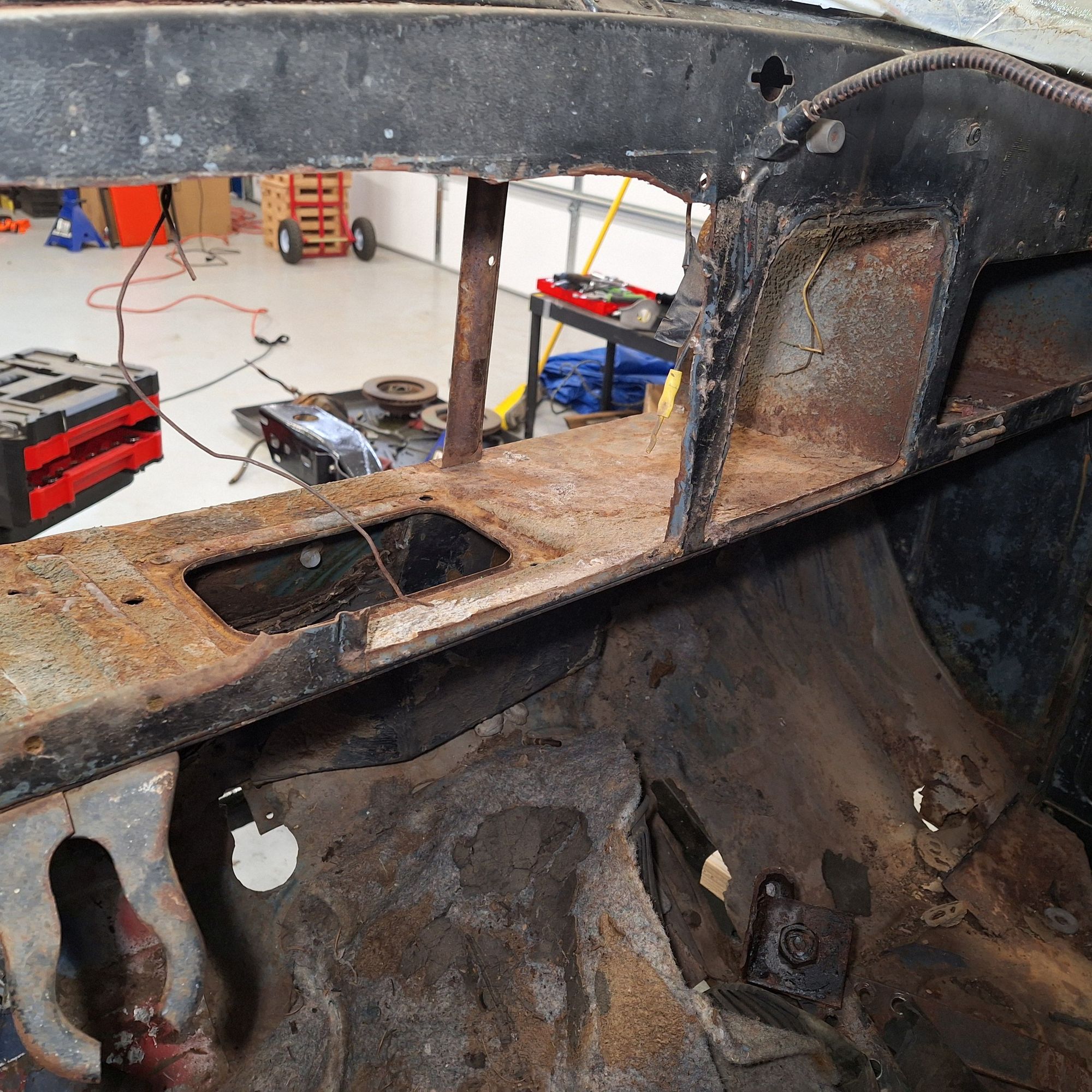

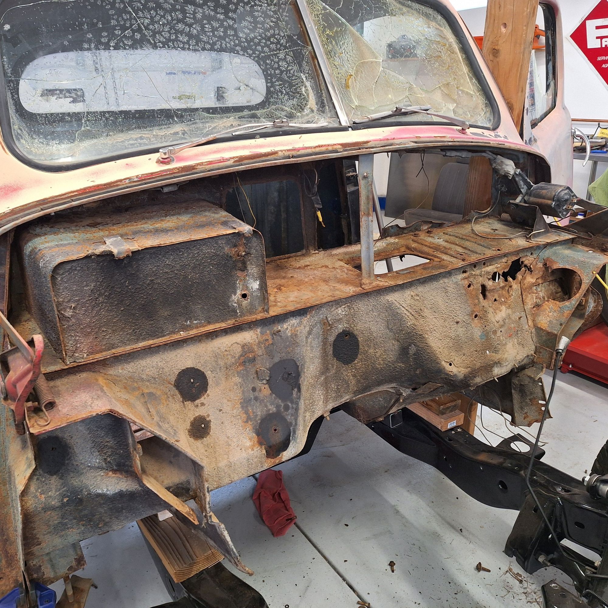

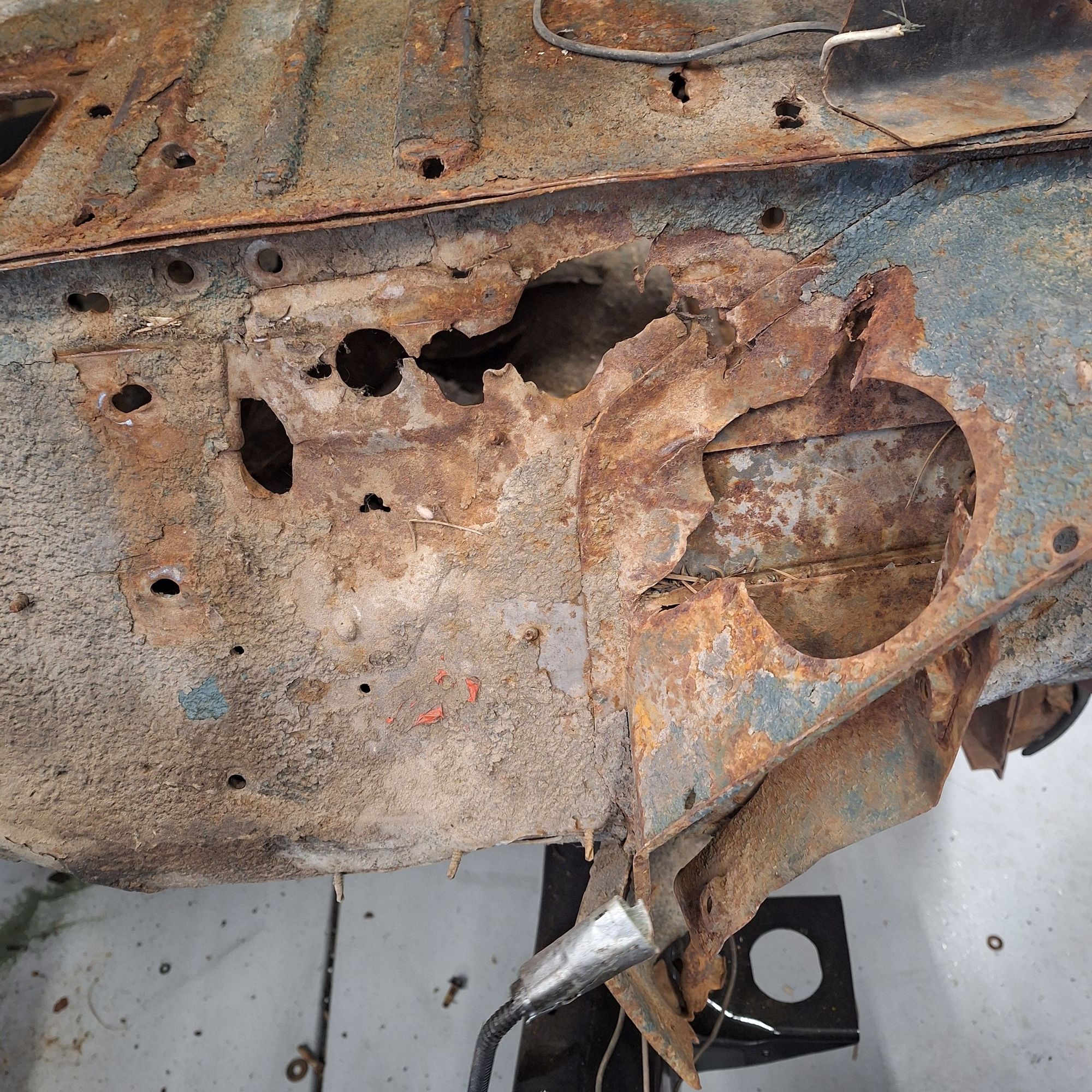

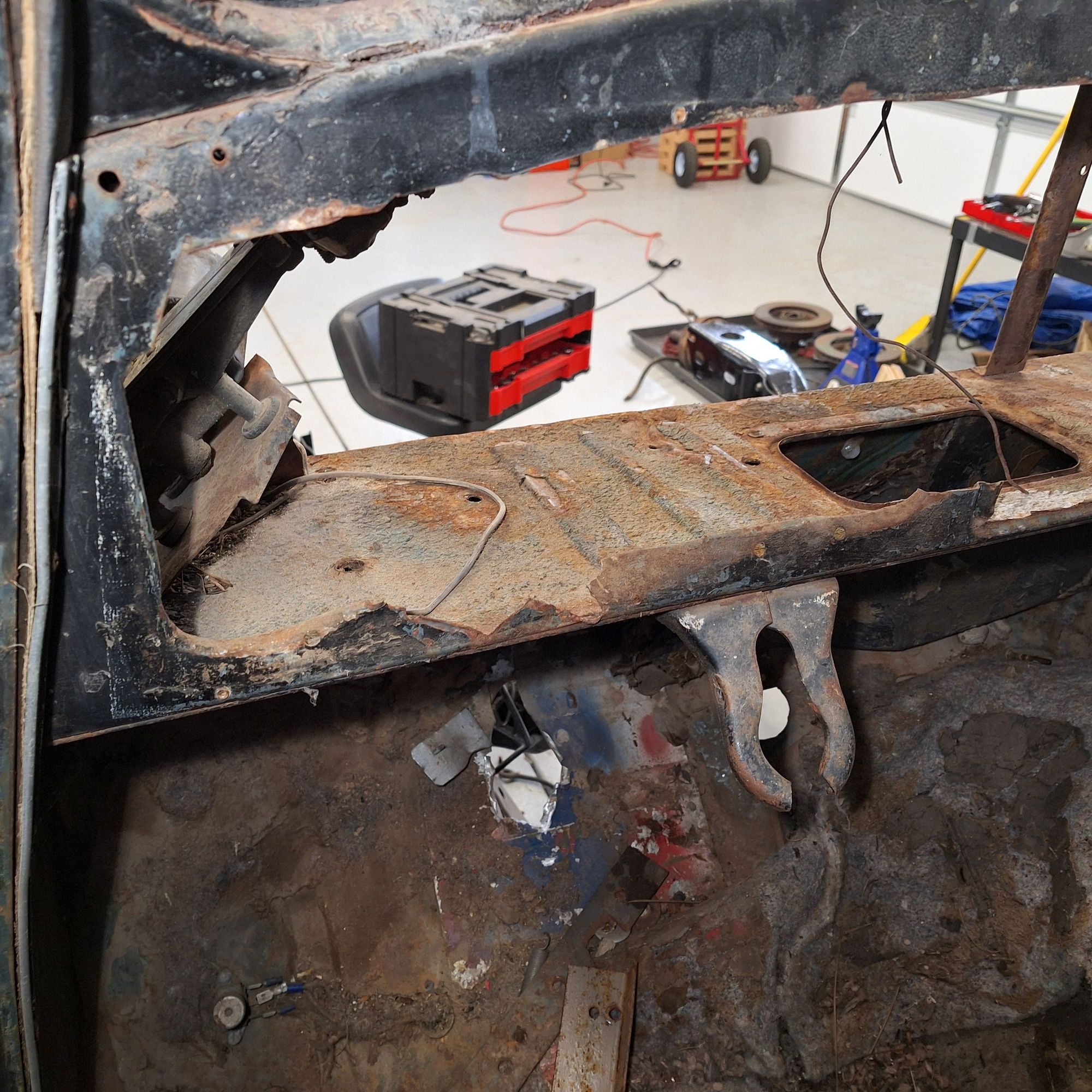

Today I decided to strip the backside of the dash to see what I will be facing (metal-wise). This farmer was a hack mechanic. Instead of repairing damaged metal, he would bolt plates over the top of it, using different size nuts and bolts along the way. With some help from the wife on the inside of the cab, we managed to get it all off. Copious amounts of penetrating oil was used everywhere. The dash and firewall are now down to the point I can see what I will be facing. I am not really surprised for a 74 year old truck, to be honest...
Old Jan 3, 2026 | 07:46 PM
  #610
Posts: 87,482
Considering its age, it really doesn't look that bad. Repairable, at any rate.
