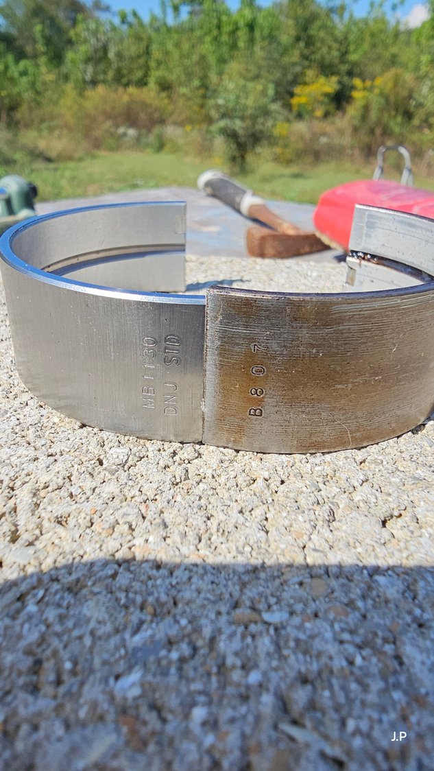

Old Oct 5, 2024 | 12:26 PM
Jp1224's Avatar
Jp1224
Joined: Oct 2024
Posts: 6
Replacement on the left, original one on the right.
the numbers on the left bearing match on all the lowers, but not the uppers. And I can't find any that will work.

Old Oct 5, 2024 | 09:32 PM
Posts: 87,411
Likes: 4,214
Are all the uppers the same??? From what I am seeing, there are three different bearings. The thrust bearing, which is obvious, one wider bearing, and two narrower.... At least, that is what the pics show....
