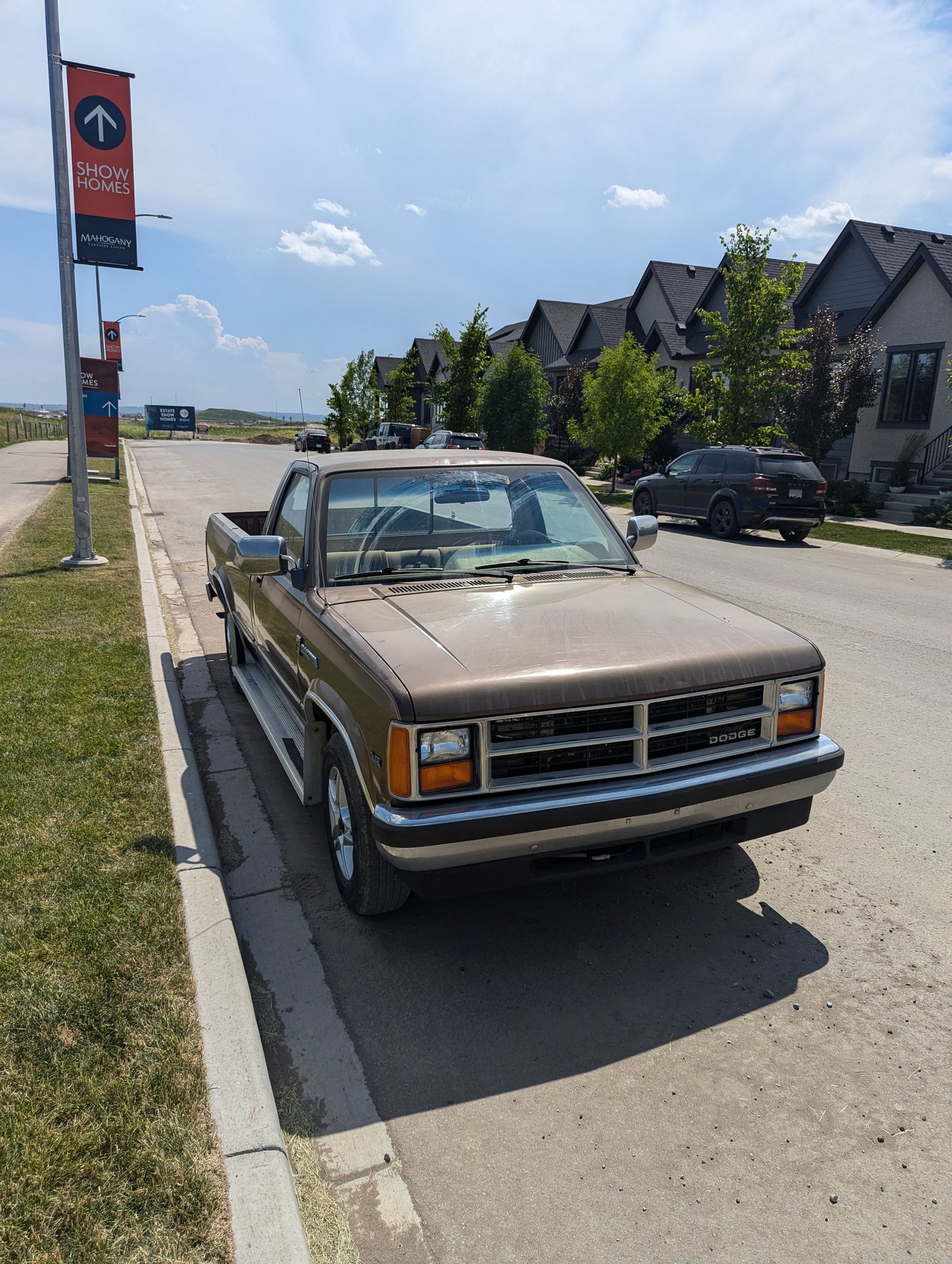

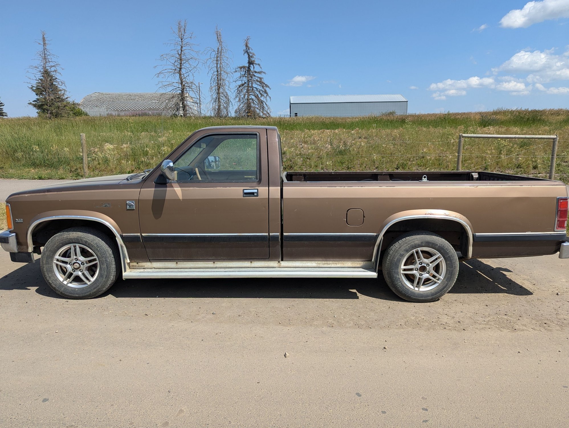

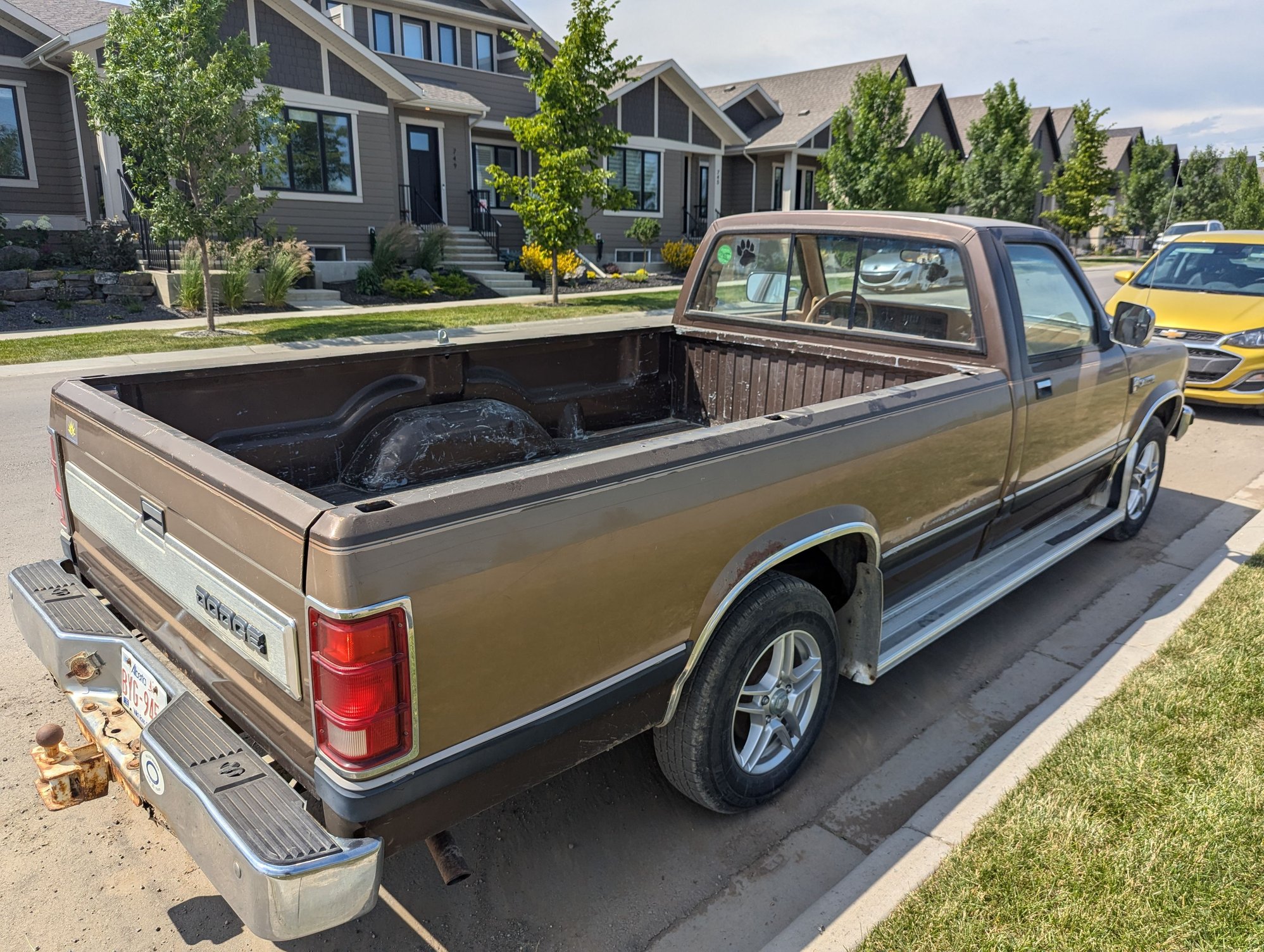

Also since the thread about putting up pic's is closed i'm going to do it here!!
