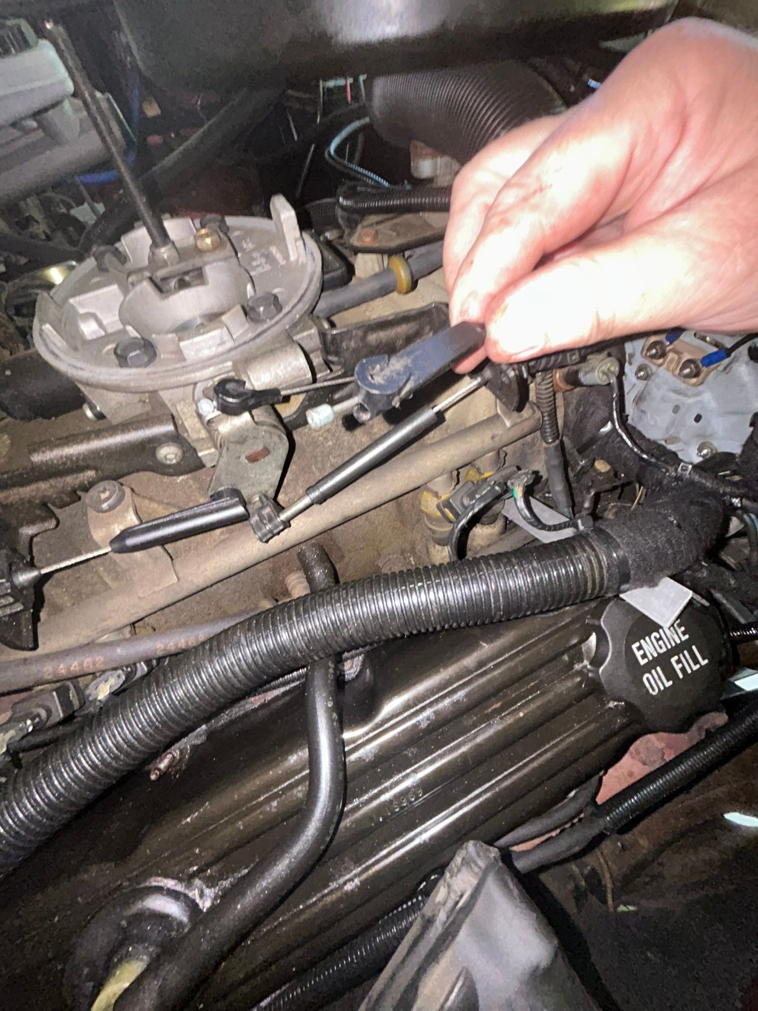

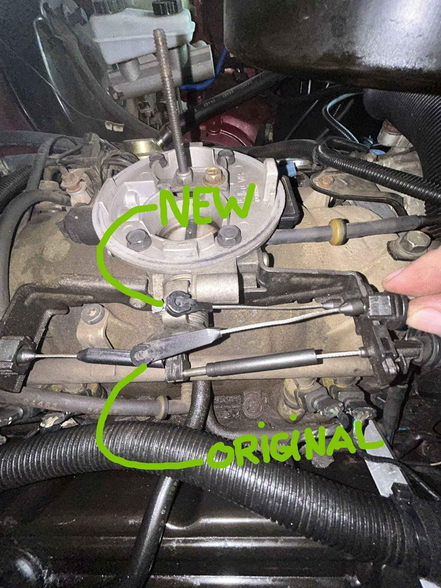

Well, this cable wont work. It's too short. Got it installed and went to fire up the engine and it went straight to 10 billion RPM at idle. A closer look and it becomes obvious. 1st picture compares the length of the two cables (original vs used one I just got). 2nd picture shows the cable protruding a little from that plastic clasp end. That little **** stop at the end of the cable actually buries itself into that plastic clasp thingy nearly to the other end. I'm more curious now if the V6 and V8 versions are different. Are the throttle bodies positioned in the same place on both blocks?? Thoughts?

Is the cable adjustable at all??
I don't know. I'm gonna look at it again. Cursory looks didn't suggest to me it was adjustable. If it is, I'm thinking it would be at that conical shaped torpedo looking thing. I'll take another look.
