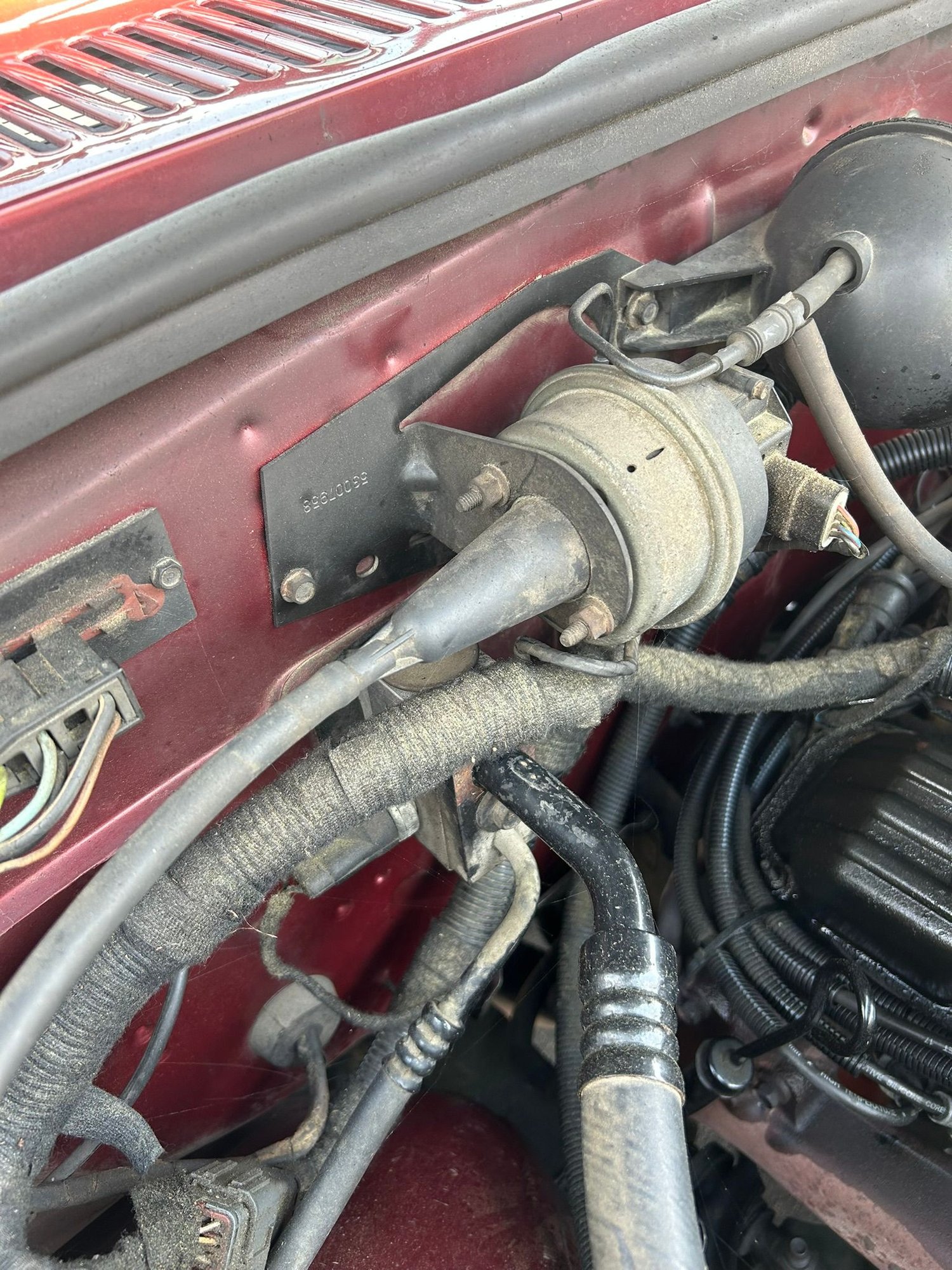

HY, I think I might have found the right one. See https://www.ebay.com/itm/17653462332...3ABFBMpIKTy4Bm The ad says '93. It surely looks identical. Pics aren't the best. Here is a pic of mine. Does it look the same to you? No, I wont hold you to anything. Just looking for a second opinion. BTW, pickins for this cable are between slim and none. I'm relegated to crusty parts, I'm afraid.
Old Jul 13, 2025 | 01:26 PM
  #35
Posts: 87,467
Likes: 4,220
Looks like it has the correct end on it at least..... beyond that... Couldn't tell ya.

Yeah, that end looks the same length as my original. I'm beginning to think there was a change in '94 to the shorter end piece. I looked at everything else and it's all in the same place as my original except the vacuum line comes out in a little bit different place but that vacuum line is floppy with lots of play in it so that doesn't concern me. But the servo itself, the cable, the end piece that goes on the throttle, the firewall bracket, electrical, etc are all identical. He has another ad for a '93 speed control but he only has pictures of the truck, not the part(s) themselves. It's definitely a '93 like mine. Guessing the two ads are for the same part. Think I'll spring for it. He also has a 30-day return policy. Risk is low.
