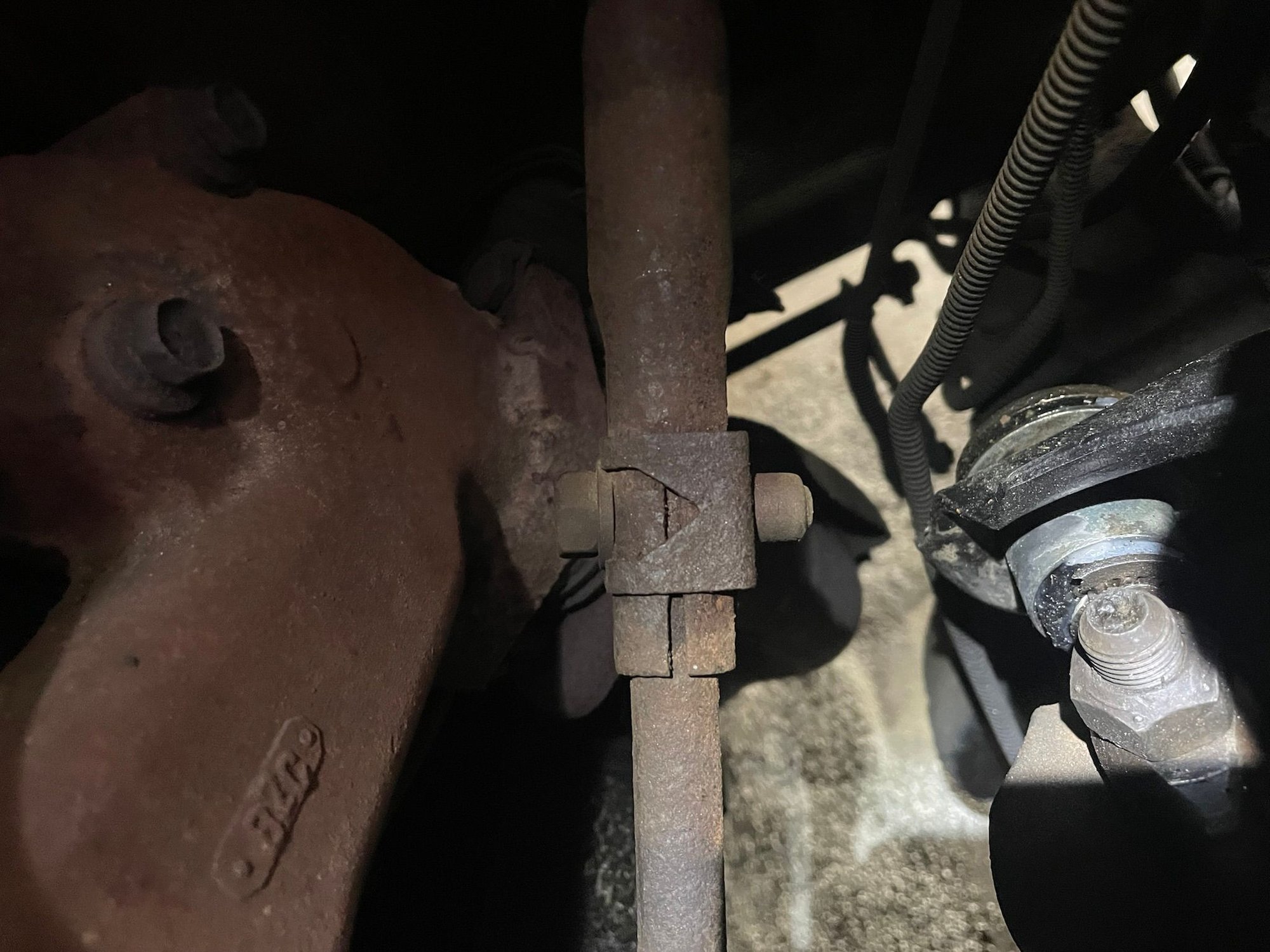

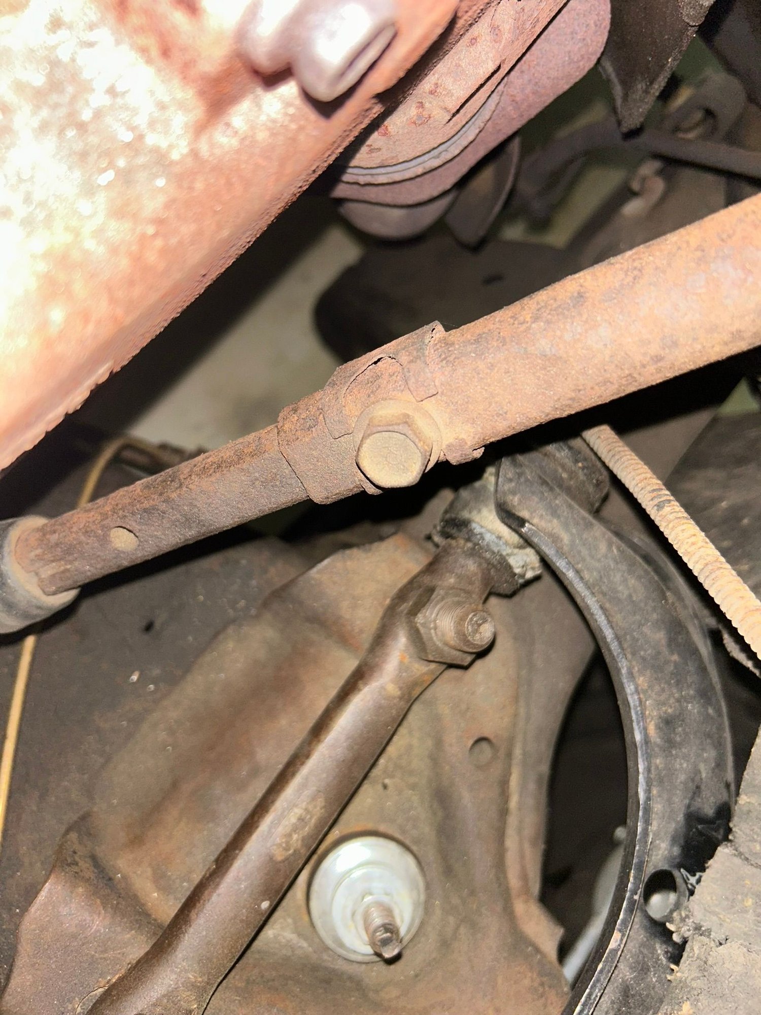

I'm moving my steering rack discussion to this thread that I started earlier this month. Makes no sense to discuss it on the AC thread from someone else. I got under the truck and there is no way I can remove that roll pin holding the steering column to the rack. See pic. There is simply no room whatsoever. However, I believe I can detach the steering shaft from the upper coupler (see pic) at that bolt securing that cage-like thingy around it. Just loosen the bolt and the shaft should slide out as I lower it out of the truck. Any thoughts?
Arrow points to the roll pin.It about 3/16" dia.

I think that's where the column is supposed to collapse in the event of a collision, so, likely need to completely remove that bolt...... Getting it back together again might be fun though, as I am unsure of just what all is in there.... Could you disconnect it the base of the column?
I don't think so, HY but I'm going to look at it again. Here's a side view of that bolt.
