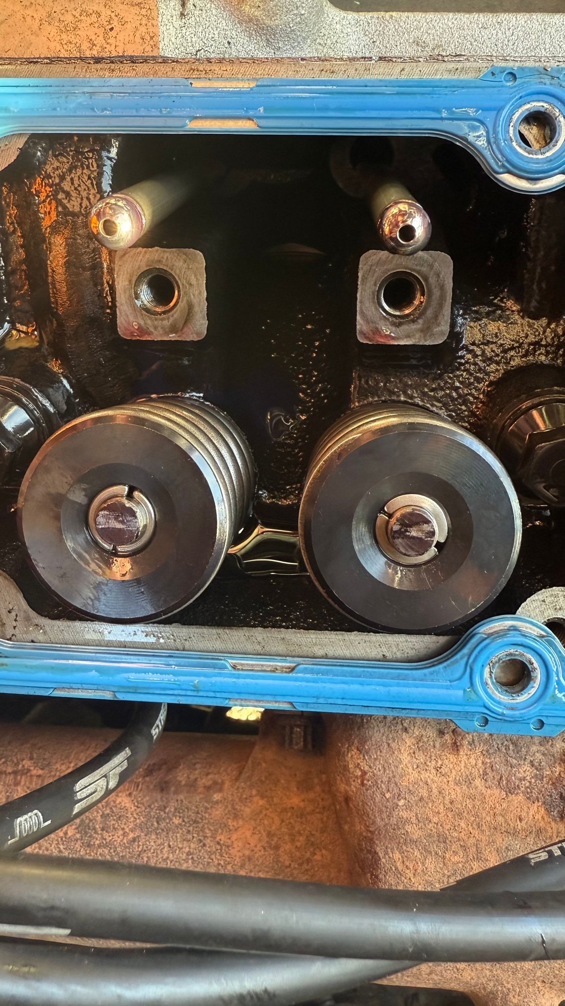

So potentially some progress in the right direction?
I had my old 6.936” pushrods laying around, and I put them in which would provide me with around .100 preload. The ticking is still there, though seemingly quieter at least in the cab.
I did count the turns for each rocker, and it fluctuated a bit between valves. Anywhere from 1.25 to 2 turns. I did also get this wear pattern using a sharpie.
Im curious though, if the amount of turns to 21 foot pounds from zero lash on each rocker is inconsistent, is this what adjustable rockers would help with?
Old Dec 21, 2025 | 09:09 AM
  #105
Posts: 87,479
Adjustable rockers make getting a quiet valve train easy..... The lifter will have some tolerance for variations in the heads, etc... It looks like your heads are milled adequately for screw-in studs though...... which would allow for adjustable rockers....
