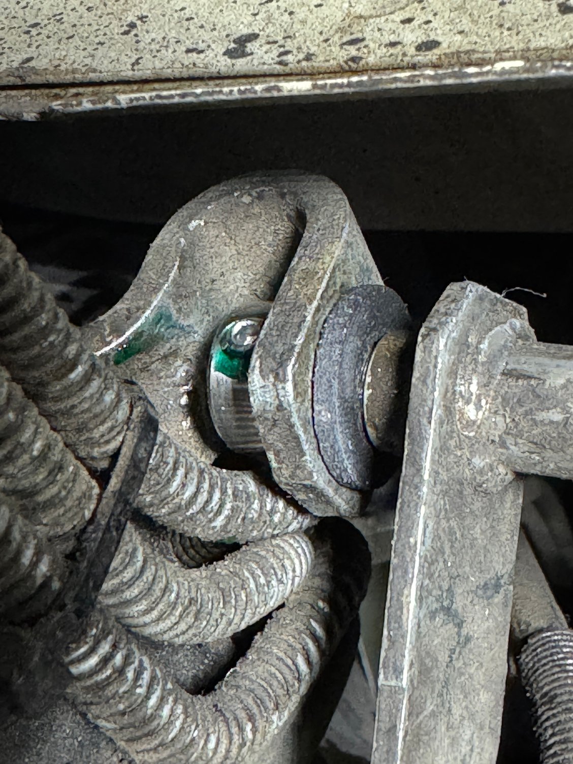

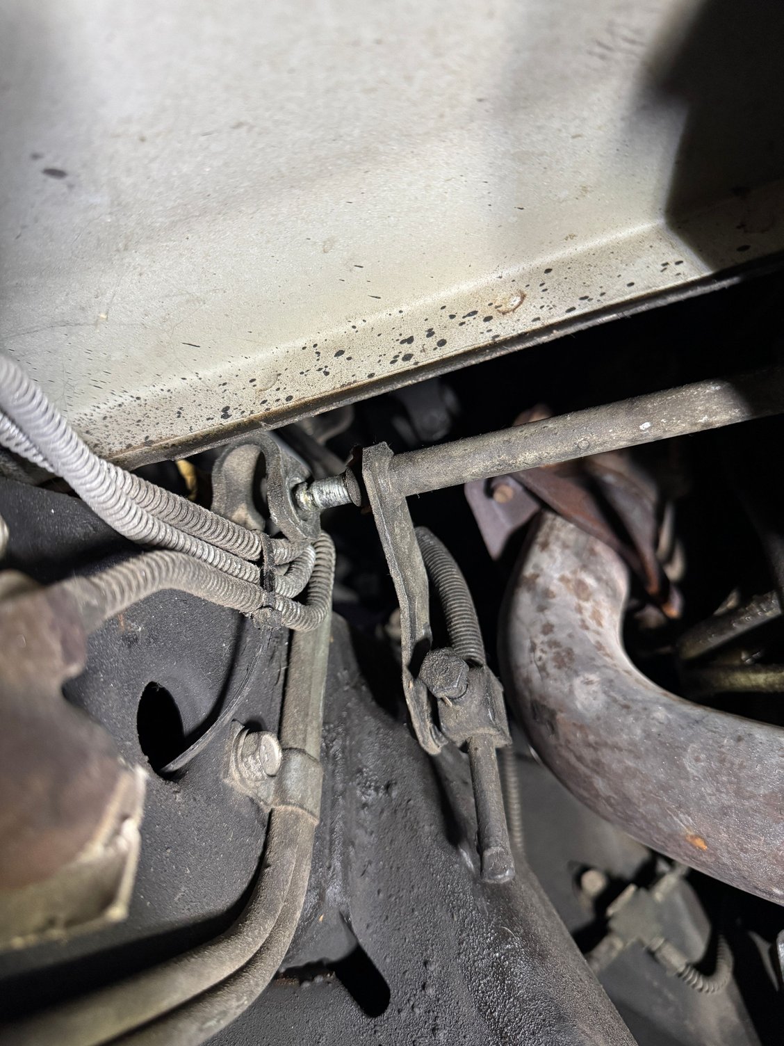

Hello,

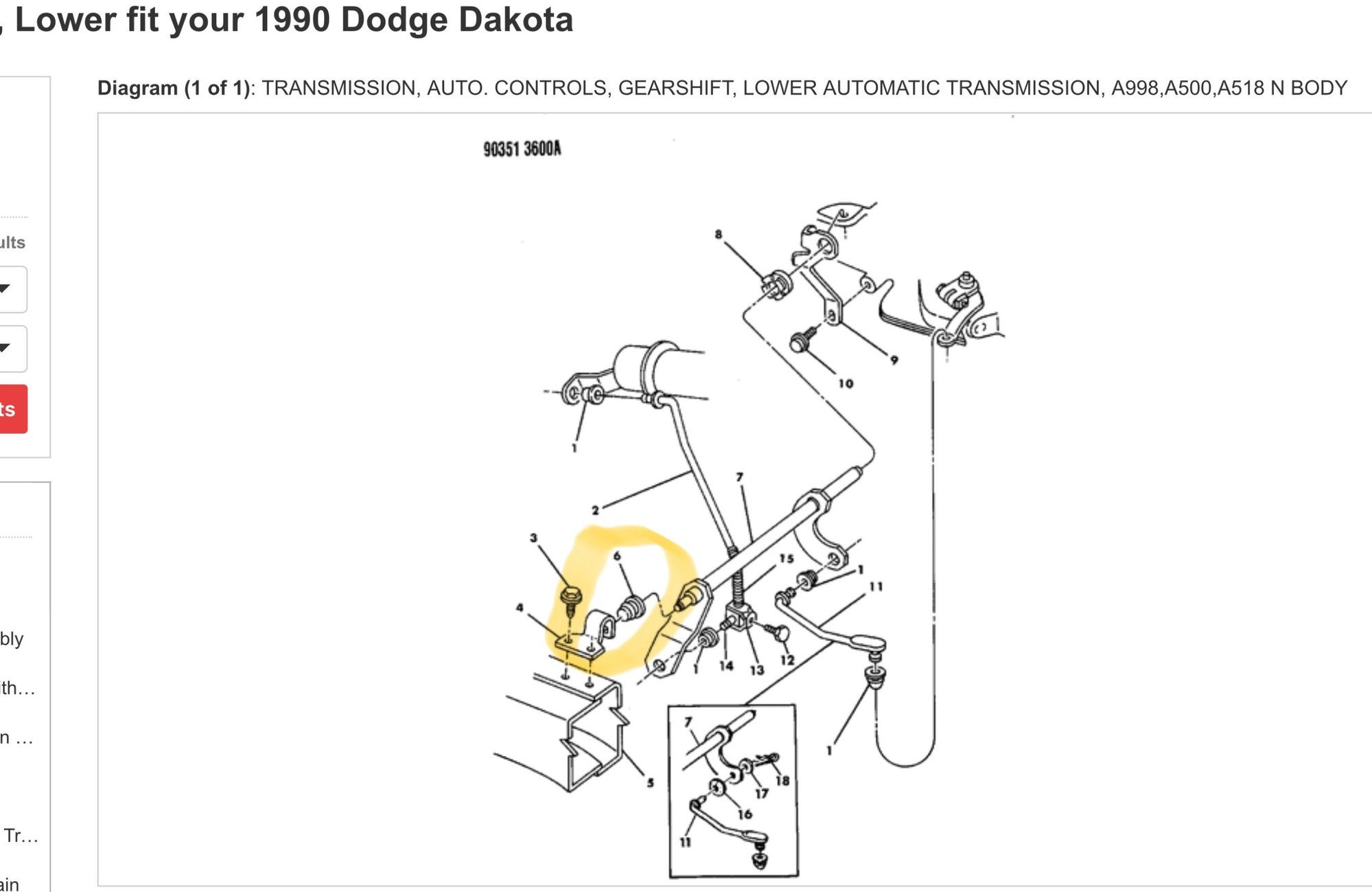

Suddenly the gearbox stopped shifting... So I crawled under the car and lo and behold, the bushing for the linkage bracket was missing. Does anyone have a photo of what it should originally look like? I suspect this is the part? Thanks and regards.
sven
Old Nov 8, 2025 | 04:55 PM
Posts: 87,406
Likes: 4,214
Yep, that be the feller.

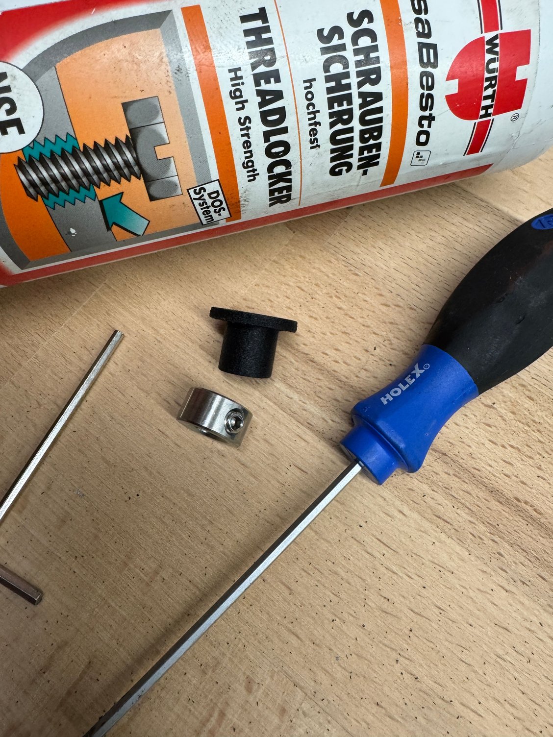

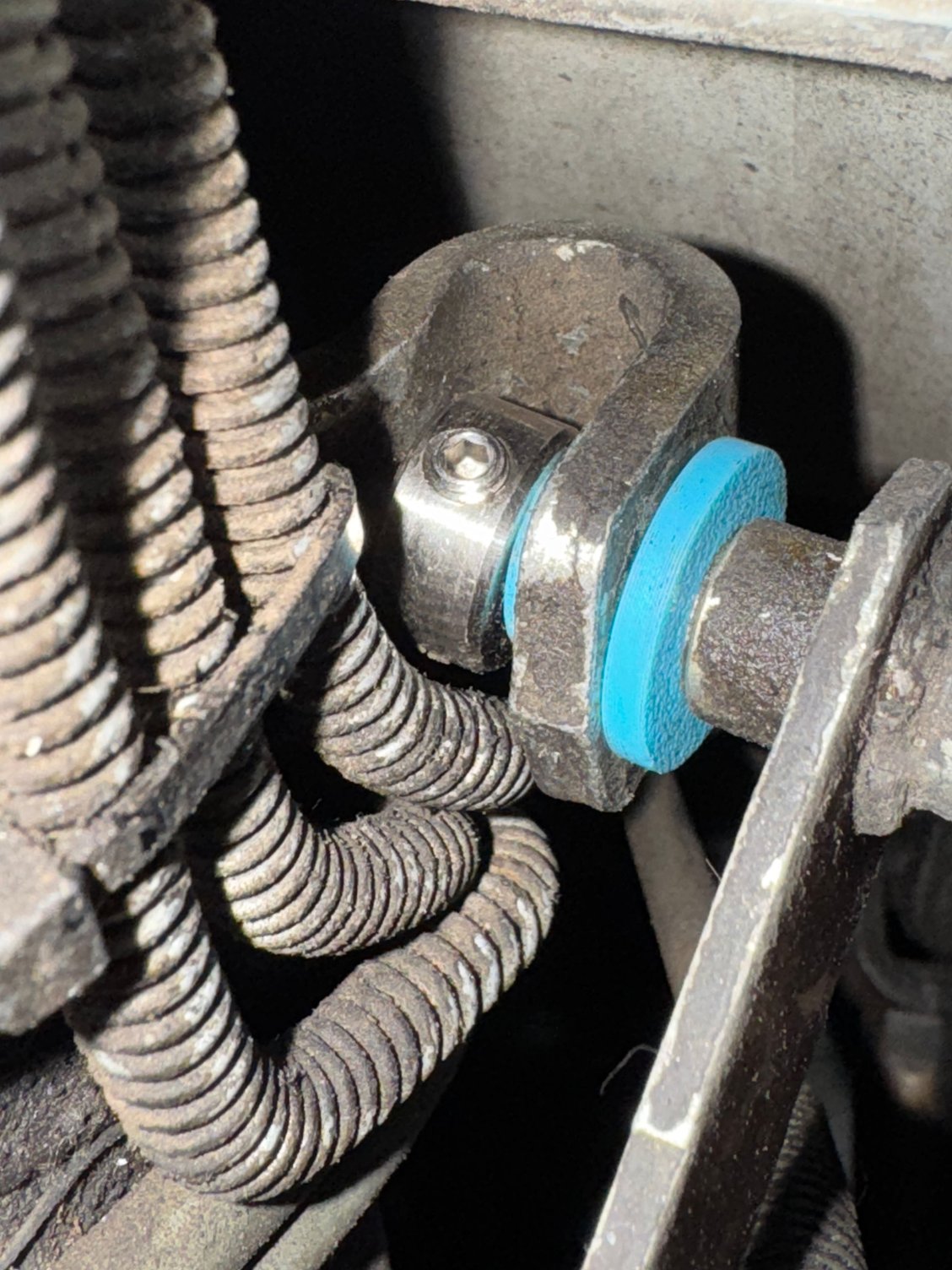

Default Solution
My Solution 👍 3D Print
Old Dec 2, 2025 | 07:52 PM
onemore94dak's Avatar
onemore94dak
Joined: Sep 2013
Posts: 2,724
Likes: 153
Clever. You should lube that with white lithium grease. If it fails Dorman makes them pretty cheap. The late great RalphP posted the part number years ago.
