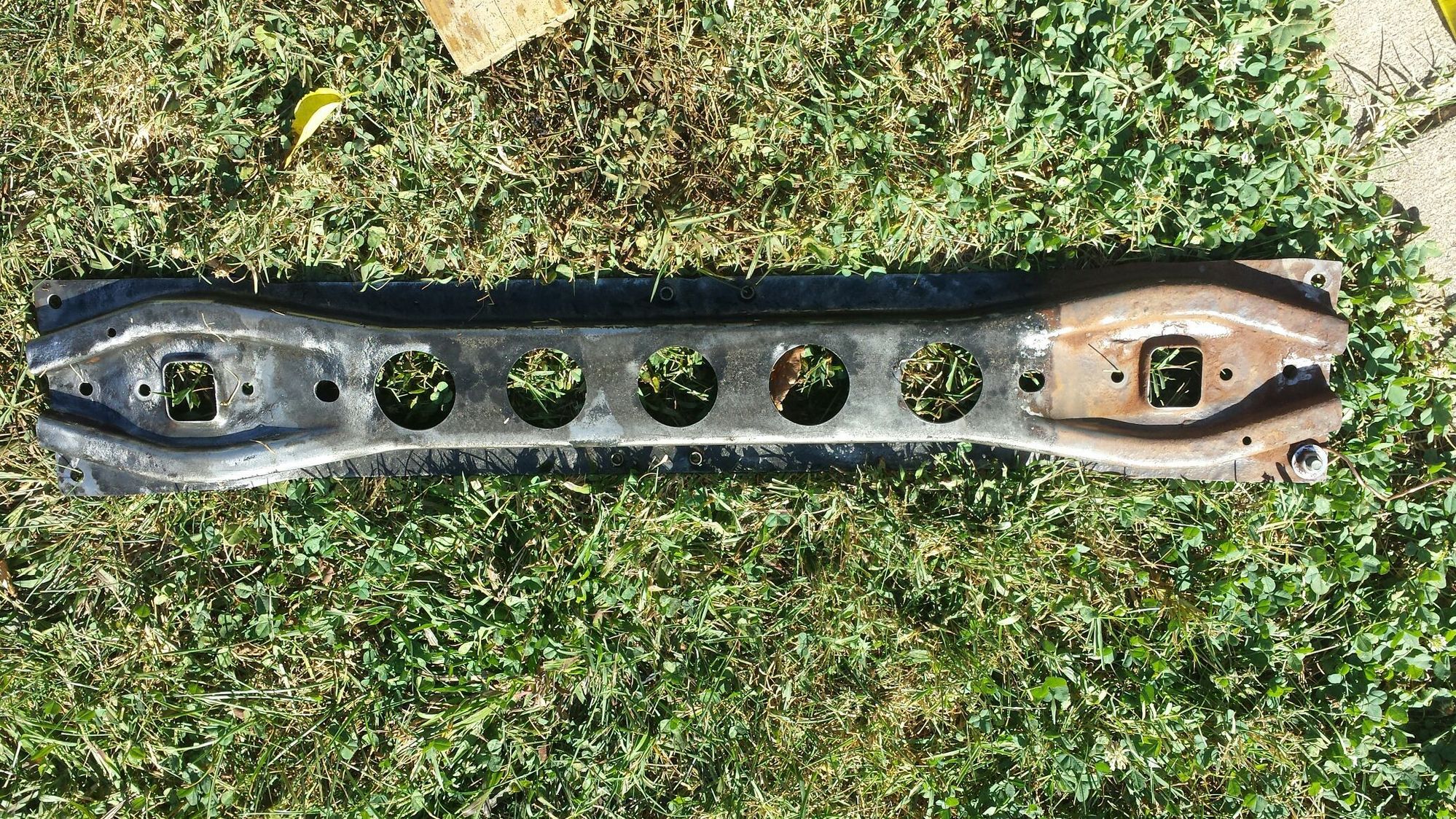

This first picture is the piece that is riveted to the frame and holds the shocks.

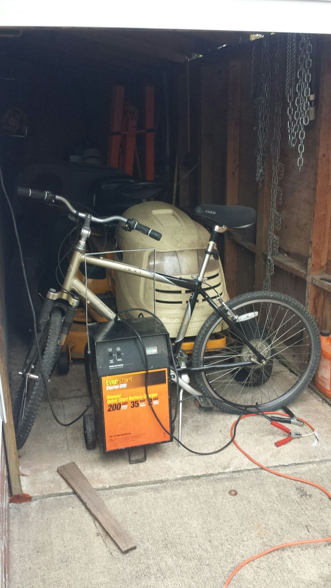

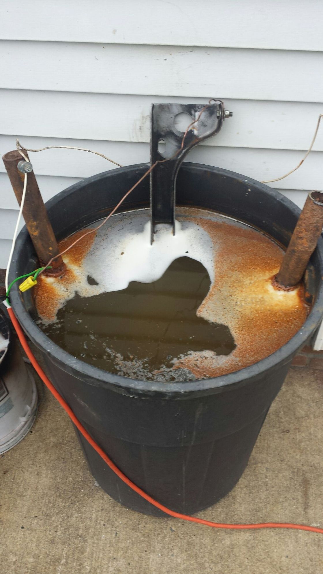

These next two pictures are of my highly sophisticated electrolysis machine!!
That's it!! I took a trashcan, filled it with water and about a half box of "arm & hammer, washing soda" I got mine at my local wal-mart. Its with the laundry detergents etc. Cost less then $4.00 for a 55oz box.
You simply hook the part you want to clean to the negative cable. Hook the positive to a piece of bare steel, ie, not galv, painted, etc. Then just turn the charger on and wait 8 hrs or so.
I can supply more details if anyone is interested.

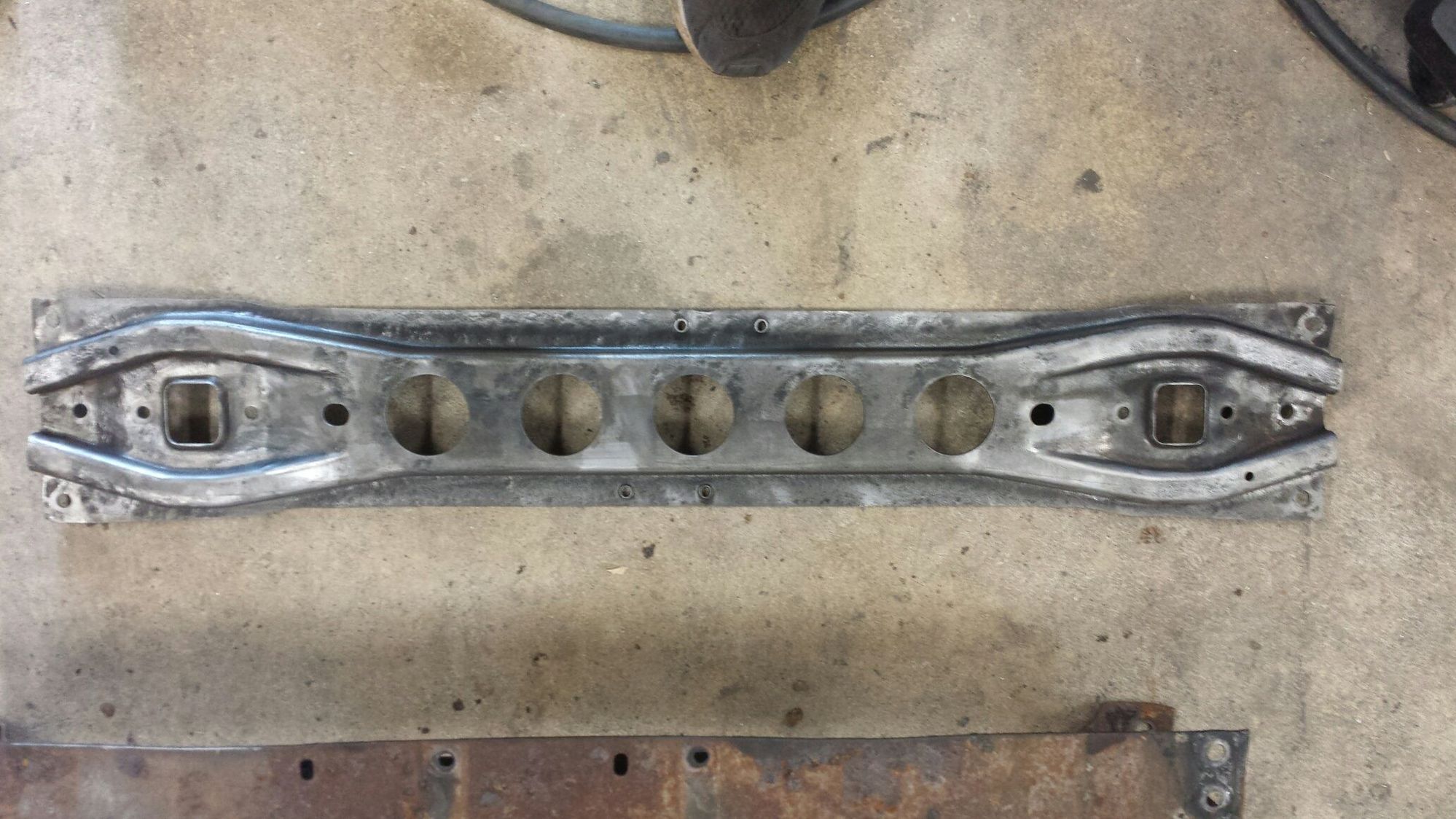

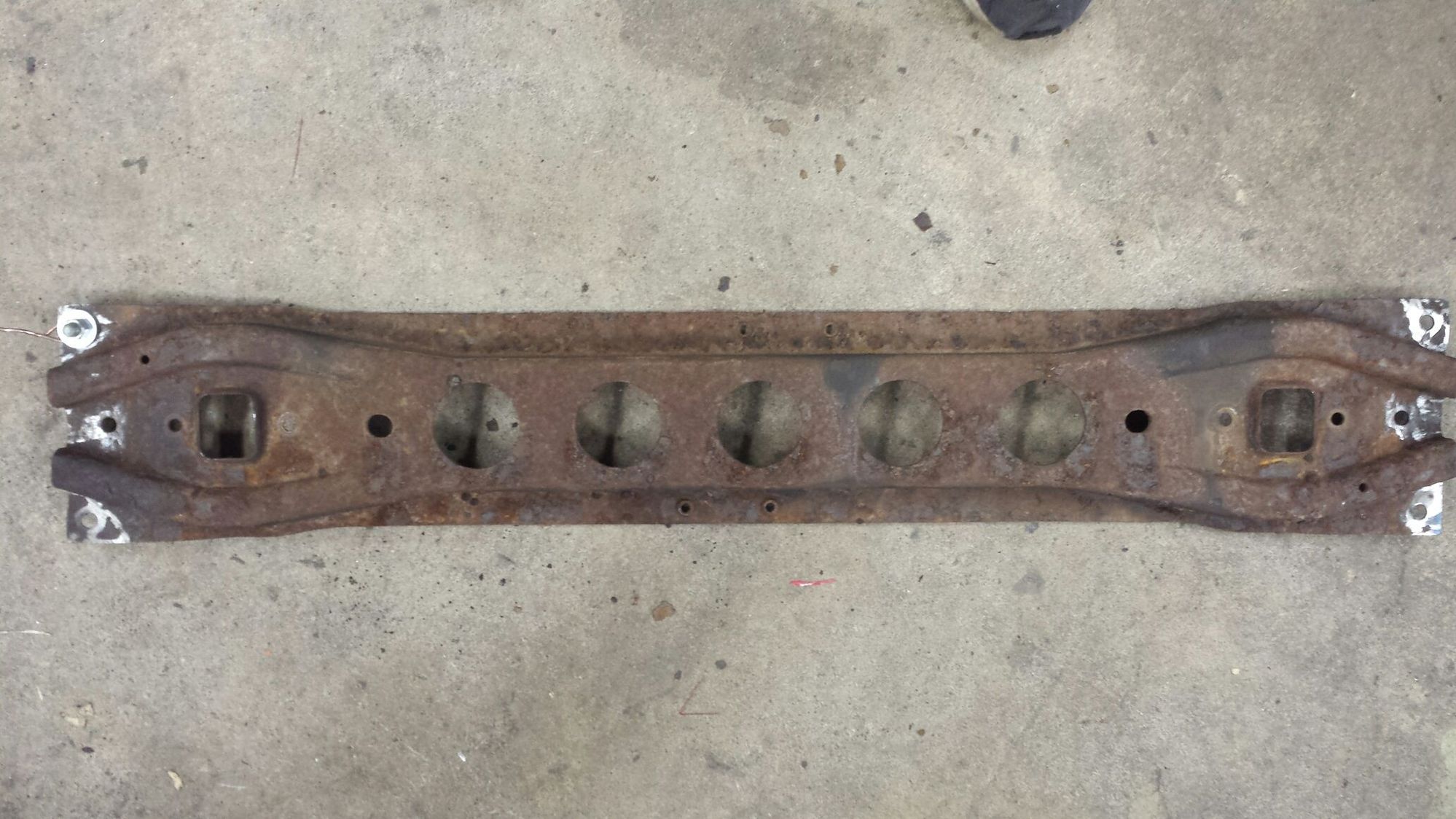

Here is the part when it comes out.
And here is the part after a quick wire brushing

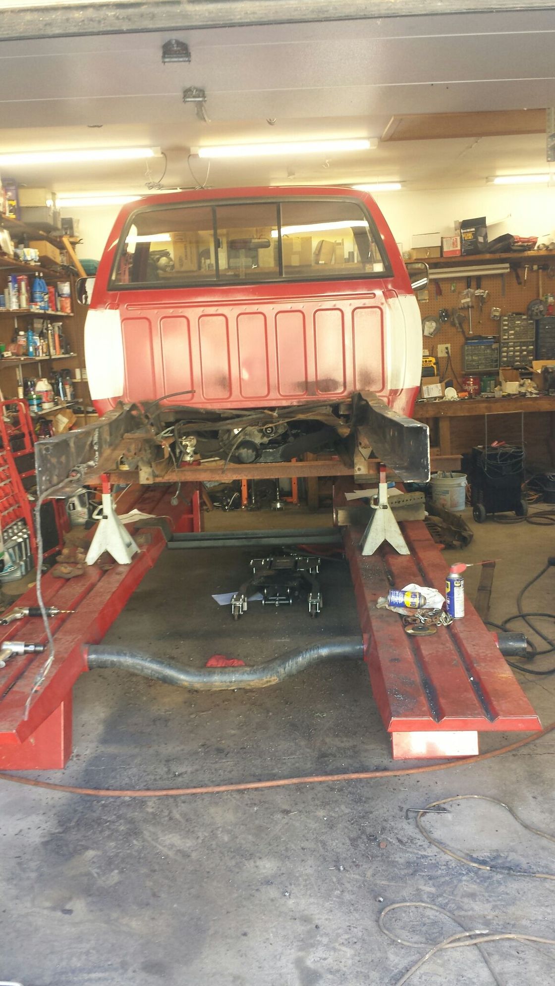

OK, This picture is of the frame rails, cab rearward, cleaned up. I ended up wire brushing, and cleaned the old rust proofing off with gas, etc. Washed and getting ready to apply por-15.
