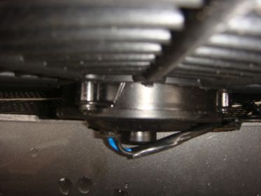

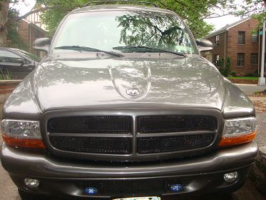

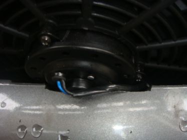

I made a mistake in doing all that unnecessary wiring. I'm gonna order a flex vsc today and eat humble pie. Here are some pics of what I did so far.
#1: Front of my D
#2: Fan info
#3: The notch I had to cut from the bumper plastic piece. I would have set itin the middle but there is a metal piece that is part of the steel bumper support I did not want to cut.
#4: I had to bend the grill out about 1 inch so I can close the hood.
Attached Thumbnails Wiring colors-front.jpg   Wiring colors-faninfo.jpg   Wiring colors-bumpermod.jpg   Wiring colors-fanclearance.jpg

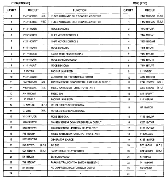

Hey Hydra, here's the links to the schematics:
lv, thanks for the help.

I fixed it up for ya Dan. If you click the button at the bottom of your post you can see how I pasted the IMG codes inside the pot. I went to your account and inserted them for you.
