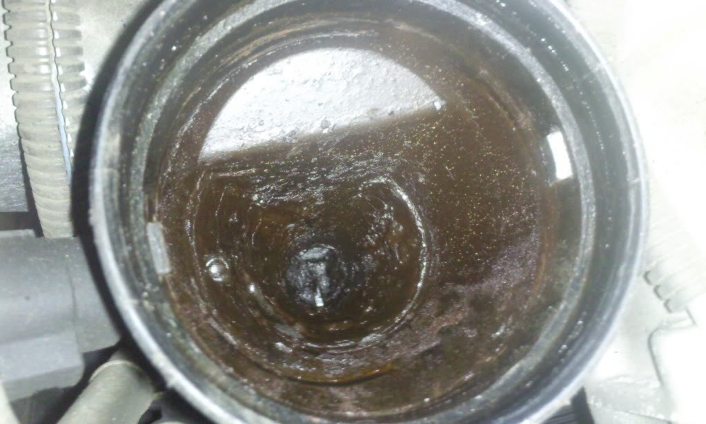

hey ya'll. I wanted to get some input on what ya'll thought this was. I was checking the engine and making sure that everything was ok. I was bored. anyways. I opened the oil cap and found this.
