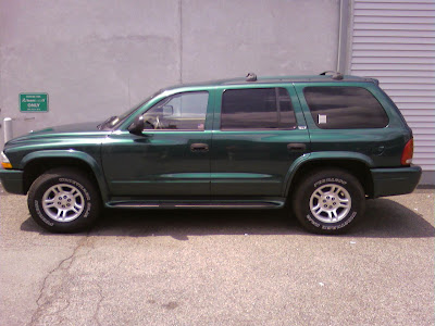

I have the stock 245/70/16... How do the 265's look? Have any pics?
take a look at the pics of my truck
