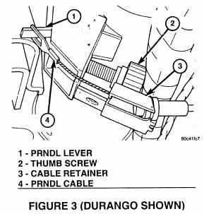

There is an adjustment for the orange indicator under the dash on the driver’s side. It should be tied to the support bracket and is while plastic in color. It is small and has a small round adjustment **** on it. You can adjust the orange indicator to match your gearing.
With that said, your Neutral Safety switch should be on the drivers side by the linkage going into the transmission. There is also an adjustment there for the transmission. I would first replace the switch.

yea i remember adjusting that dial on my old dakota, it would be in 2nd when you put it in drive

Thanks for this - this fixed another annoying thing on the truck !
Stephen
1999 D
