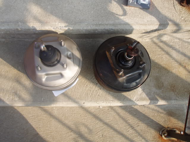

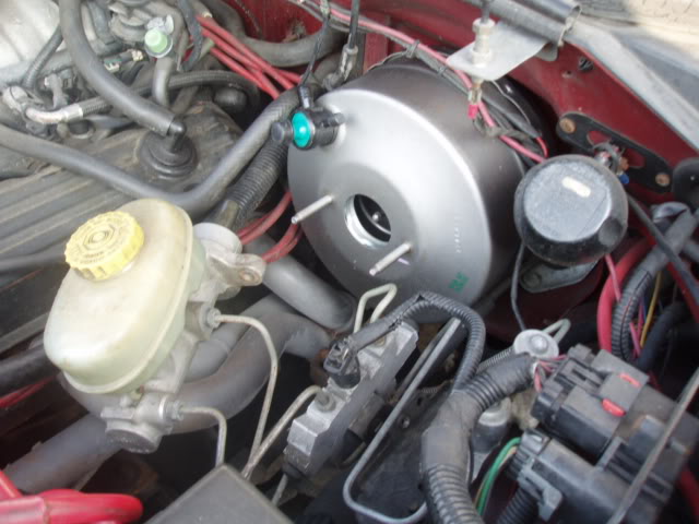

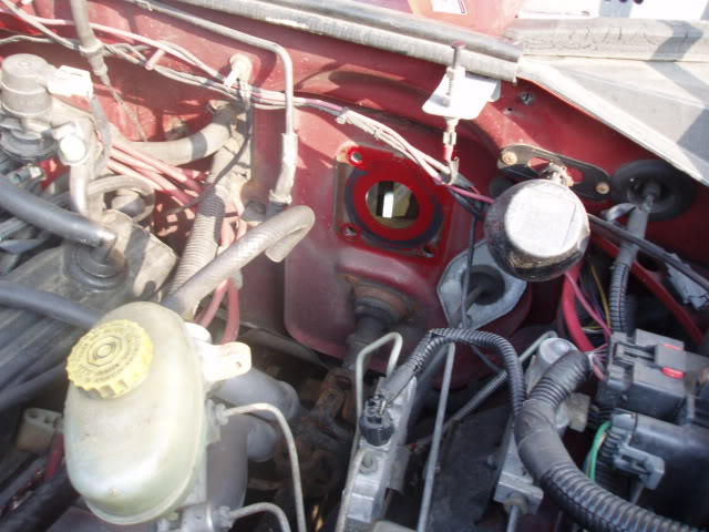

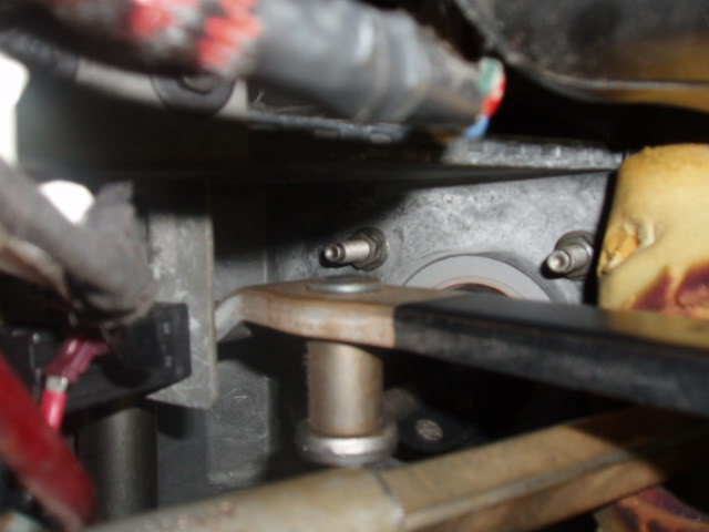

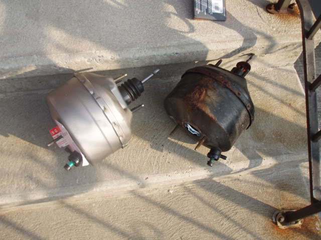

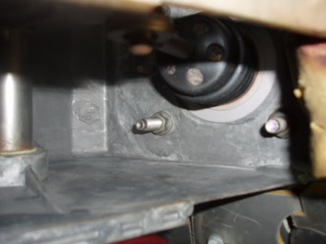

The booster came today, the other items won't arrive until the end of next week. They were shipped from a different warehouse, here's some pics for your enjoyment;
