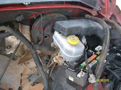

I'm sure it's safe running thru any vacuum line, the brake booster line is just the easiest to use. With the vacuum line vs. just dumping it down the throttle body is, it's more of a regulated flow that way with the vacuum line rather than risking your engine stalling out because it's drowned itself in SeaFoam.
Here's a picture, I circled where you should pull the flexible vacuum line from the hard plastic connector and the SeaFoam should go thru the flexible vacuum line:
yeah that sounds logical. pouring it straight down the throttle body could stall. And my brake booster is setup differently from that but i think i can handle it.

So i went to work and bought some seafoam. I tried pulling the vac line of the brake booster and it didn't wanna slide off nice and easy so i didn't force it.
Any ideas why it didnt wanna come off and would i be ok yanking it off? Shrp sisnce you have the same year and engine the brake booster is right behind the steering wheel right?

the brake booster line should be right where the steering shaft comes through the firewall yes, seafoam will very likely help, but higher octane fuel will 99% of the time eliminate spark knock, even if you only use it for diagnostic purposes, try the seafoam and if that doesnt help fill up with mid grade gas and get back to us.
Yeah i was trying to pull the brake booster line and it didn't wanna come. its pretty much the only line coming off the brake booster going towards the engine block.
