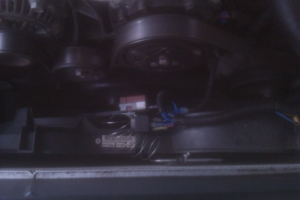

Didn't want to start my own fan thread for one question so I thought is throw it in this fan discussion.
I've read a bunch on here about a fan conversion and wanted to know if that's what I have here. It looks out of place to be stock but this is my first dodge. Thanks for the info
And again sorry about the big pic, don't know how to change it.

99 D's came with a fan clutch and good ol' fashioned metal fan. That is a conversion the PO did since electric assist fans weren't put on til 2000.

Thanks, learning a lot about my new ride here. Does this cool better or were the oem fans prone to failure?

it just unloads the engine a little bit
if you tow the clutch fan is still better.
