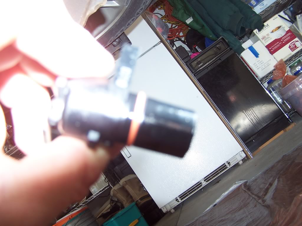

Hey All,
I'll try to make a long story short. Replaced the PCM in my wife's "Rango ('99 SLT, 4X4, 5.9L, Auto). PCM seems to be OK, but after replacement the "ABS" and "Brake" lights are now on.
After using the search function I found a bunch of threads about the vehicle speed sensor causing the "brake light" issue, so I set out to replace it. Went to Auto Zone and got a new one. Well, the sensor location I've been told is at the top of the rear diff, but the sensor that's there looks totally different than the VSS I bought. The one I bought looks like a pipe plug with a plug on one side, it screws down into a hole (it looks like somewhere near the trans). Is the sensor on the diff something different? Do I replace the one I bought or do I have the wrong sensor?
Any guidance would be GREATLY appreciated.

Here is a DIY I made to replace the sensor and yours is the same. It is called the ABS Speed Sensor: https://dodgeforum.com/forum/1st-gen...ensor-diy.html

Well, I got it replaced today (GREAT directions Hydra!!!), the lights came back on again.
Any ideas where I should look now?
