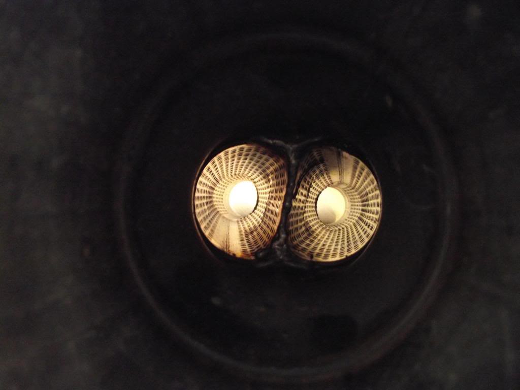

Now Magnaflow on the other hand is a straight through design, however they are not as loud. If you go to the smaller 18" version the sound is louder then the 20" and even softer at the 22" and finally the 24" series. Now they do have a 14" series but I would bet it would sound like a ricer and drone heavily, but who knows? Now I had an 18" on a 84 Bronco (biggest POS I ever owned!) with a 351 and it sounded very respectable. Loud with a good grunt, but not loud enough that the neighbor would want to shoot you, but you most likely will wake them up......LOL
You can completely see the difference in performance with a straight through design instead of baffled:

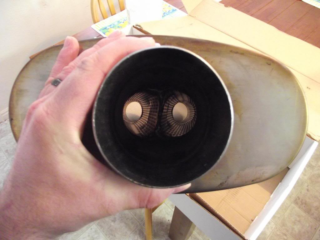

Here is the Magnaflow 24" I installed on my truck. Now it has dual inlet at 2.5" and single outlet at 3.5", but then again I have a V-10. But you can see the straight through design with no back pressure. It is also reversible:
