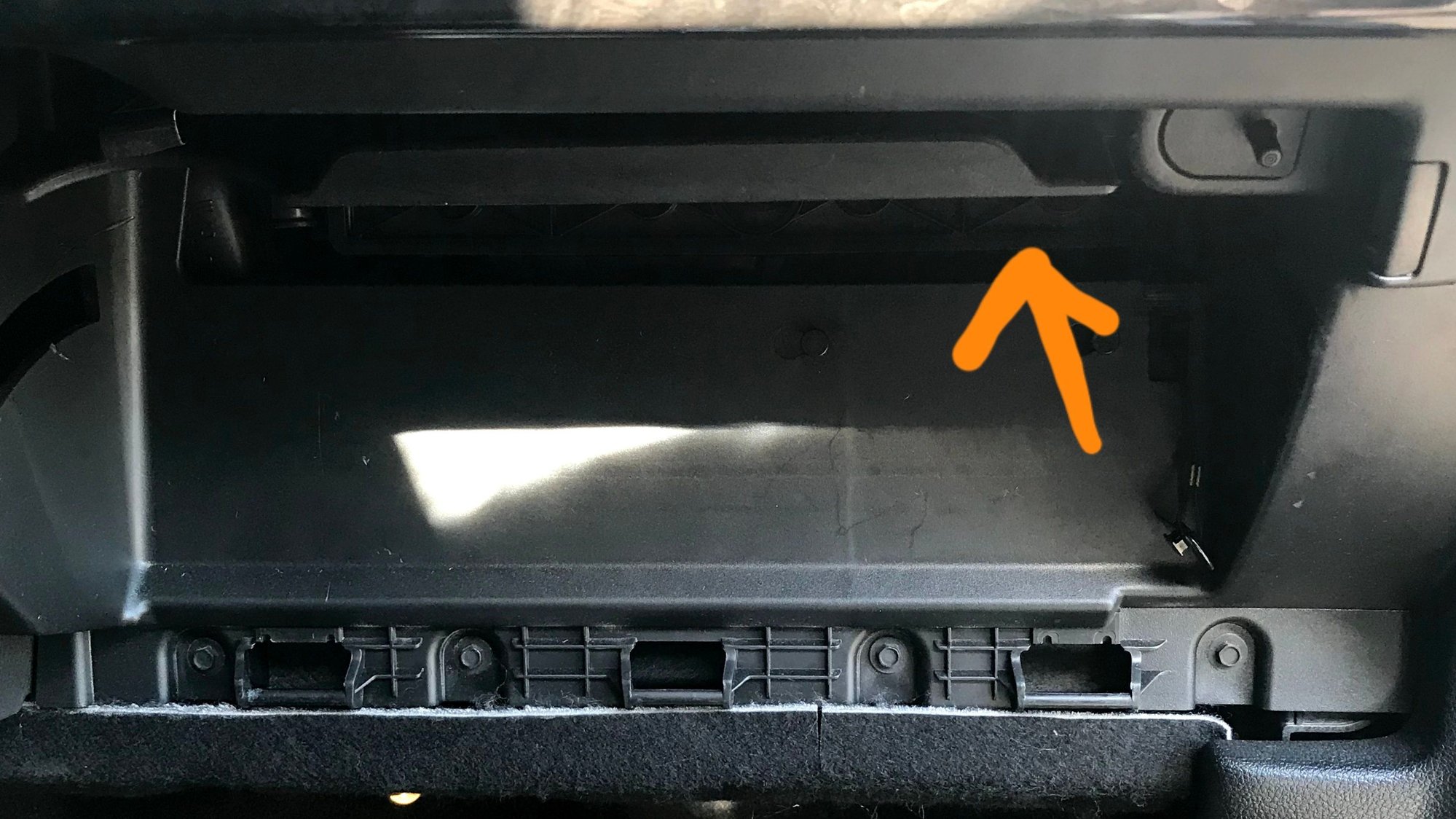

I know this is an old forum, but I'm responding to this comment in case it helps someone currently. There is a cabin air filter in the Durangos. I have a 2015 and it's located behind the glove box. I take off my glove box door to access the filter.

Yours is a Third Gen, this is the first Gen forum. So far as I know, none of the first gens got a filter.
