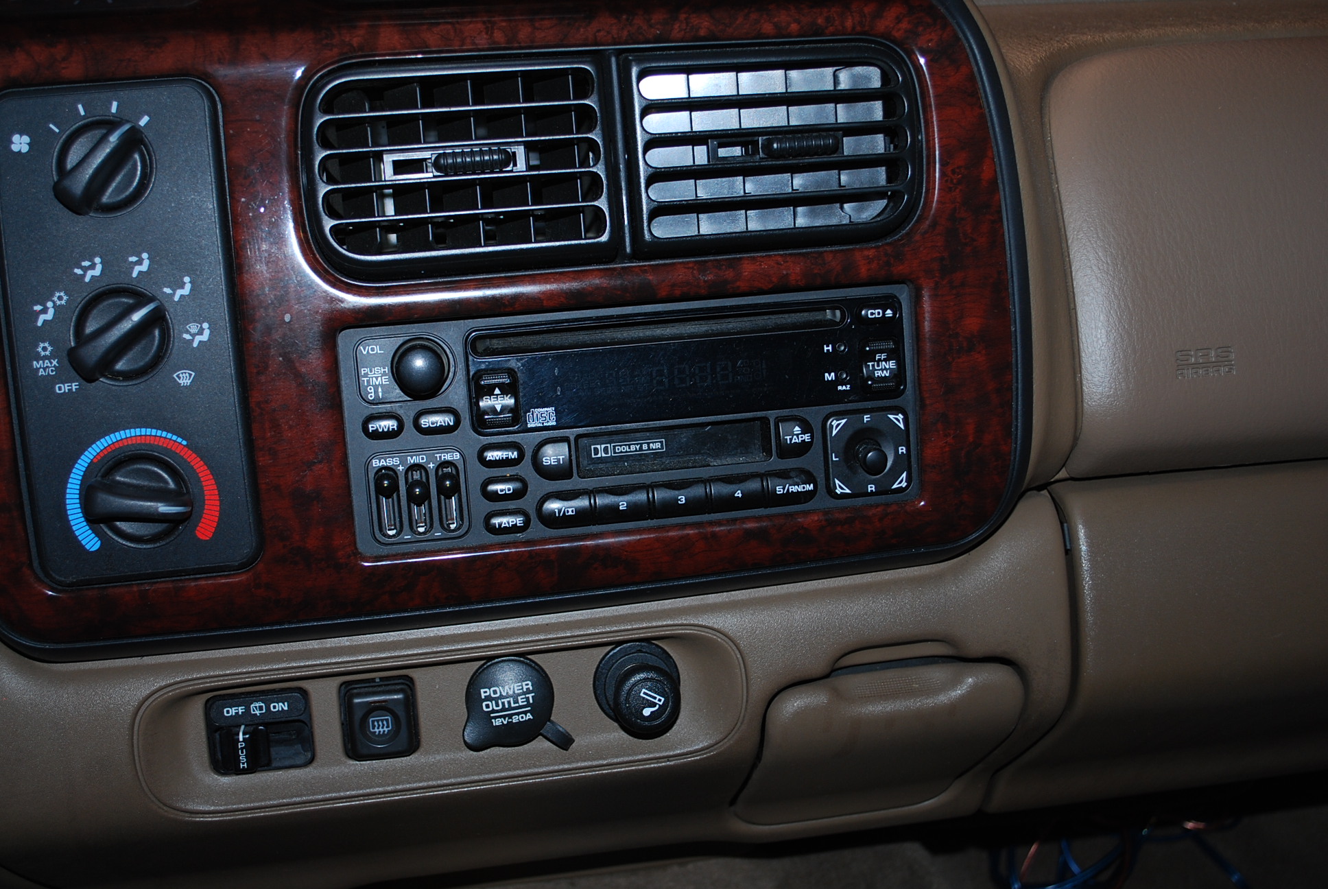

Here is what it looked like when I started

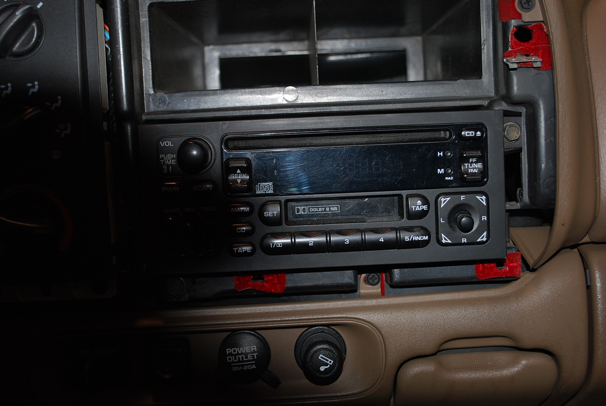

With dash / bezel removed your looking at a stock radio with two screws holding it in
Radio out in a minute and left with a openign a little small for the new double din Kenwood

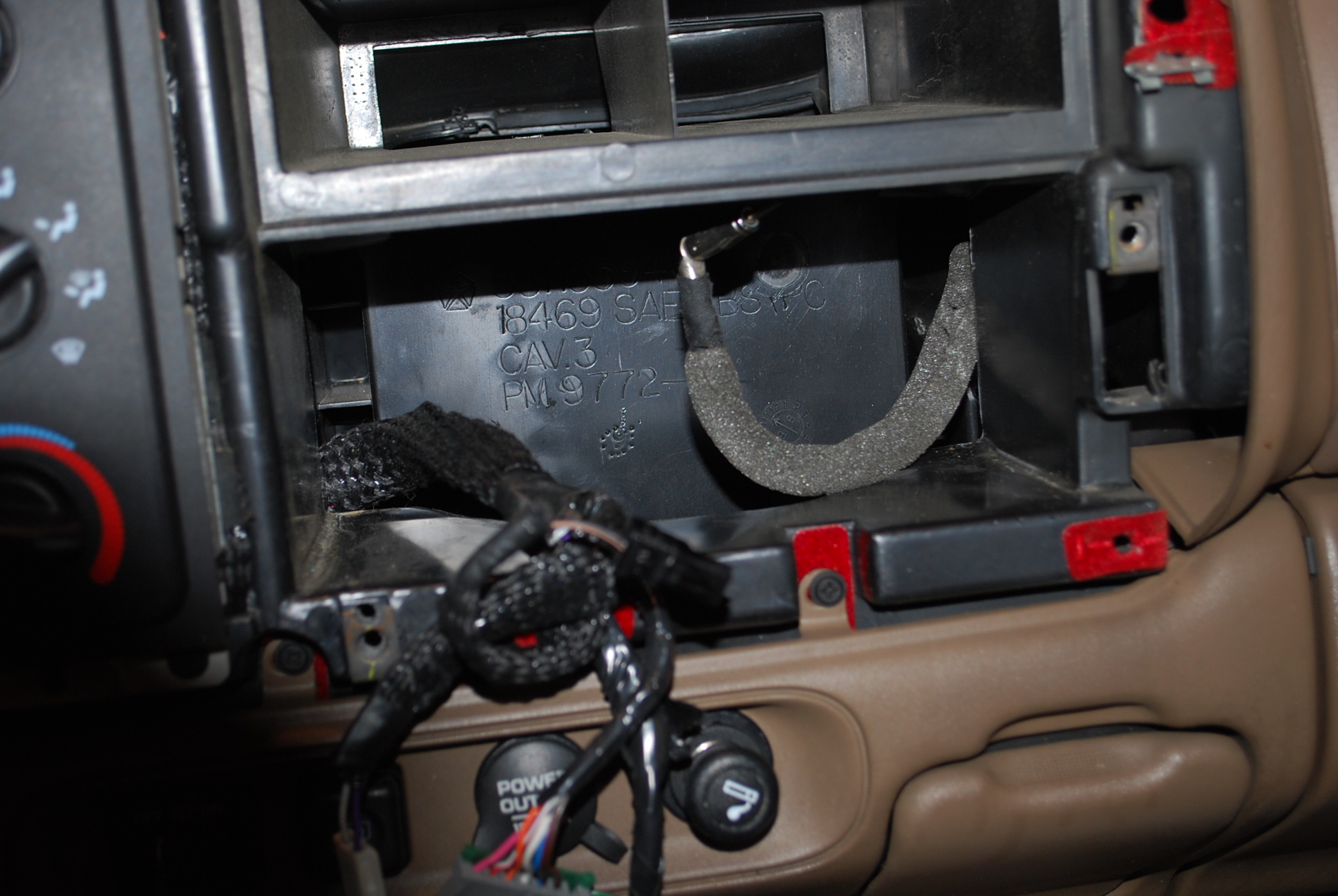

Out comes the air saw and I made some room for the new radio to test fit
With the extra space I slid in the new radio

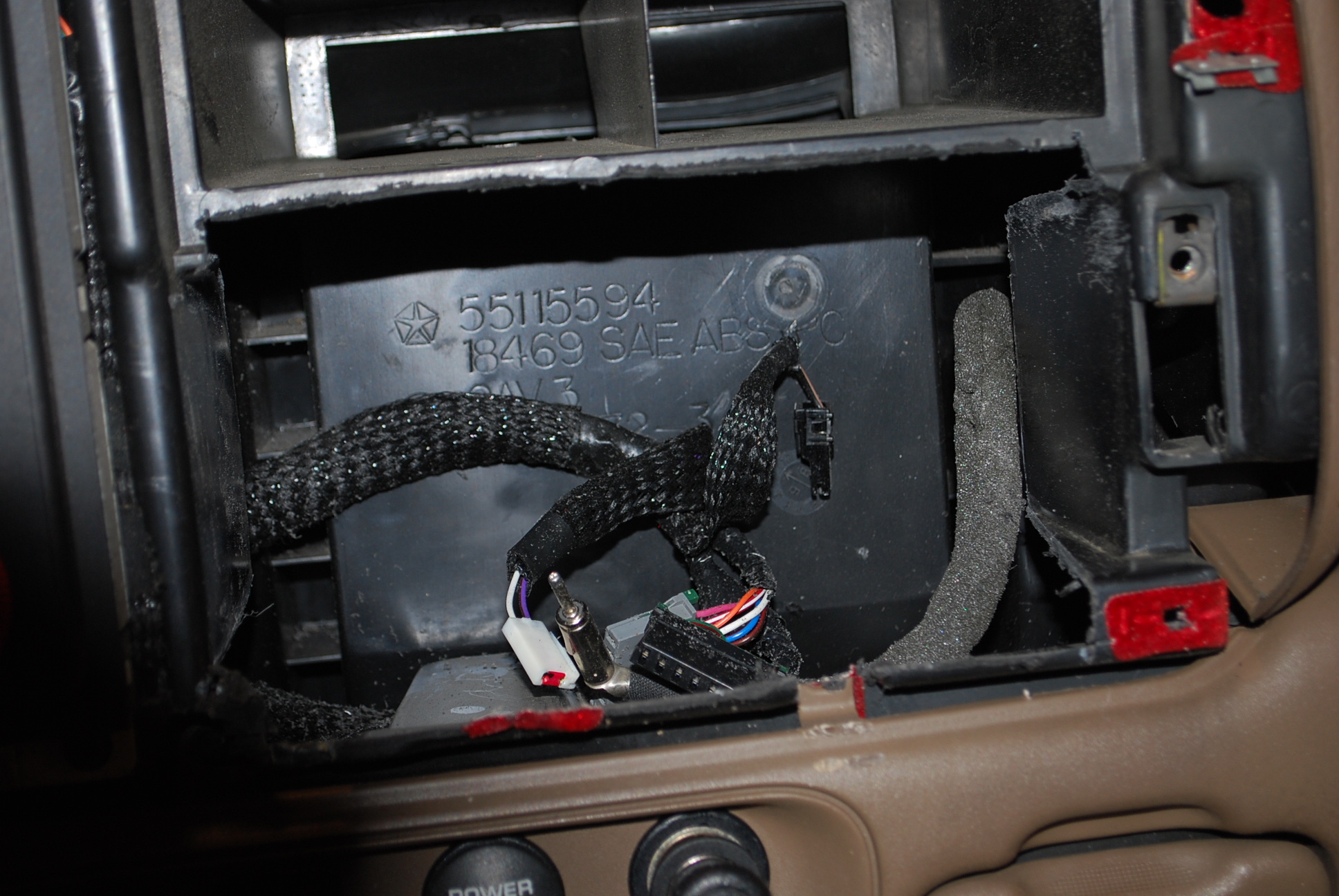

Connected all my wiring and ready for mounting the new head unit.
I used the same brackets we use in all our C5 Corvette double din conversions.
fit perfectly.

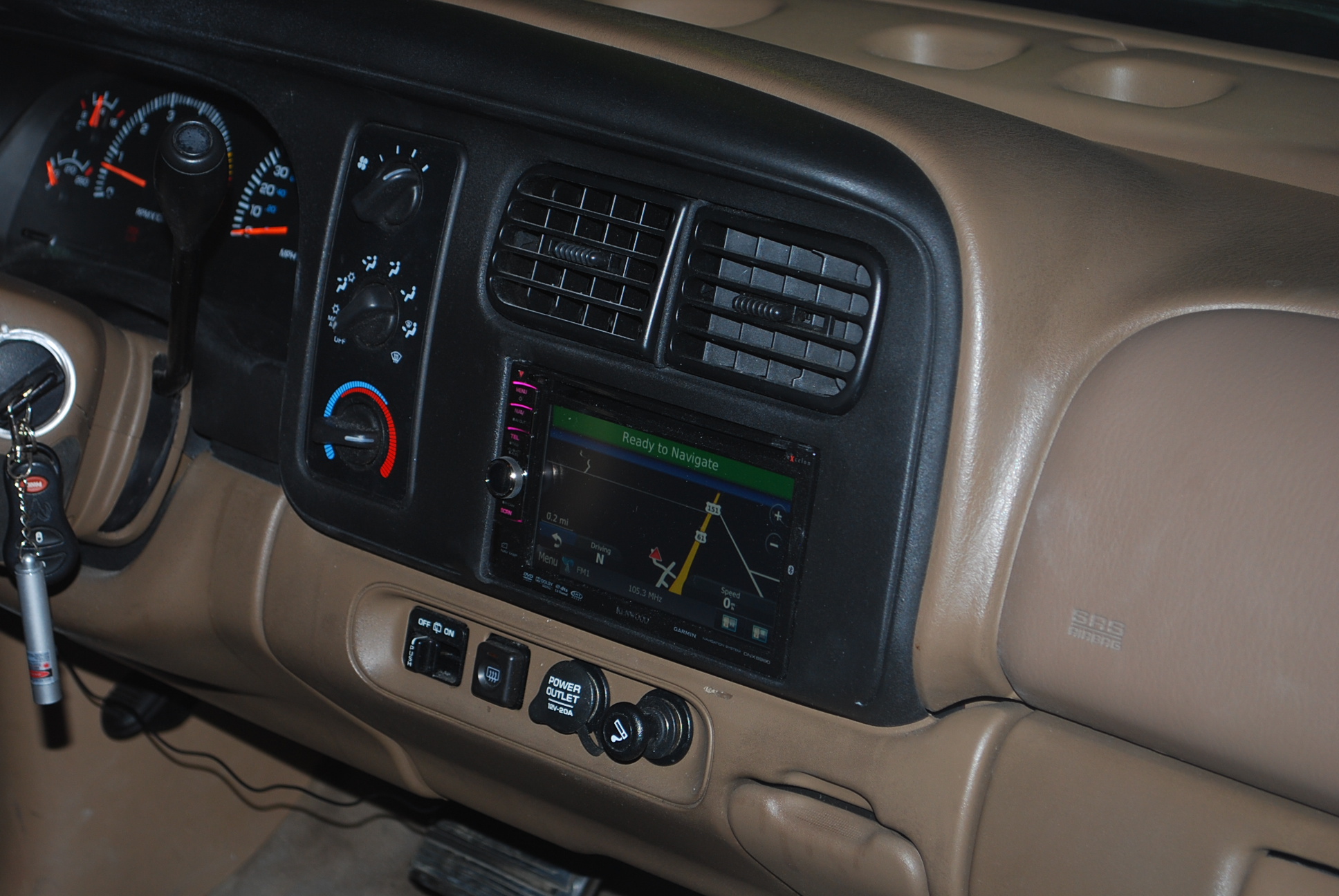

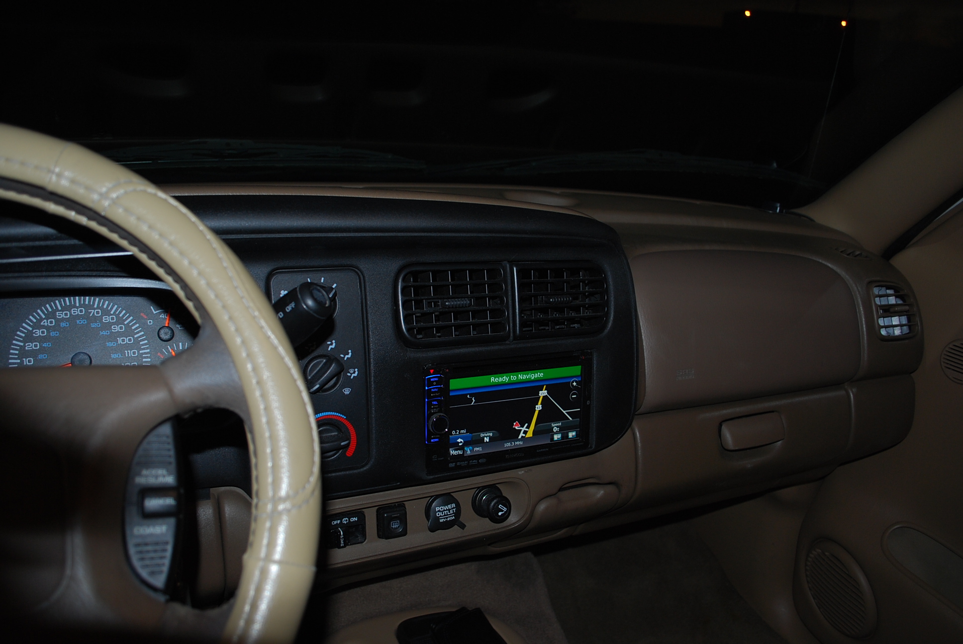

All said and done with the new dash I textured and painted and reinstalled. Its not perfect yet but will be when the final dash piece comes back. It didnt turn out to bad for a days work I must say.
Sure is nice now having NAV, DVD, Bluetooth and Ipod features in the truck. The new sound with all the ARC Audio to go with it sounds really nice as well.
fit perfectly.
