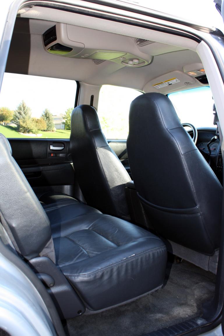

It is integrated with the rear a/c controls, so I think it is an OEM add-on. I should say "dvd player" not entertainment system. You can see it in the attached photo.
