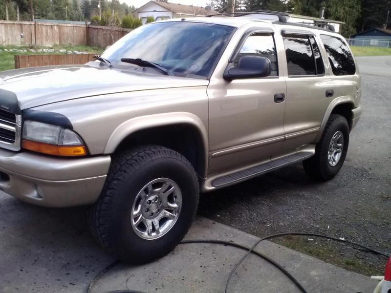

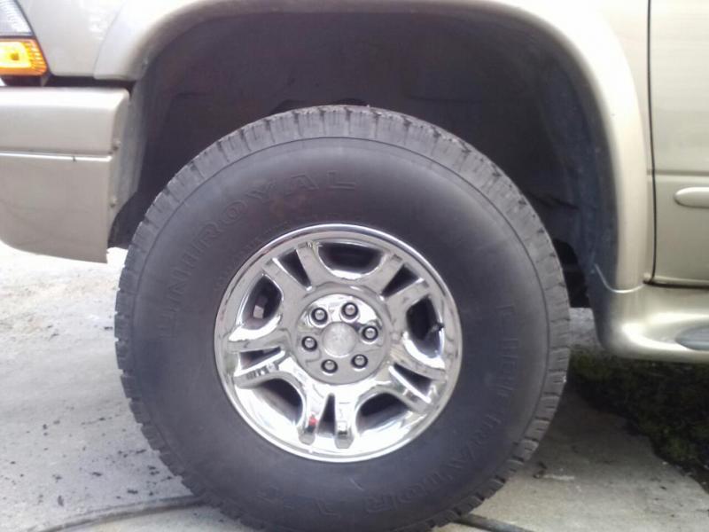

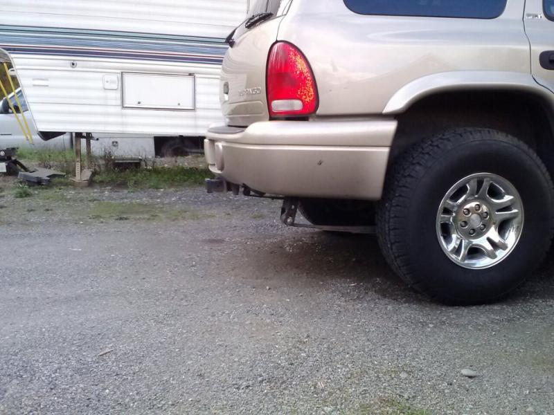

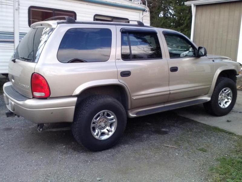

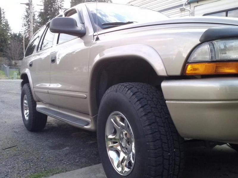

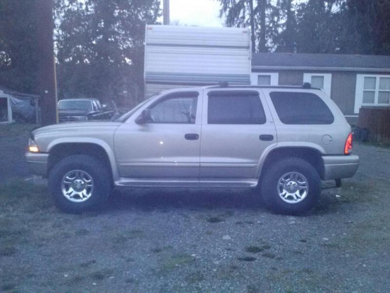

Here are some Pics.
Before, old pic before wheel covers and some other misc add-ons.
b599fdc5-d6ff-4450-a12a-aae15d7ff66f.jpg?t=1363669591
After
Attached Thumbnails 33X11.5 on my wifes durango-durango1.jpg   33X11.5 on my wifes durango-durango2.jpg   33X11.5 on my wifes durango-durango5.jpg   33X11.5 on my wifes durango-durango3.jpg   33X11.5 on my wifes durango-durango6.jpg

Those do fill up the wheel arches nicely. Any rubbing on full lock?
Old Mar 19, 2013 | 10:13 AM
dwblanken's Avatar
dwblanken
Joined: Mar 2013
Posts: 4
From: Arlington, WA
Yes it did rub minimally. I had to trim the lower part of the bumper cover and a slight amount of the inner fender. You can see the trimmed bumper cover in the shot of the wheel and tire. Had I been able to find my heat gun probably could have not had to trim the inner fender at all. As for the bumper cover I would not recommend heat as its painted. The best tool for trimming in my opinion is a 4" angle grinder. Makes for a clean looking cut.

It is hard to tell from the pics the difference in height but that is really what I like about it the most. It looks stock but is 4 to 5 inches taller than others I have parked next to. Thanks for the comments on how clean the trim cuts are, I too am a perfectionist.
