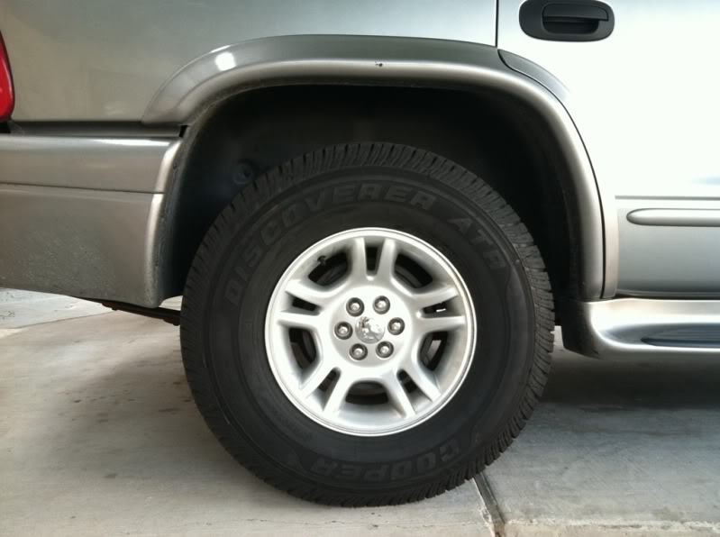

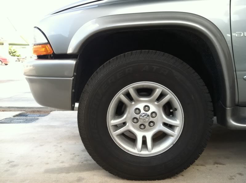

Odd. I run cooper discover atr in a 265/75r16 and I only rub the fender on the pass side when turning left. This is due to a bent bumper brace from a prior accident. Otherwise no other rubbing. Even when loaded with camp gear and dog.
Are you an R/T or 2wd?
I'm an 01 durango SLT plus 4x4.

Originally Posted by PublicHair
Odd. I run cooper discover atr in a 265/75r16 and I only rub the fender on the pass side when turning left. This is due to a bent bumper brace from a prior accident. Otherwise no other rubbing. Even when loaded with camp gear and dog. Are you an R/T or 2wd? I'm an 01 durango SLT plus 4x4.
He's a 2wd. I'm still not quite sure why he's rubbing in the back, but I believe he said it only happens when he was FULLY loaded and on bumps.
