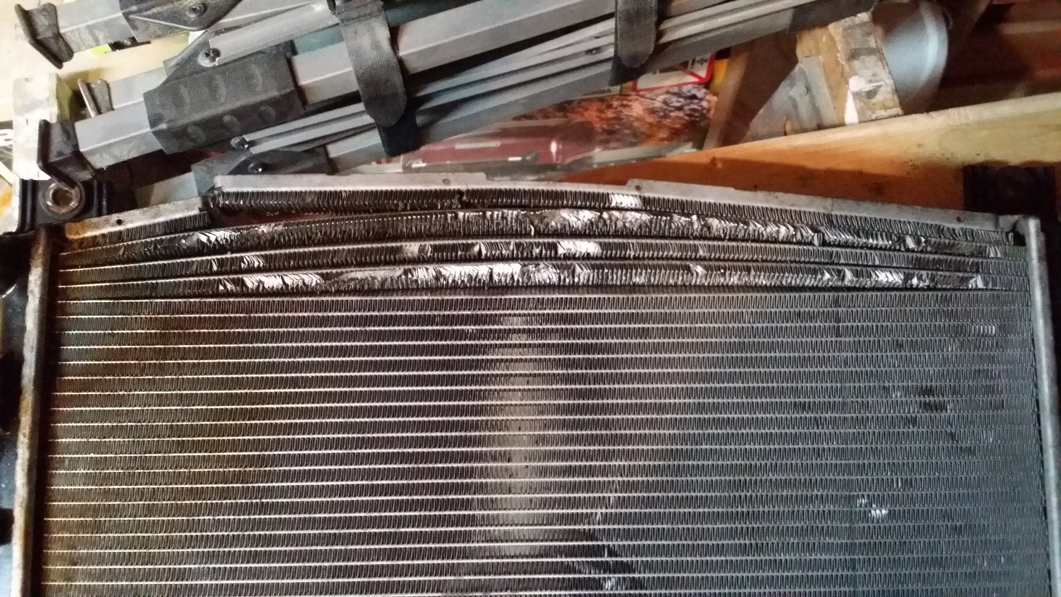

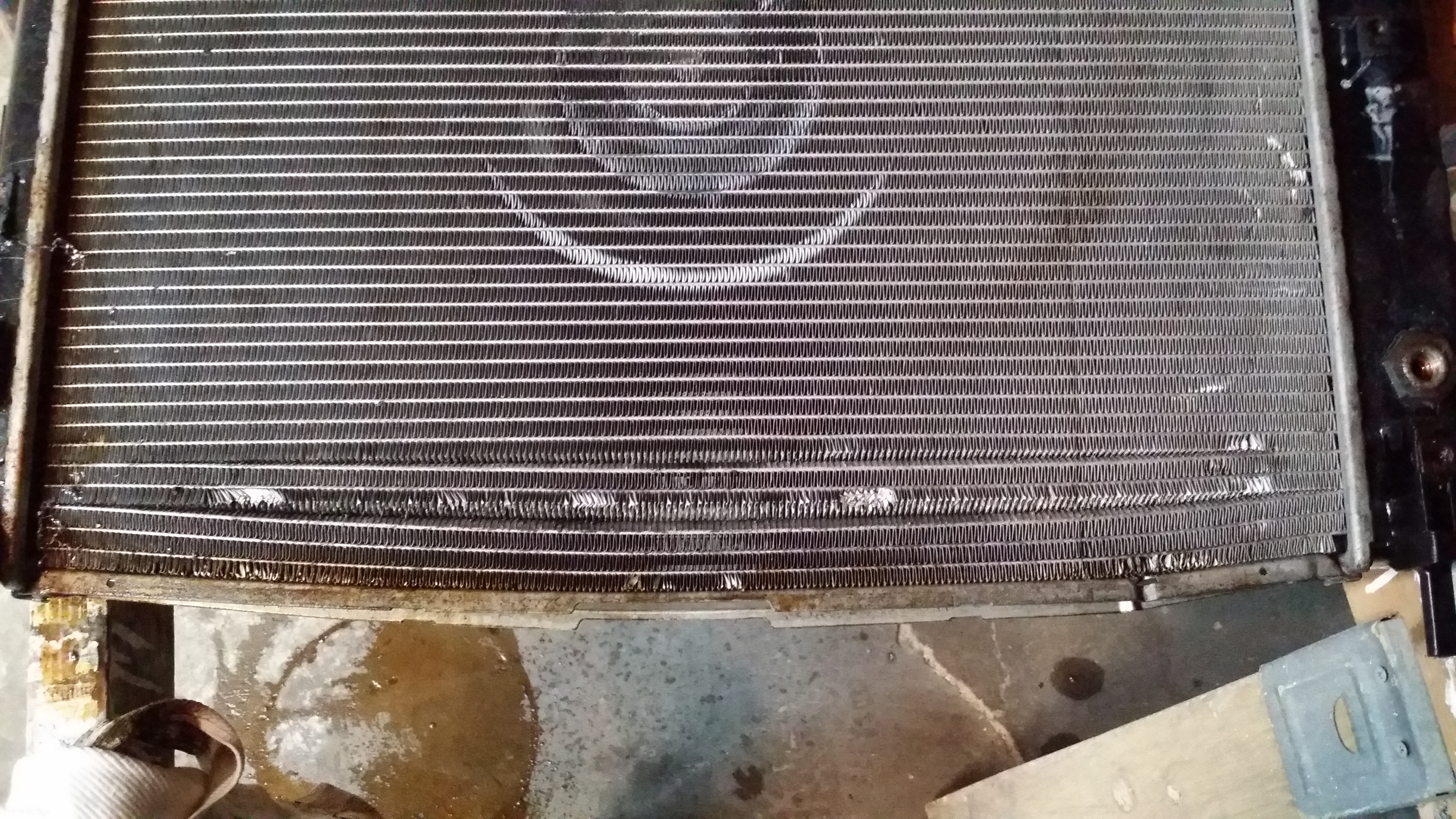

This was bad. Surprised the truck didn't overheat all the time. It never did
Attached Thumbnails New waterpump what else should I do?-20160124_150352.jpg   New waterpump what else should I do?-20160124_150348.jpg
