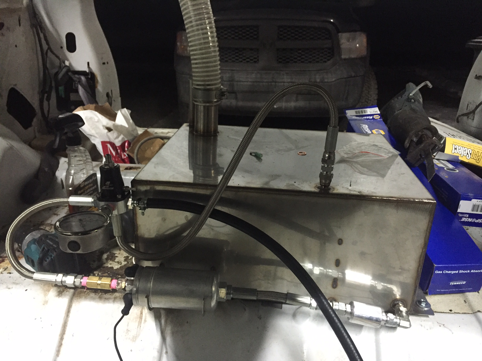

Hi guys, So i just got done installing my new set up for the fuel tantk. new stainless steel tank inside the truck with a new strainer, new external fuel pump, fuel regulator and new fuel lines. The pump is pushing 50 psi ( tested at the regulator, about 10 feet before the fuel rails. The truck is doing the same thing as before. It runs for about 3-4 seconds, somethimes longer than shut down. Any idea guys? Should I change the injector or what?

here's a picture
