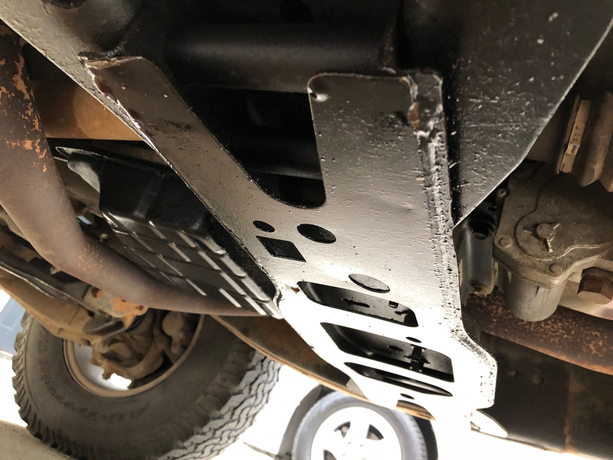

Default Does this look like a transfer case leak?
Just purchased an 08 Dakota Crew Cab. There is a slow leak, the skid plate is covered in oil... don't know a ton about trucks... but was hoping to gain some knowledge before I take it in to the shop. Appreciate any pointers you can offer.
Thanks

Posts: 87,479
Invest in four of five cans of brake cleaner, and clean everything up good. (wear goggles, and a mask, that stuff is bad for you. doing it outside isn't a bad idea either.) See if you can isolate where the leak is coming from.
Don't use an impact on the fill plug..... might break something. (read that: Expensive lesson.) Get an allen head socket the right size, an appropriate extension, and a breaker bar to get it to break loose. After that, it comes out easy.
