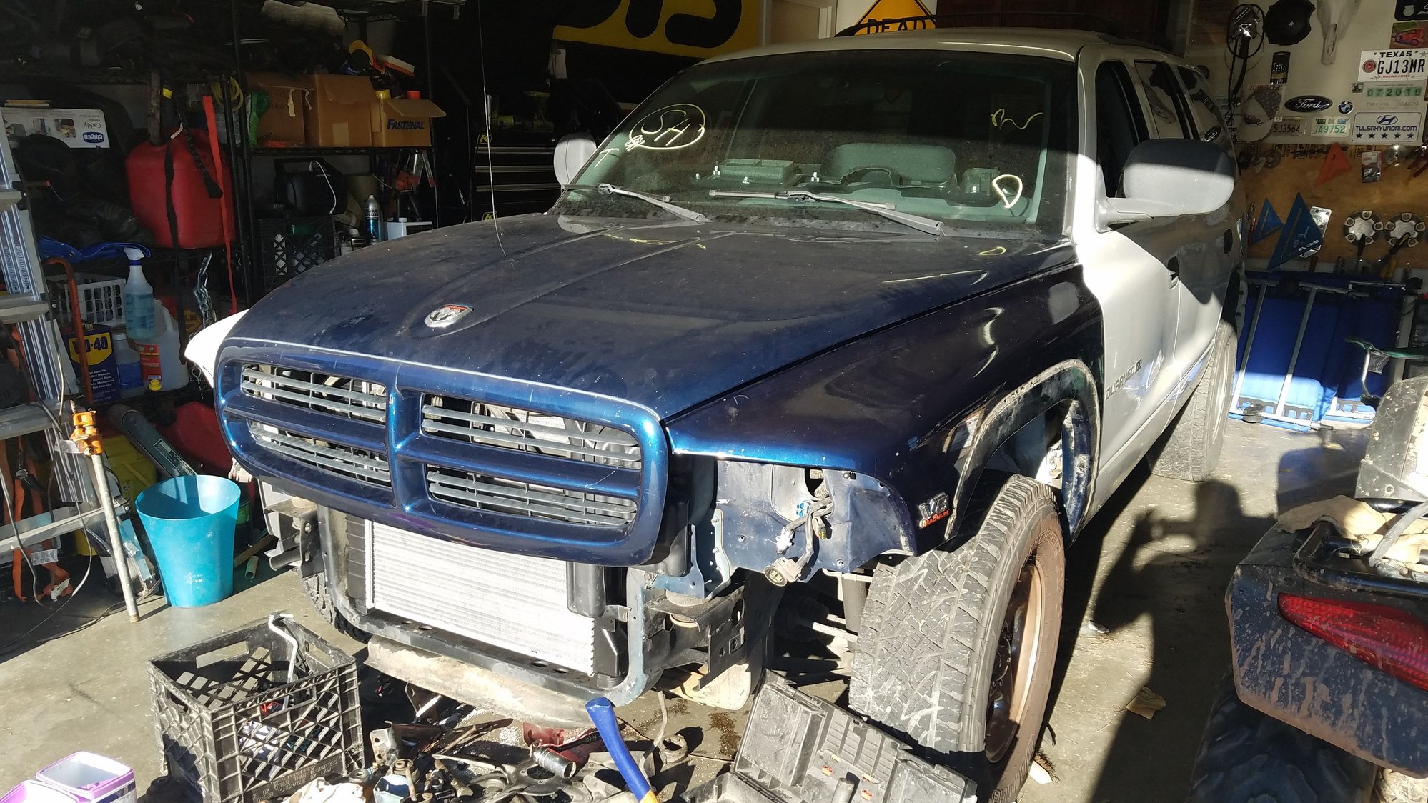

I guess I "needed" another project...
About a year ago a buddy of mine gave me a Durango. He really didn't want to look at it sitting in his driveway anymore and was too cheap to have it hauled away, so he "gave" me the truck. It's a 2000 SLT with 200K miles, leaky transmission and bad bottom end knock. Fast forward to last week, a 1998 Durango with 128K miles shows up at a Copart auction in my town.
Looks good, has "small" front end damage, it says "runs and drives". I pulled the trigger and after all the obnoxious fees I got it for $670 ($425 for the truck + $245 buyer premium, loading fee etc.).
Here's what it looked like at the auction:
After I got it home it turned out that it didn't really run and drive. The fan was stuck in the radiator and there was a lot more damage than disclosed.
After I removed the radiator and both coolers I saw the extend of the damage. First I had to deal with pinched transmission cooler lines:
As you can see the frame rail was tweaked, too.
So far I have replaced: radiator, left fender, radiator support (the U shaped hydroformed thingy), fan, crankshaft pulley, battery tray, fuse box, overflow reservoir, hood and got the transmission lines fixed. I also cut and beat the end of the frame rail back in place.
It starts and runs without overheating. Today I will take it for a spin and see if it shifts okay and drives straight. After that paint prep, paint an final assembly.
This is what it looks like now:
Here's the cost breakdown so far:
$670 purchase price
$70 radiator
$32 salvage yard shopping spree (Overflow tank, fan, pulley, dipstick (I broke the original), battery tray.
$6 hose clamps.
Total: $778
I also got the hood, fender, fuse box, radiator support, radio (gotta have a CD player) from my "free" blue Durango.
I already have paint (it's a Toyota crystal white), but should be better than blue, so if everything goes well, this thing will be on the road in about a week.
