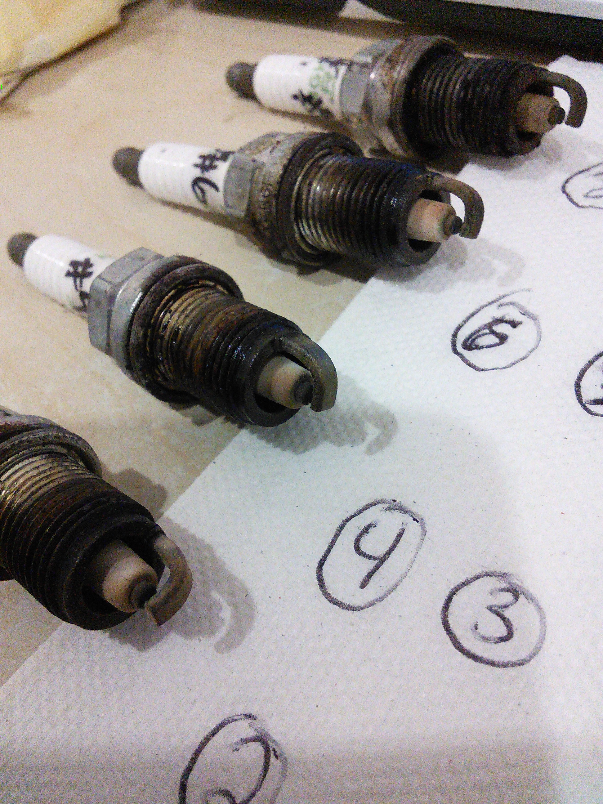

Here are some photos of my old plugs, they all look alike except for the 1 & 3 plugs.
Burning Oil After First Synthetic Oil Change (Photos Galore)-img_20171106_182949.jpg Burning Oil After First Synthetic Oil Change (Photos Galore)-img_20171106_190024.jpg Burning Oil After First Synthetic Oil Change (Photos Galore)-img_20171106_190035.jpg

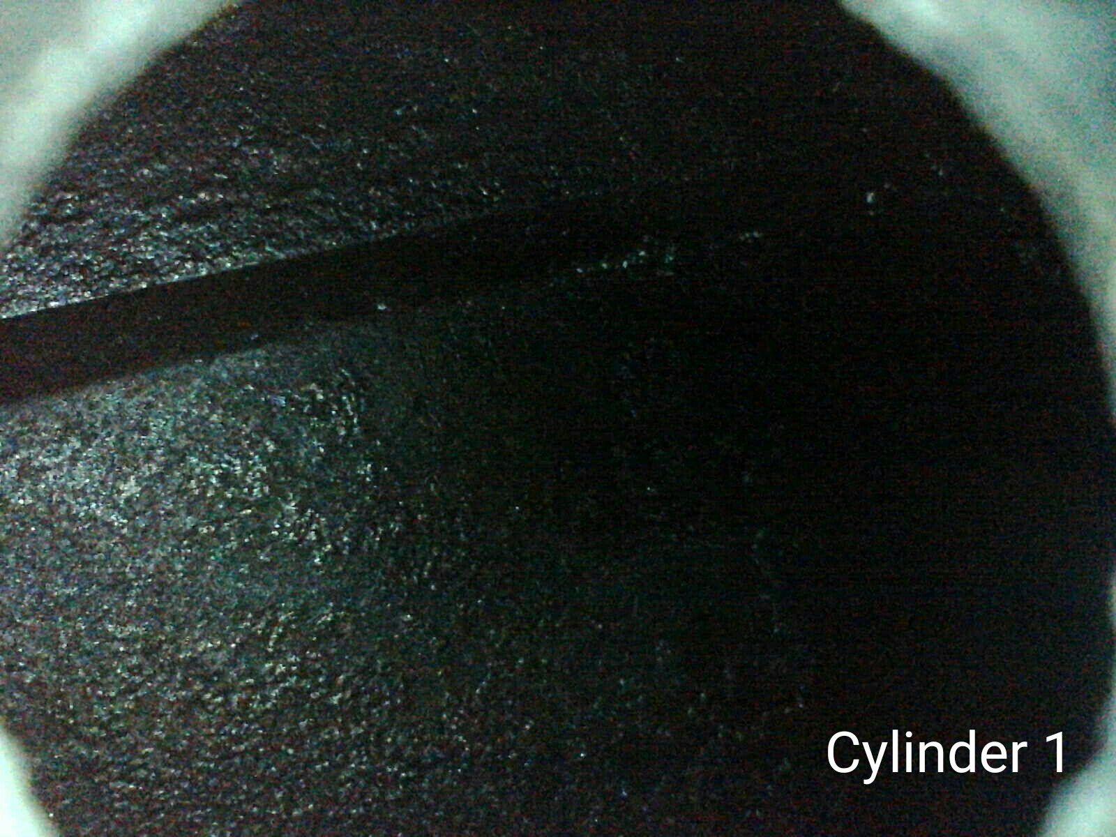

Boroscope shots of inside cylinders 1 3 5 7:
Burning Oil After First Synthetic Oil Change (Photos Galore)-2017-11-06_18.41.05.jpgBurning Oil After First Synthetic Oil Change (Photos Galore)-2017-11-06_18.40.20.jpgBurning Oil After First Synthetic Oil Change (Photos Galore)-2017-11-06_18.39.32.jpgBurning Oil After First Synthetic Oil Change (Photos Galore)-2017-11-06_18.38.17.jpg

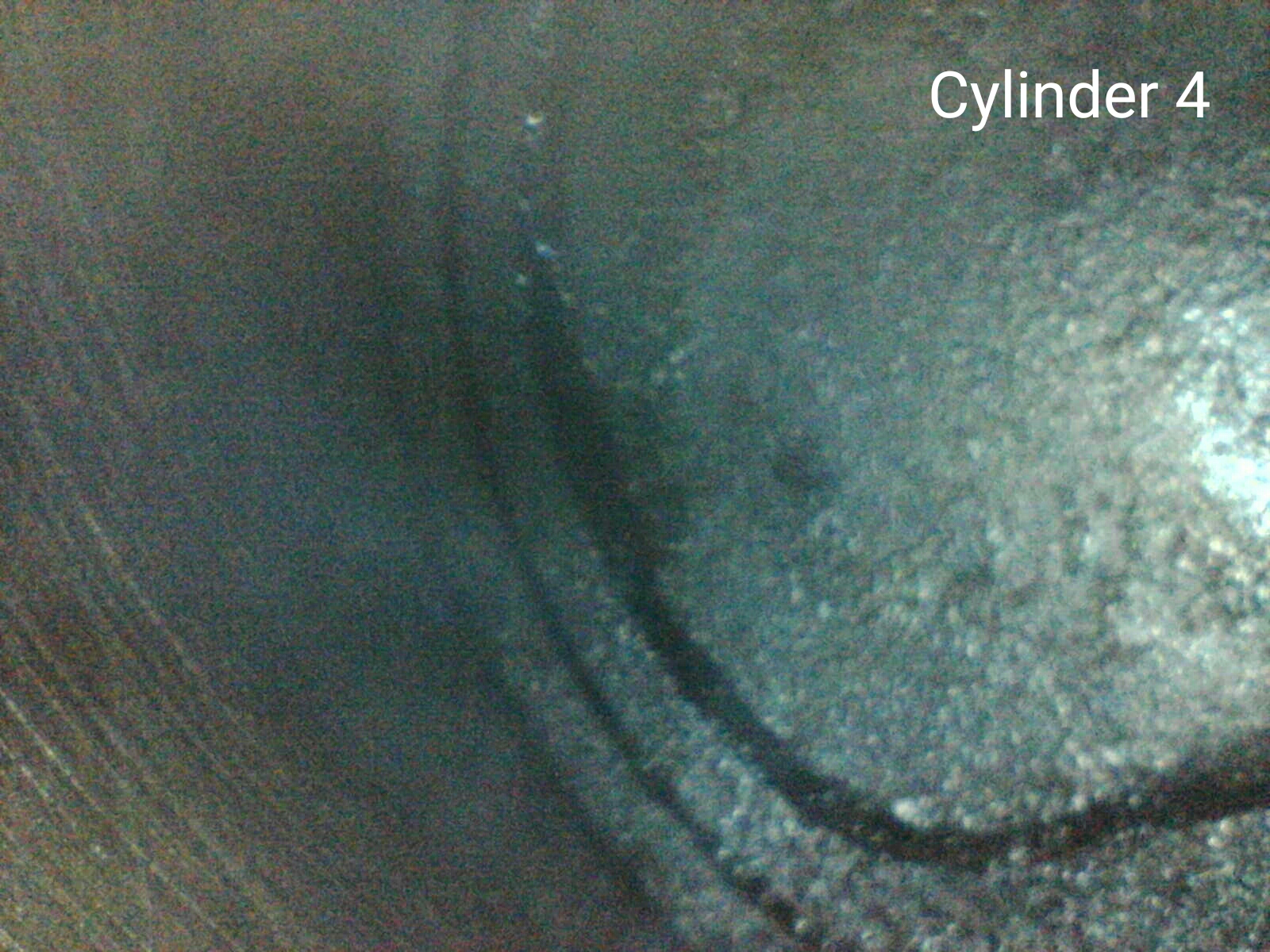

2 4 6 8:
Burning Oil After First Synthetic Oil Change (Photos Galore)-2017-11-06_18.37.36.jpgBurning Oil After First Synthetic Oil Change (Photos Galore)-2017-11-06_18.36.59.jpgBurning Oil After First Synthetic Oil Change (Photos Galore)-2017-11-06_18.36.13.jpgBurning Oil After First Synthetic Oil Change (Photos Galore)-2017-11-06_18.34.33.jpg
The 8 cylinder to me looks like it has some oily residue, that could be the light within the boroscope I am not sure. But as I mentioned earlier, I am wondering if oil from the valve covers could made it way into the spark plug grooves and into the chamber?
Regardless, I have a ton of carbon on the heads, need to attack that problem next. I'll be monitoring my oil closely as well. I haven't done a compression test yet but now I am thinking I should.
