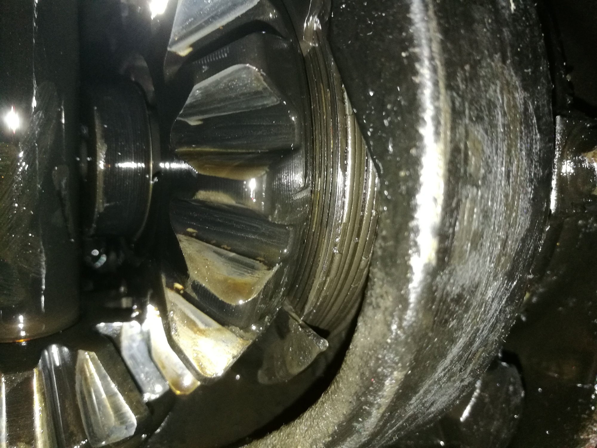

I did some research and it looks like will have to remove the heatshield on the passanger side behind the exhaust manifold to access the AC drain and to install a piece of hose to direct the water away. Didn't do that yesterday, the car was hot, so I changed the rear differential oil (2 quarts of Mobil 1 75w90 with a 2oz bottle of limited slip additive. The main reason of doing that was the leaking rubber plug- the cover was oil wet, and to see exactly where does it drip from I went to a car wash, sprayed over some engine degreaser, let it soak for 10 mins, washed it and it was nice and dry. After a couple of days I noticed an oil wet mark around the rubber plug. The cover was set on silicone, so I cleaned it out with a blade plus wire brush and set it on gasket.
Most important though was to find some metal parts attached to the bottom magnet.
Is it safe ro drive it like that? Anybody had that kind of experience?
There is the pic of the parts and where supposedly they were coming from (big metal washers behund the side gears, on both sides).

Safe is a relative term. While I would not expect a catastrophic failure with that damage, it is possible. Those shims center the differential and keep gears aligned with the pinion. It will definitely wear out sooner than later, you could pull the pinion and replace the shims, that is what I would do.

Those are your ante slip clutch packs, and your clasps are broken. I did a write up on how to repair them in the DIY section. Check your ABS sensor on top the axle, when it broke on mine ot took it out and all the wiring webbed in my differential.
Differential
Rebuild For Trac-Lok Limited Slip Differential
https://dodgeforum.com/forum/1st-gen...c-lok-lsd.html
https://dodgeforum.com/forum/1st-gen...lp-please.html
https://dodgeforum.com/forum/1st-gen...n-my-diff.html
http://www2.dana.com/pdf/X5001-CVSP.pdf

Thanks a lot for the info! Just finished to read the threads, also watched a few youtube videos on how to rebuild the diff and rear axles.
Daaaaamn... It was supposed to be an easy fixer/ training vehicle... Not sure what will do for the diff- I'm living in an apartment complex and I can perform some simple fixes but can't tear apart half of vehicle. I've got caught two weeks ago by the apts owner with the back jacked up, I was cleaning the inner side of rims and painting the drums and it went with a warning. It's my daily driver for now, almost finished (still have to fix a bull eye on the windshield, change the oil and oil pan gasket, fix the blower resistor with harness and perform some deep cleaning ).
