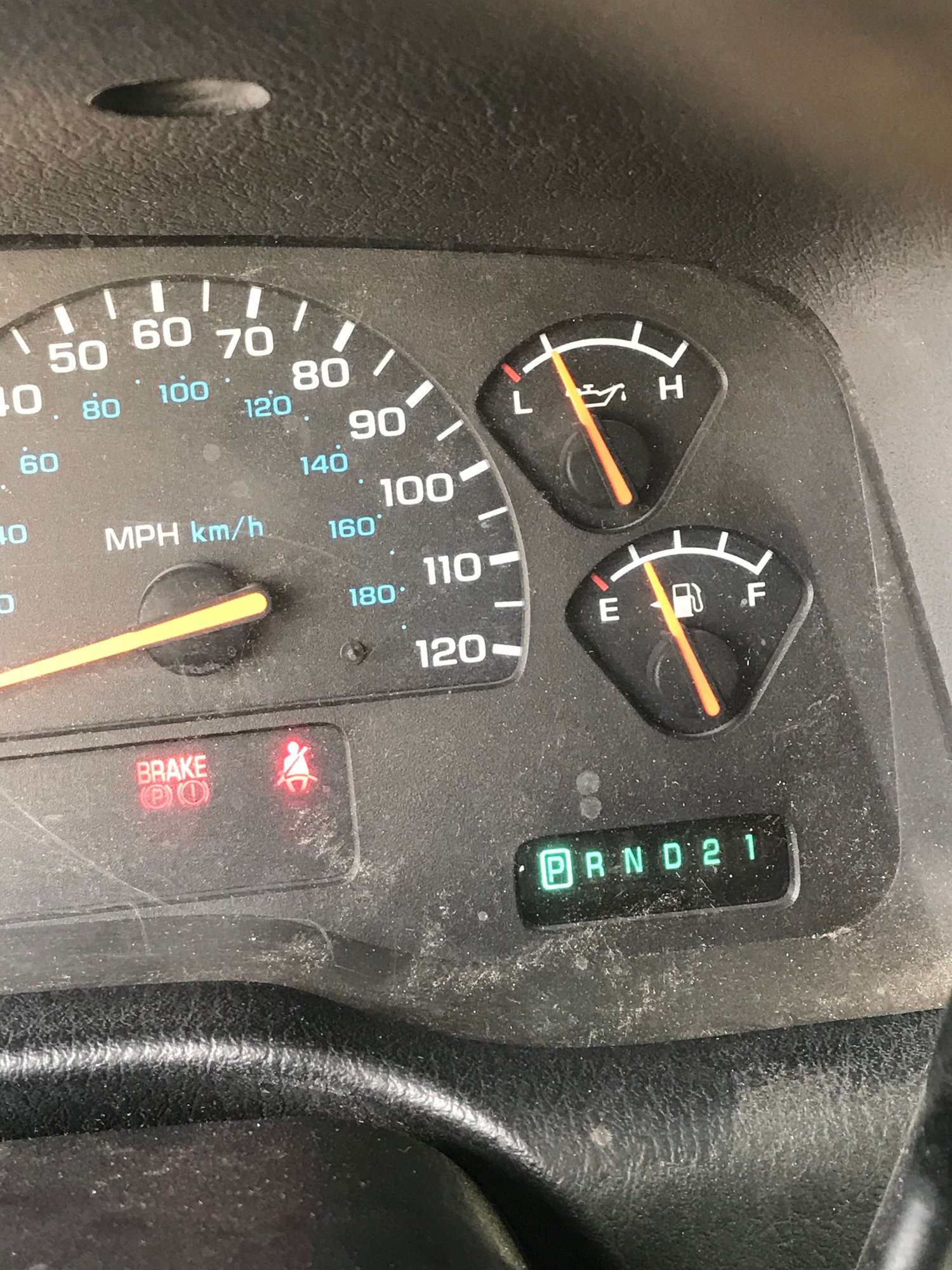

on the oil pressure drop, either change the oil pressure sender or put a mechanical gauge on it, (id t in a mechanical gauge personally) but you need to be sure thats not actually dropping off if you want your engine to last. (there have been some rare occurances of oil pressure issues in the magnum engines, usually related to poor maintenance)

A lot of the parts store oil pressure senders are complete ****. I replaced my original one with one from the parts store (might have been a standard part) while I had access when my intake was off, and within days it dropped down to zero then came back up. Put another one on (managed to break my original one) and it's been fine since.

So In between jobs I decided to replace the oil pressure sender from the only one AutoZone carried (damn $40 bucks!). And I didn’t see a difference.. Still drops all the way down every now and then and only, when I make a complete stop. Again, it only lasts for a second if that but it is, concerning me. Wishful thinking is just bad part from AutoZone... I have attached a picture of what the idiot gauge shows. It never moves, whether when flooring the gas, or in park, just stays the same. I have considered installing a separate gauge, which was recommended above, besides running wires(which I find very easy to do) where-a-bouts do I hook it up to? T splice at the sender?
