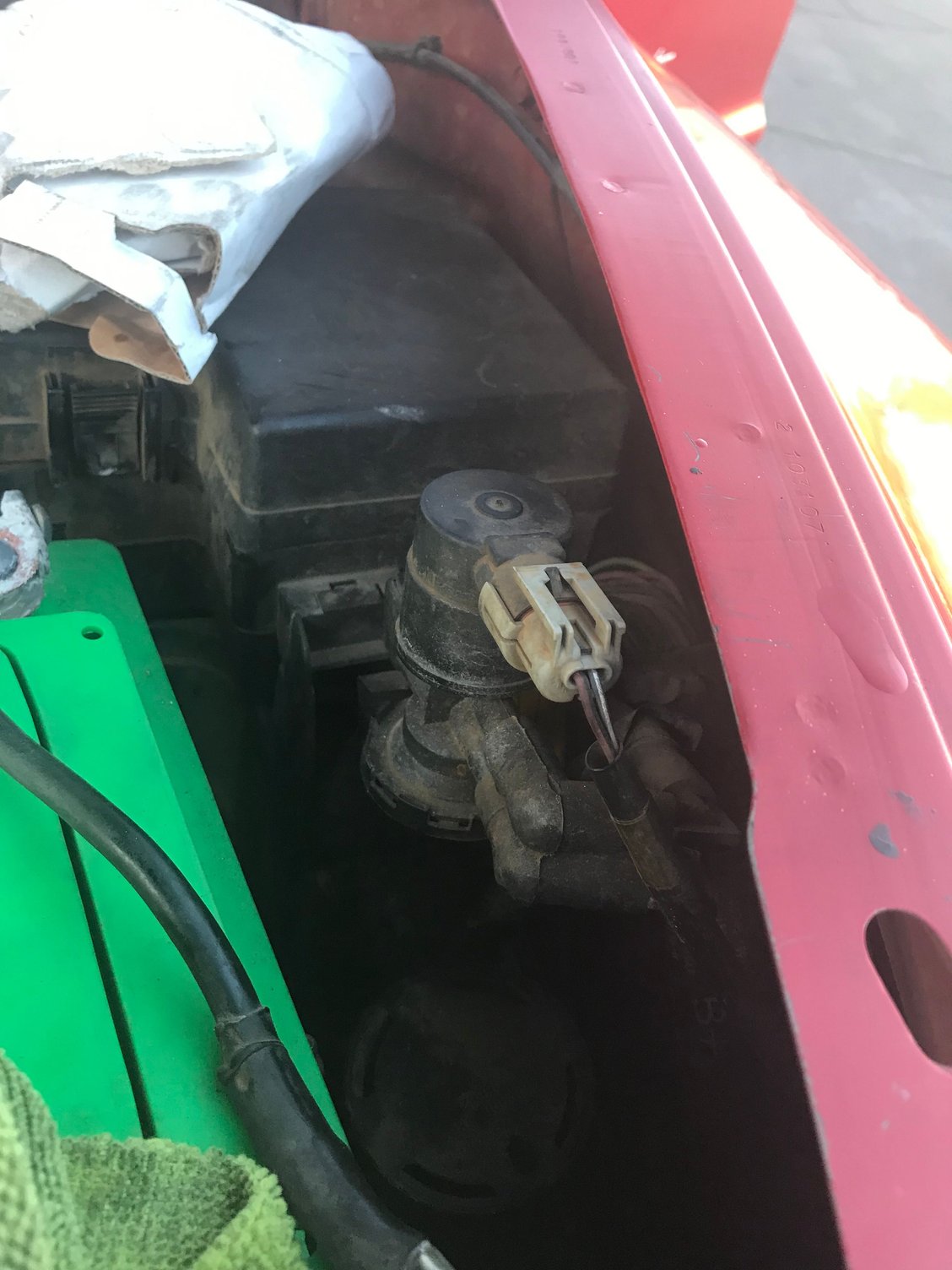

Did the oil change today. Oddly, only about 2 quarts total came out. Beforehand, I took a drive to warm it up. I even let it drain for about an hour. I believe low oil was my problem despite the dip stick being fine. I put in exactly 5 quarts. The dummy gauge is now at half way mark when driving and it goes down to the line just like the picture I posted above when I sit at a light. Drove it a good bit after this and it didn’t drop low at all. Along with this, I don’t hear any ticking coming from the manifold area.
I did notice anothwr tick tick somewhere else and I actually do not know what this part it. All i know it’s next to the battery. I’ll post a picture of it. If I put my hand on this, I feel the “tick” so to say. Am I making any sense? Lol.

Old Dec 23, 2018 | 09:36 PM
  #33
Posts: 87,479
Purge valve. It's normal for it to tick.
lmao I feel dumb now. I appreciate the feedback and quick response.
