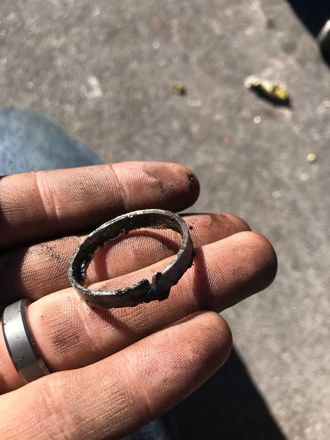

So 4 hours later, my coolant leak has been solved. It did not take much to break the plug out, was beyond rusted. The only issue that happened was the outer ring left by the plug. With the engine still there, on the cylinder head, drivers side back of the block it was not easy at all to get it completely off. I have taken photos.
So yes, it is possible to replace the freeze plug on the cylinder head/back on the drivers side without pulling the engine. Honestly the only thing we took out was the tire and wheel well, literally nothing else we moved. I have attached photos that I hope work on here. The guy who did this only charged me $120.

Yep. That should work. The trick with those plugs is to make sure they are good and TIGHT. (not to mention a clean hole to put it in......) Did you pressure test it after the install?

Didn’t have a pressure tester on hand and I’m flat broke for now so I can’t rent one either. What I did was let it idle for an hour straight, burp the system out while doing so. Drove it for about 10 minutes and just parked it. It’s still dry as a bone on this spot. So I’m crossing my fingers it doesn’t pop out or something lol. Yeah the biggest pain was making sure the hole was completely clean and smooth.
