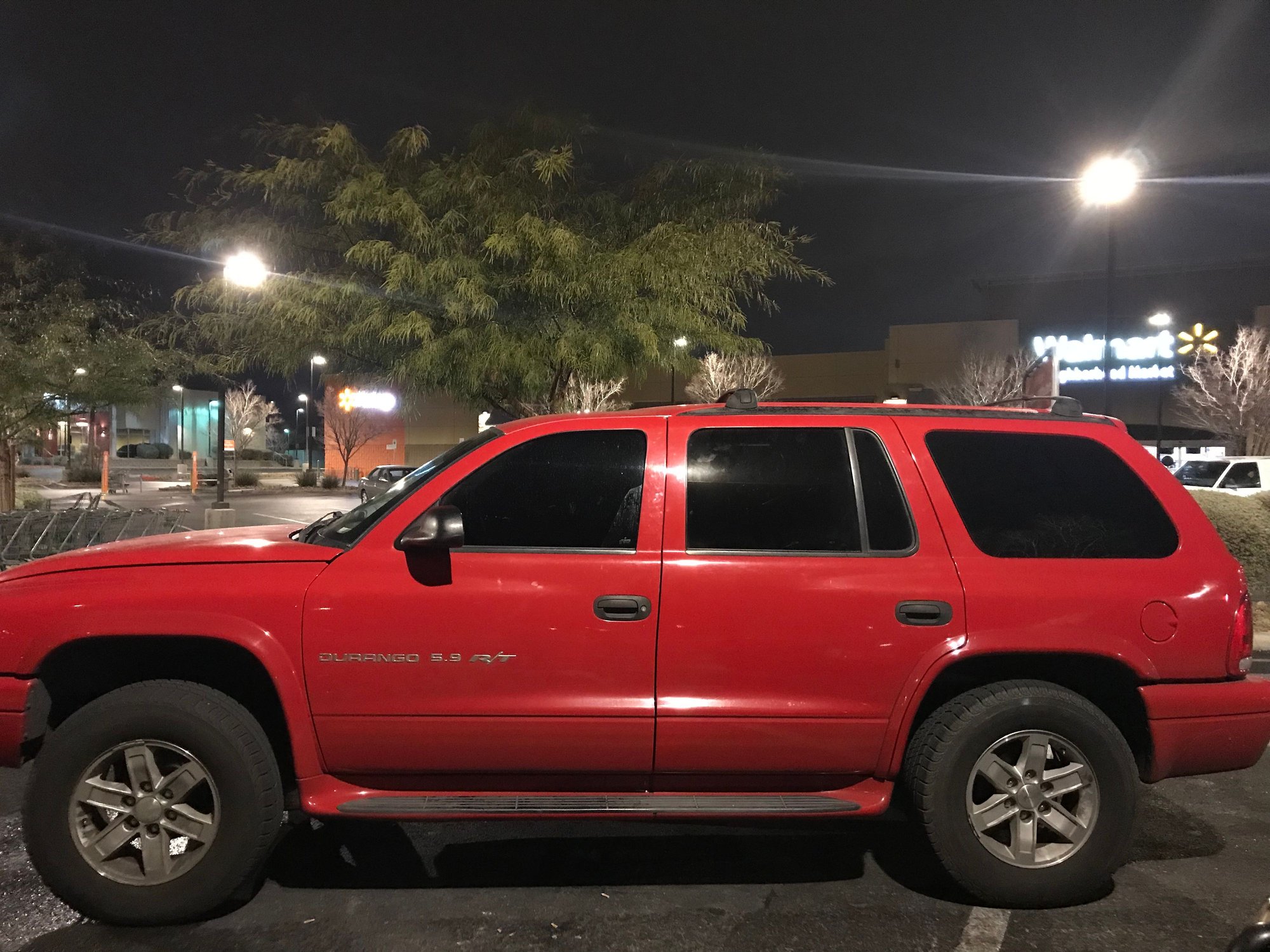

So I ran into an issue, it’s a long story that I won’t get into. What’s done is done but what is everyone’s opinion on wheel adapters for the ones who have used them. I ended up putting on Chevy wheels on the Dodge yesterday. I heard from someone that they eventually start to loose up.
