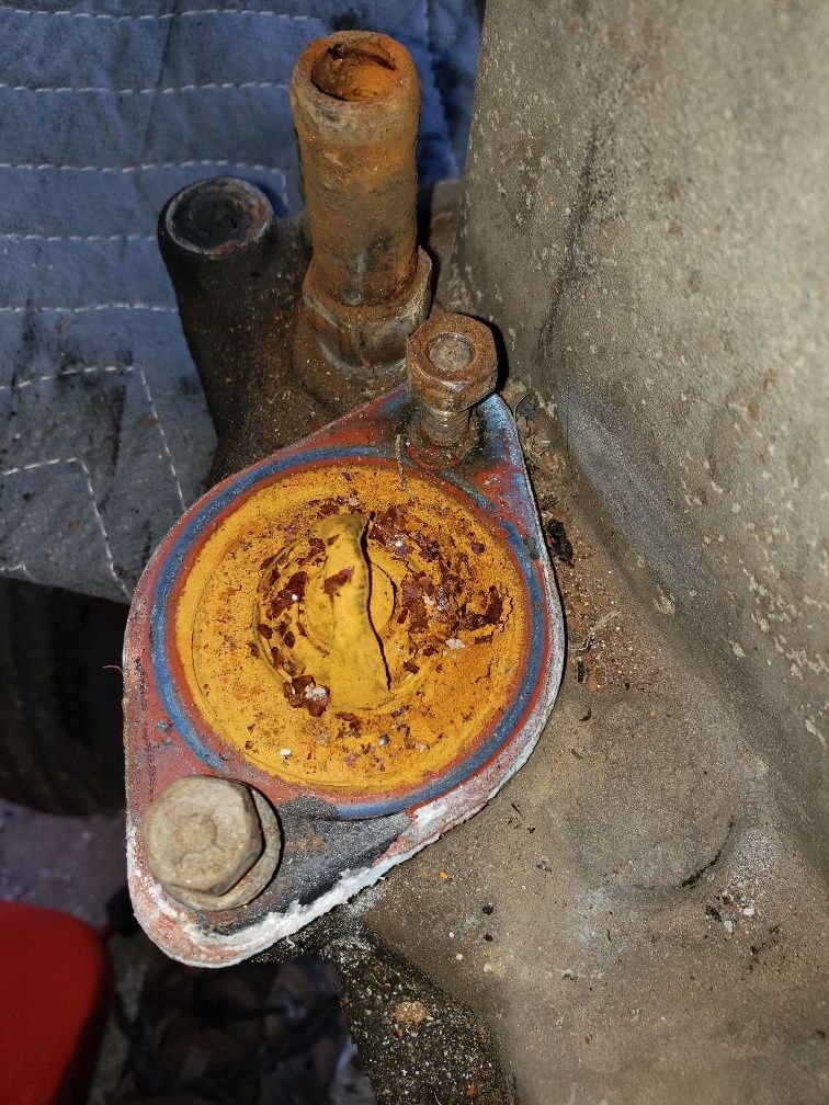

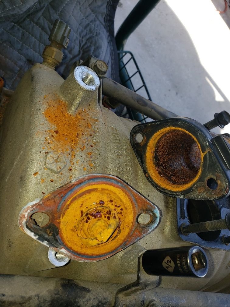

Finally got around to removing the intake manifold on the donor 5.9l engine...
Thermostat in the intake manifold of the donor engine
The pile of rust on the intake manifold is what came of the TOP of the thermostat
This is why I wanted to go through this engine before swapping it in...Now I'm thinking that I'm going to have to have the block boiled out or something to get the rust cleaned out.

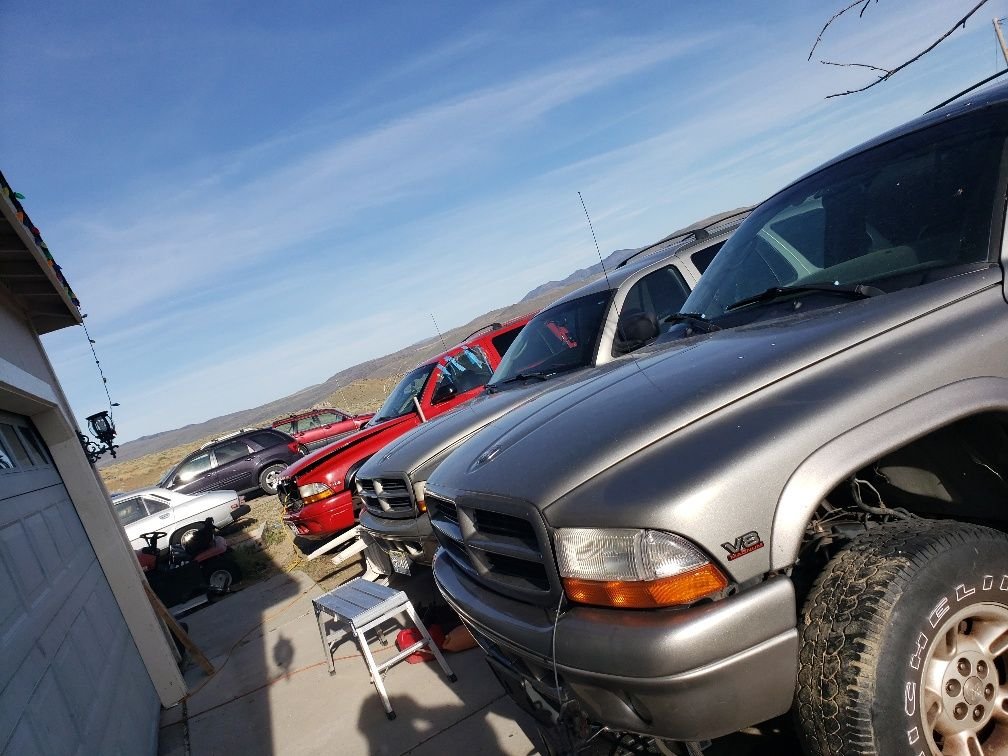

Also, here is a quick pic of the "fleet" of Durango's I have
Closest Durango is the '00 one for my son...the middle one is the 4.7l '01 (wife's) and the far one is the 2wd donor for the '00
My baby, Demon Red...This is the one I just finished rebuilding the top end of the 4.7 ...We call her the demon because she did try and squish me and the license begins with 666
